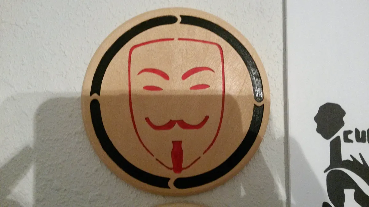

Setup and Carve
open in easel and make sure all your settings are correct
Easel setup:
When you open this in easel please make sure and check all your settings as mine may not work for you
Roughing Pass:
Saftey Height: .150" Step over: 40% Feedrate: 45 in/min Depth of cut per pass: .0625" Depth of total cut: .050" material thickness: .25" Material type: Birch Plywood Bit Size: .125" Bit Type: solid carbide 2 Flute straight flat end mill
Detail Pass:
Saftey Height: .150" Step over: 40% Feedrate: 15 in/min Depth of cut per pass: .015625" Depth of total cut: .050" material thickness: .25" Material type: Birch Plywood Bit Size: .03125" Bit Type: solid carbide 2 Flute upcut flat end mill
It might save a little time if you do a roughing pass with an .125" bit and then go back and do a detail pass with a .03125" bit I will provide a roughing Gcode file and Detail Gcode file above make sure and have this feature turned on in easel by asking for access in this thread on the Inventables forum with the link below
https://discuss.inventables.com/t/two-stage-cuts/869/582
I hope you enjoy this simple project if you have any questions just let me know
