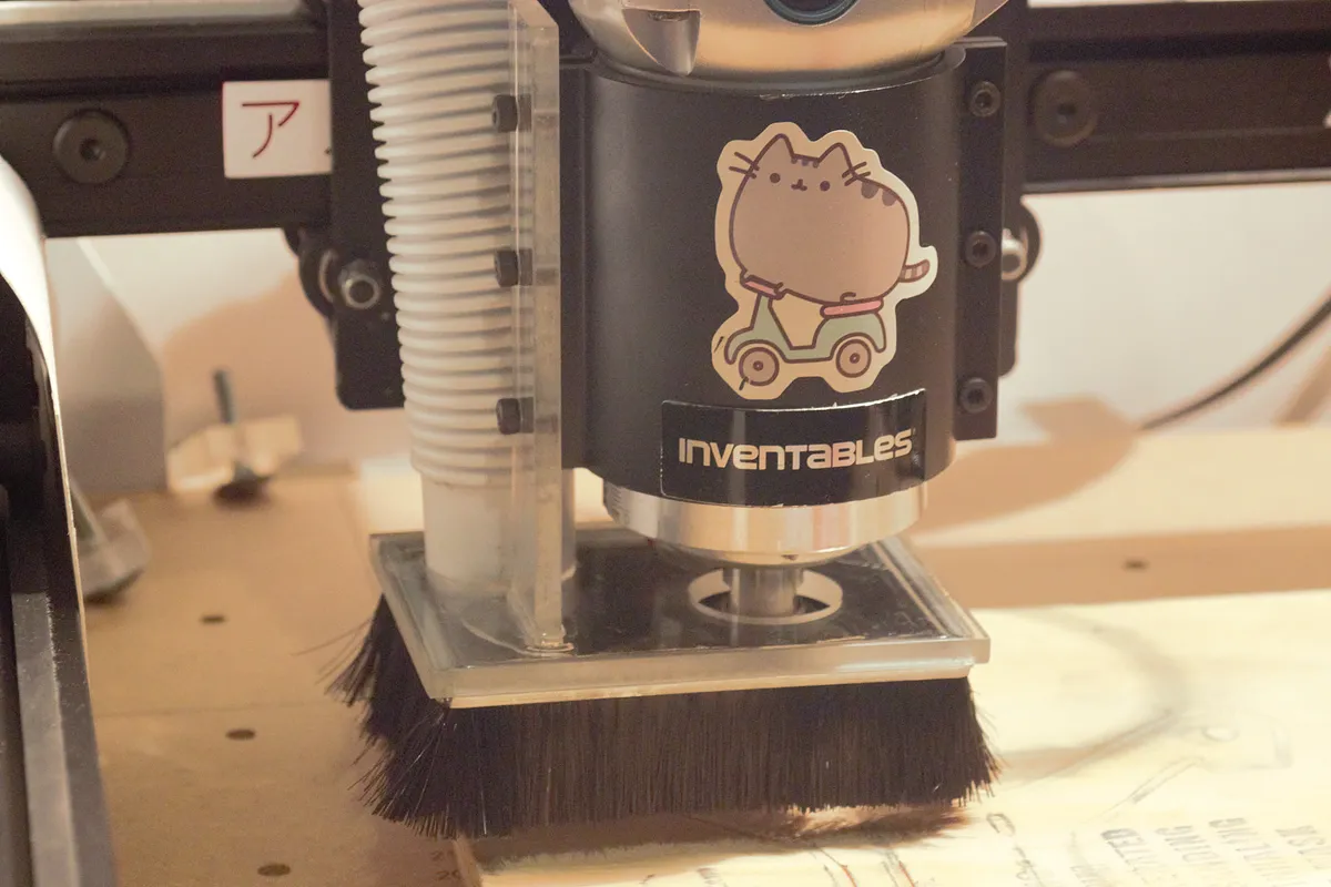

Assemble the parts

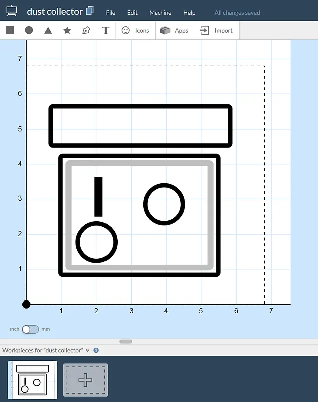

The mounting strip needs the bolt holes drilled out, I left them out so you can choose your own mounting height or you can even just mill a slot. The brushes need to be cut to length and epoxied in place, I recommend a dab of superglue to hold them in place while the epoxy sets. Mark the location of your bolt holes and drill them out, and epoxy the strip into the boot.
This looks so simple - i'd like to try it. wish there were a coupla more pics, though. i'd like to have a look @ the bottom. it's worth trying out if just to get something there It'll be something to have there if i need to come up w/a better plan. thanks from Russ in Coral Springs, Fl, USA

You can see the bottom in the easel drawing, there isn't much more to show, it's just a single flat plate with 2 holes and a mounting slot. The mount is just epoxied in the slot, and there is a shallow slot cut that the brushes fit in.
Emily · June 09, 2017
