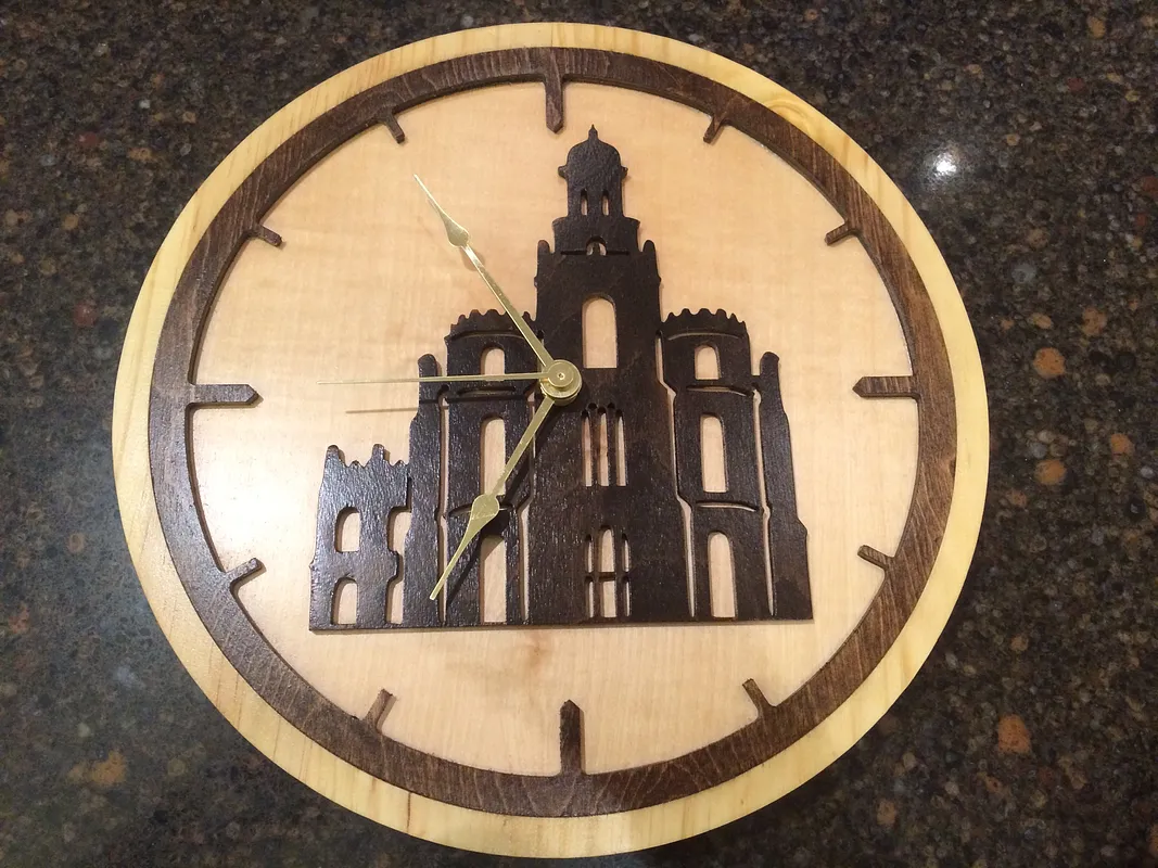

Cut silhouette & number marker ring
First cut out the silhouette and number ring from the 3/16" plywood using a 1/16" bit. You may consider reversing the image and cutting the pattern from the back side as the upcut bit can chip the plywood on some of the more delecate areas.
Estimated time: 45 minutes
Stain the silhouette & number marker ring
This step is optional, but dark stain gives the piece a nice contrast between the lighter background wood.
Estimated time: 15 minutes
Cut the back and outer ring
Cut the back from the 7/16" birch plywood. You can use the outer circle from the easel project associated with this post. Make sure you cut on the outside of the circle so that everything lines up to the right sizes.
Next cut the outer ring from the 3/4" pine. This time use the circle from the previous step but make sure you cut on the inside of that ring. Also add a slightly larger circle to the outside to give you the desired thickness of this ring.
Glue it all together
I used CA glue to first glue the silhouette to the back. Once that was set, I slightly sanded the ouside edge to make sure everything was flush and then using wood glue I glued the outer ring to the base making sure the front face of the clock is flush.
Finish with lacquer
Apply 3 coats of lacquer following the insturctions provided by whatever brand of lacquer you are using. Allow to dry thoroughly before moving on to the next step.
Estimated time: 60 minutes
Install the clock works
I purchased clock works from the local Hobby Lobby. The shaft needs to be at least 1" to fit through the clock base. You may also need to ream the center hole depending on the shaft diameter of the clock works you are using. I also purchased larger clock hands, I think they were 4 1/2".
Hang the clock for all to admire!
