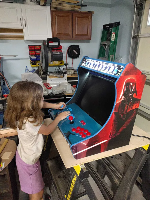

There is a lot of parts and build into this, but for me it was well worth it. Playing some of my old time favorite video games has been a blast, see my kids expressions when I play some of these old games is priceless. Each workpiece has notes in regards to the individual pieces and their use/locations. I also opted to use 8 buttons for each controller, however you can adjust to fit your preferences. Here are some options: http://www.slagcoin.com/joystick/layout.html I used the fourth one down.
Also, note that I built this first, made a template and marked where all the tack strips went. They may not be 100% accurate, I am planning to build a second unit in the near future for a friend. I'll make additional updates then if necessary, and add lots more pictures of the build.

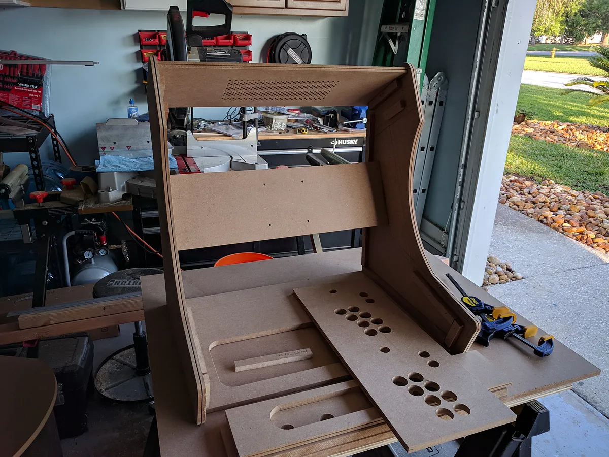

Carving more workpieces
Carve the Bottom, Marquee back workpiece, and the back and top workpiece. Some of these pieces are slightly oversized as I cut angles using a table saw so they fit nicely together.
Carve the Front, button, speaker and monitor mount workpiece.
If you plan to use T-molding, use a router and the slotting cutter to cut the front of the top piece, the front of the speaker/lower marquee piece and the front of the joystick/buttons piece.
Dry fit and find angles for table saw trimming
Dry fit the bottom and back to the sides. Then use an angle finder to find the angles to trim these pieces on a table saw. The bottom piece will be trimmed on both sides, the back on both sides, the top only towards the back, and the vertical front lower piece (with 4 button holes) gets trimmed on both sides.

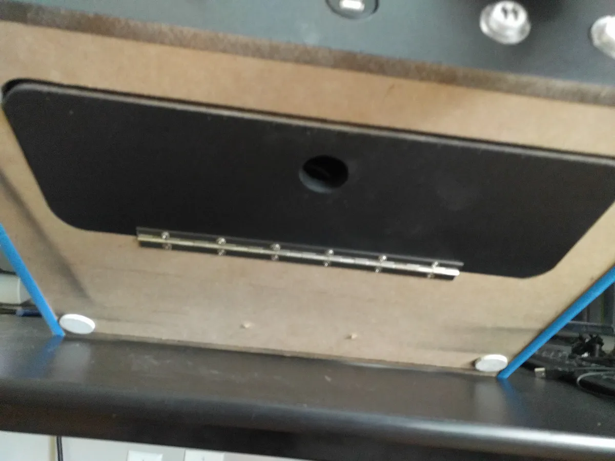

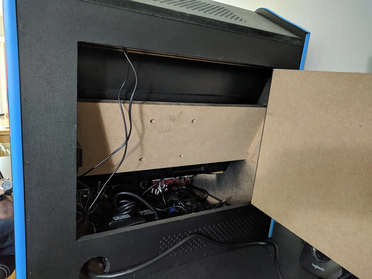

Attach the bottom access panel and rear access panel using the piano hinges. I used the cheap magnet holders to keep them closed. ($.78 from big box store)

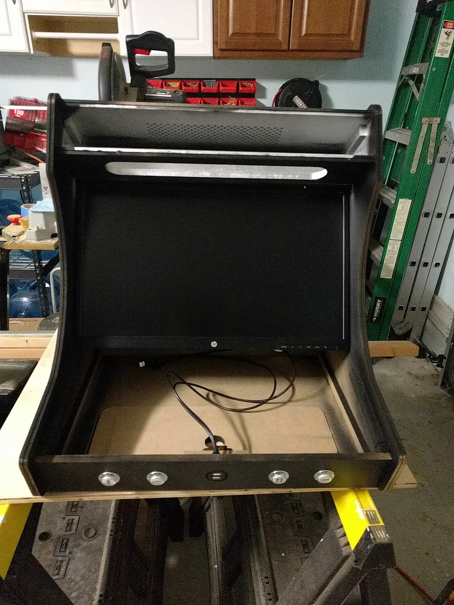

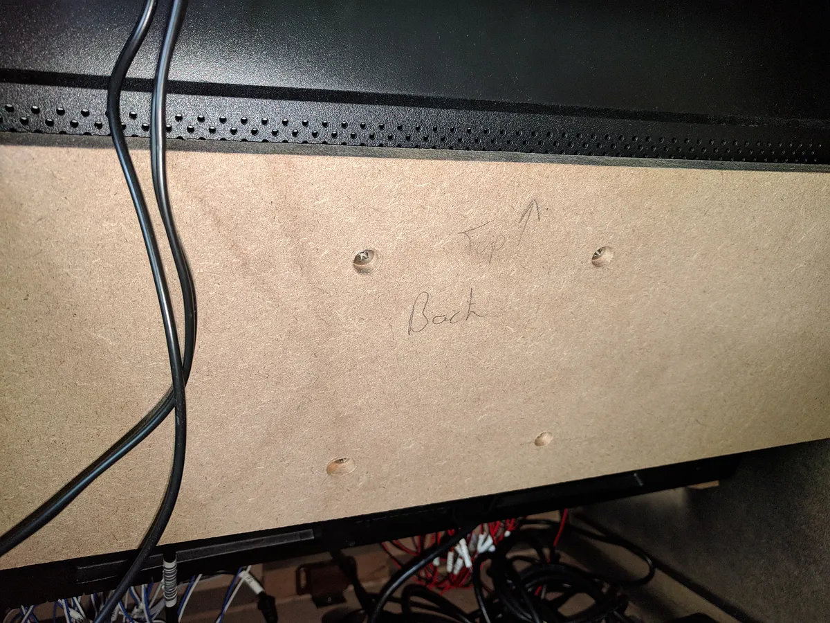

Monitor Mount Board
Before you nail the monitor mount board, attach the piece to the monitor VESA holes and dry fit to find the correct location. Monitor should be touching the top of the unit. Mark the location from the back on the monitor mount board, remove the monitor, then nail in the board.

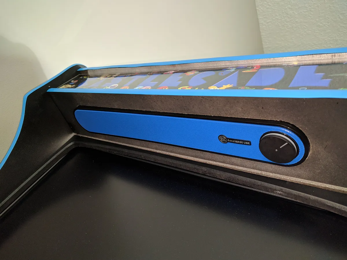

Drop in the USB soundbar and run the wires through the hole in the back marquee board.

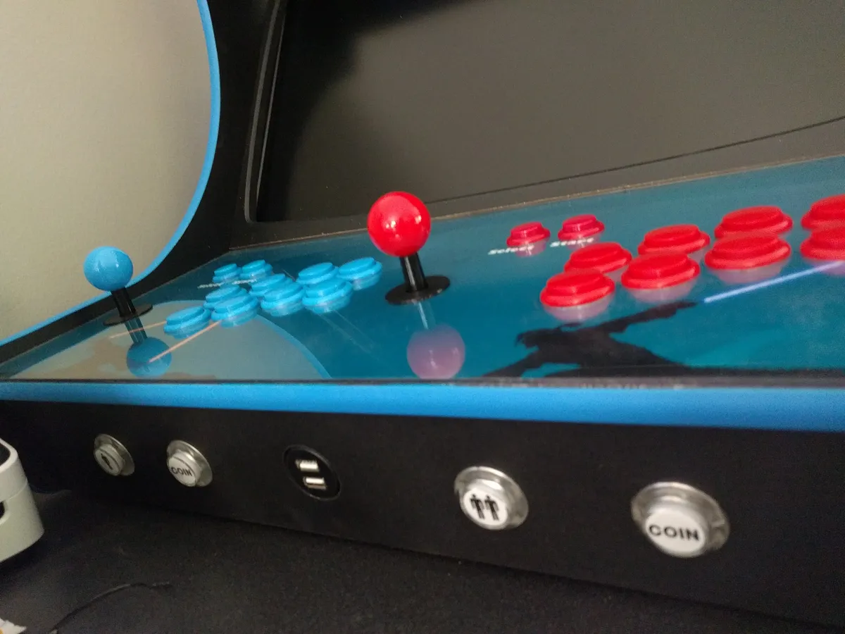

Sandwich the wood button piece, the overlay printout and the button plexi. Then insert the buttons to hold the pieces together. I also attached the joysticks to the wood piece from the bottom using #8 x 3/8" screws.

Tilt the unit onto it's back, open the bottom access panel, and slide the button panel in place from the front. I marked the left and right side along the backer strips (attached to the side panels). I then cut 2 short 3/4" pieces of MDF and glued/nailed to the bottom of the button board. This allows the button panel to be installed and held in place, but allows it to be removed in the event of disconnects or button/joystick replacement.

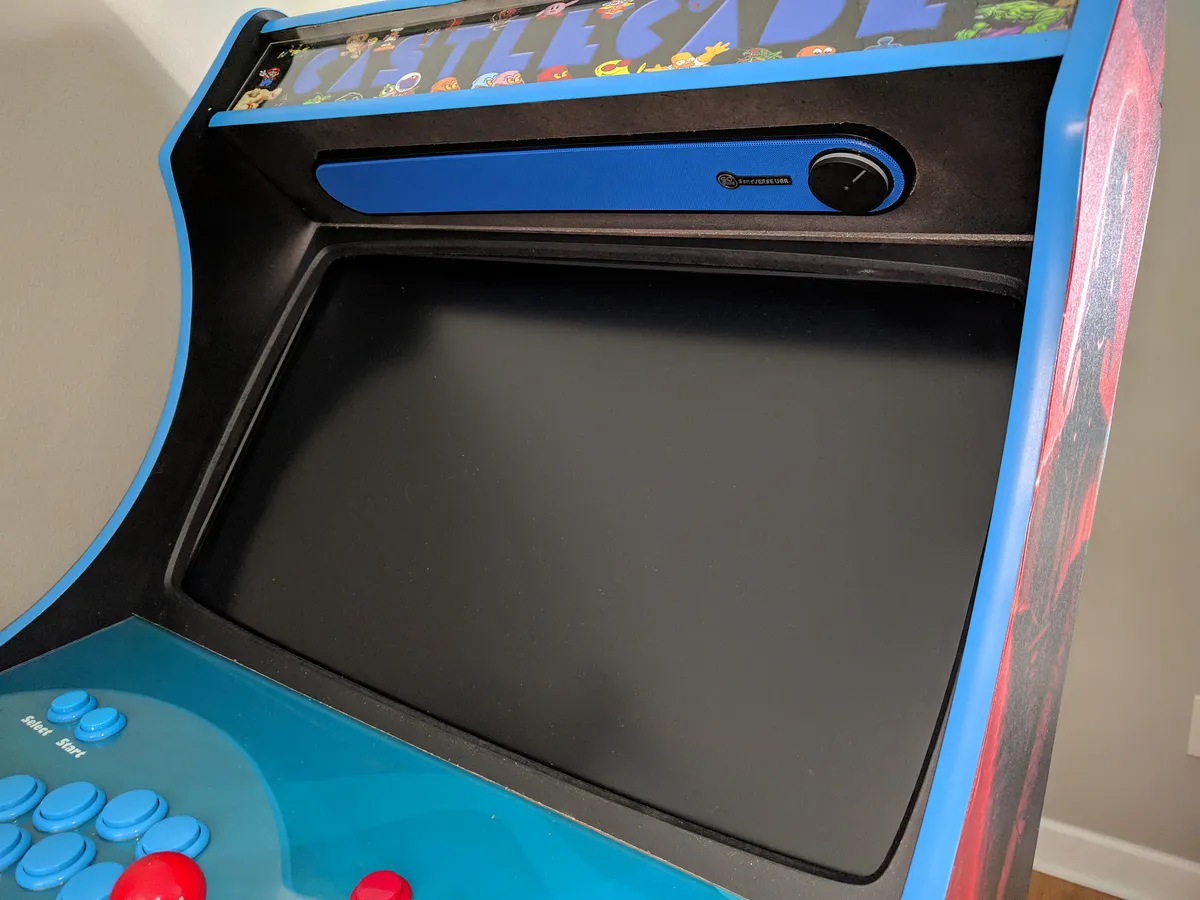

Once you have it in place, measure the distance from the joystick board to the top of the monitor. Carve out the monitor overlay workpiece, paint it black and trim 1/4" larger than your measurement. Then angle cut 1/4" deep to match the joystick board angle. This trims it halfway into the board and allows it to be held by the notch.

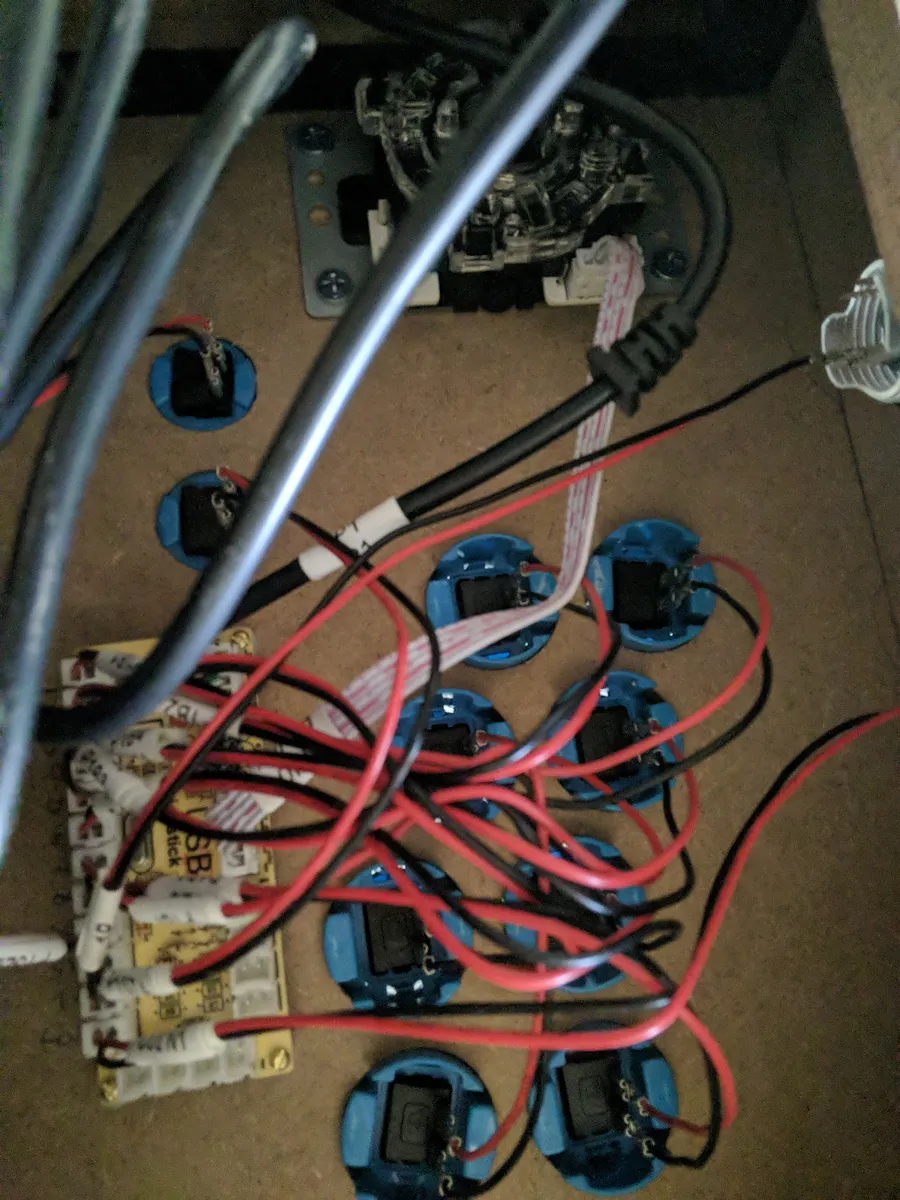

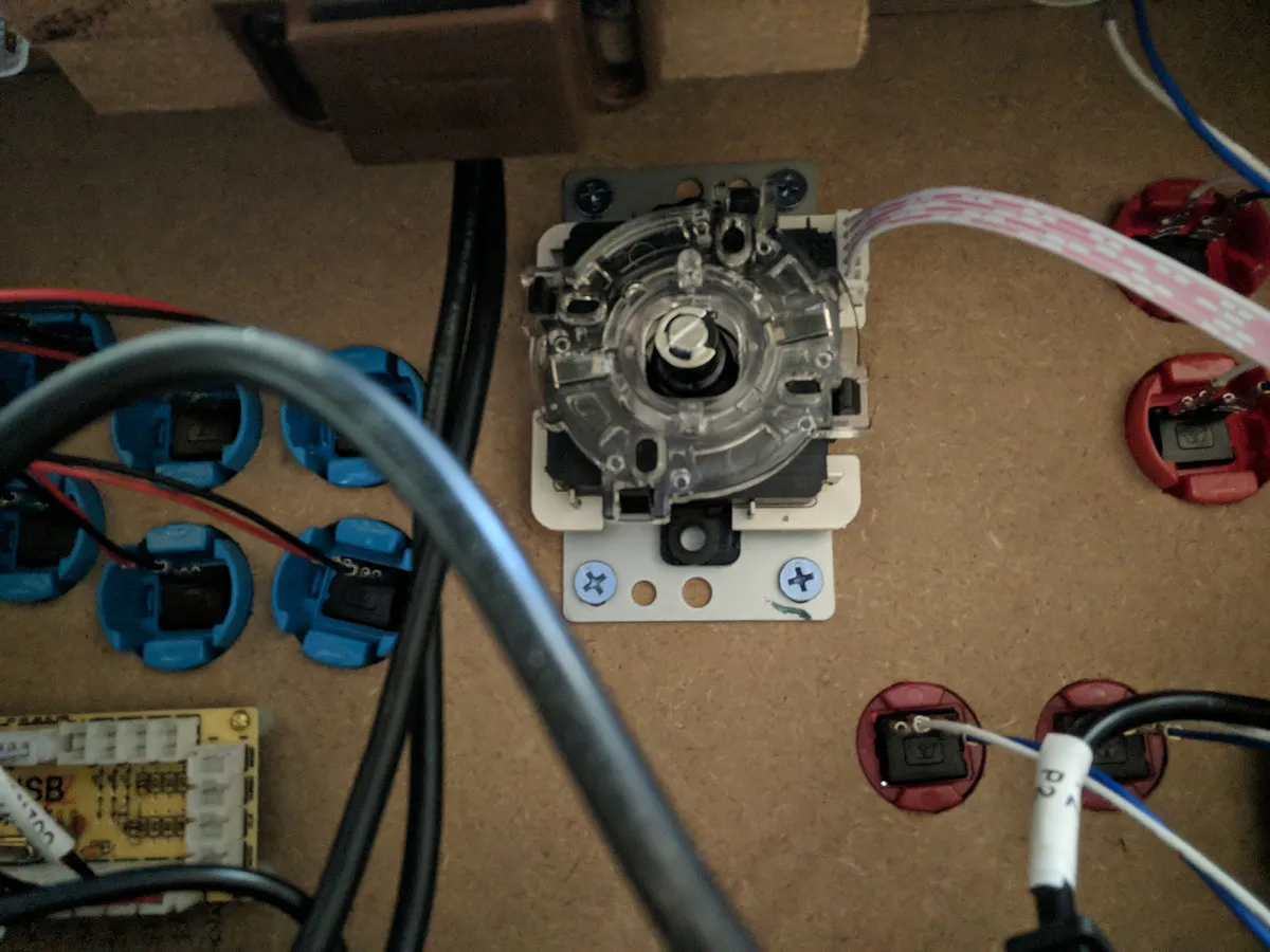

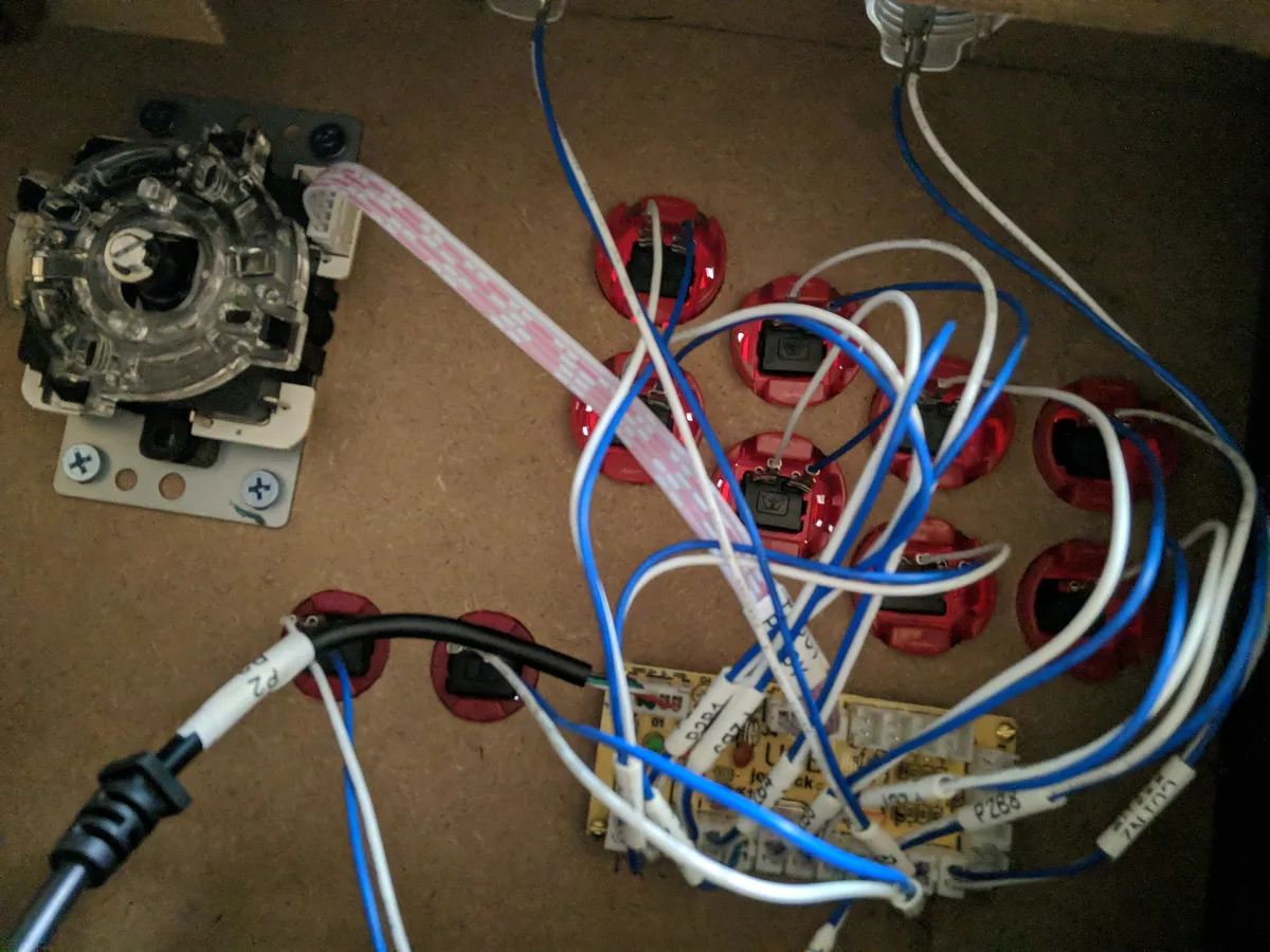

Mount USB button board and wire up
With the button panel back out, I attached the USB button boards to the back of the button panel. I used short nylon spacers and very small screws. Then, wire up each button and the USB wire to the button controllers.

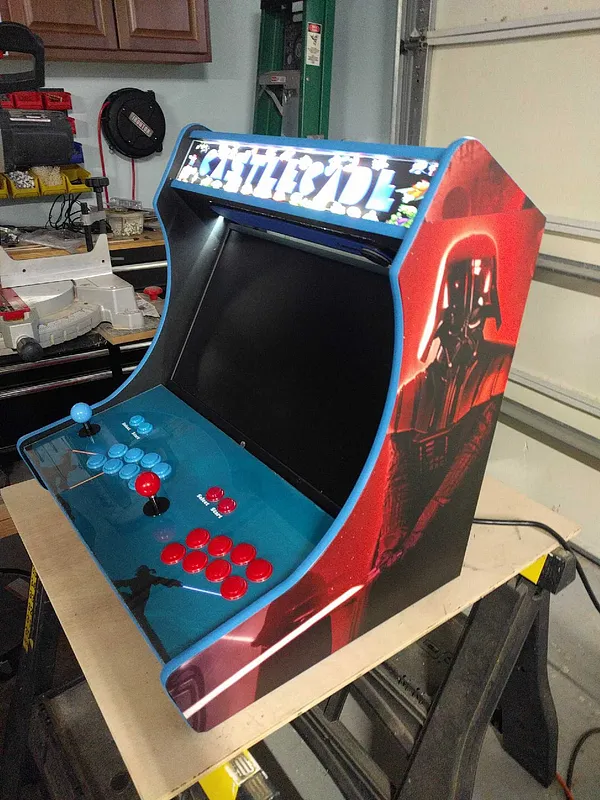

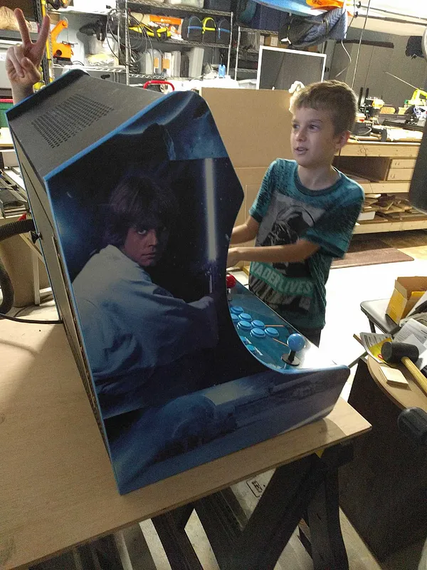

Side Graphics
Attach the vinyl stickers to the sides. I added about 1/4" to each side as I cut it out. This allowed me to fold the graphic over the sides. I did have to make a few relief cuts on the sharper curves/angles.

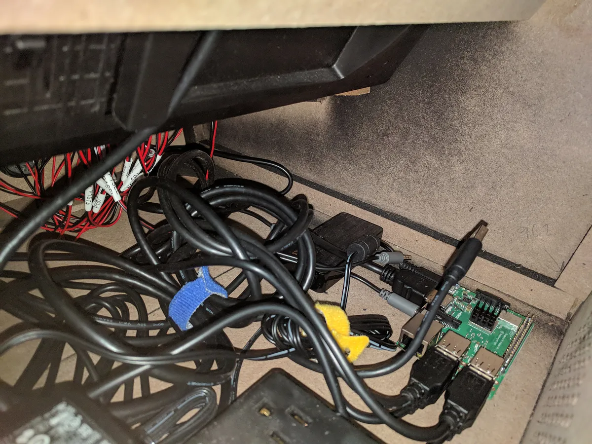

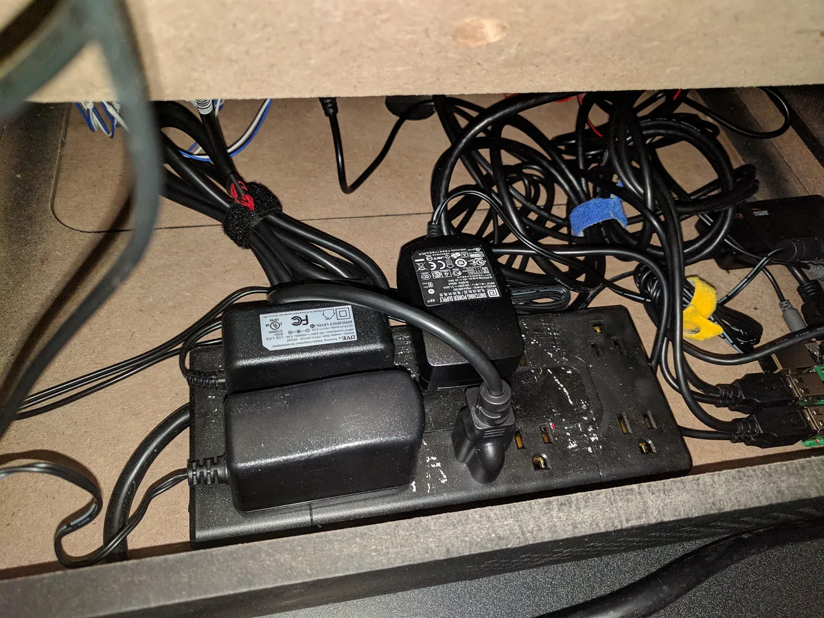

Mount Raspberry Pi and attach power strip
Mount the power strip and Raspberry Pi. Once again, I used short nylon spacers and small screws for the Raspberry Pi..
Connect USB cables and power
Connect the USB cables from the joysticks (and front panel mount if you used it) to the Raspberry Pi.
Connect up power to the Raspberry Pi and LED lights.

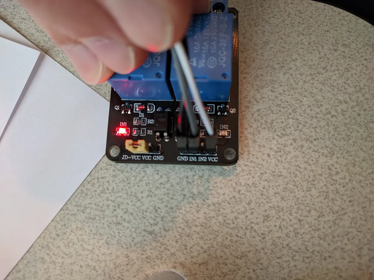

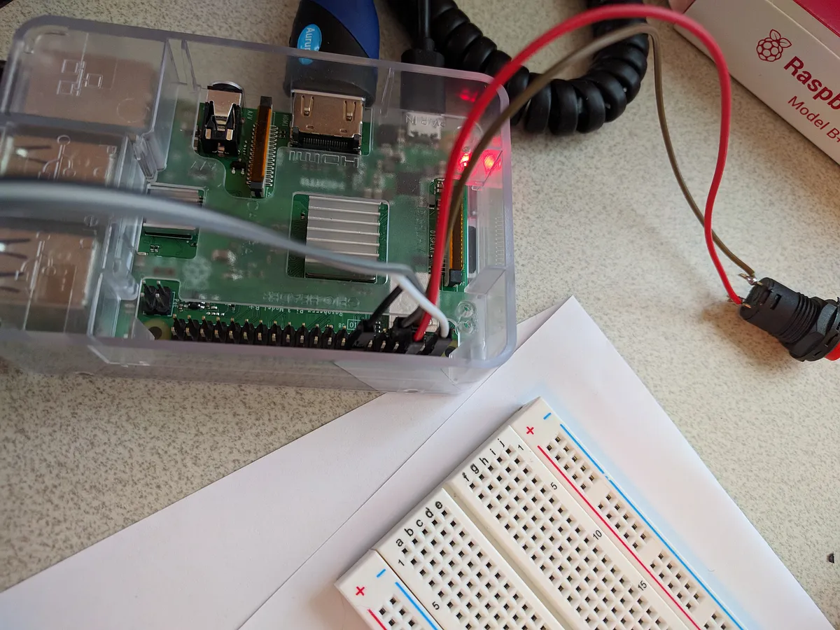

Stay Tuned - for power switch and Pi relays
I'm currently finalizing the tasks necessary to connect the power switch for graceful shutdown/power on, as well as a relay for turning on the marquee during the retropie boot up. I'll post these instructions in the near future.

Thanks! I made it for a 23.8" screen, the HP v244a specifically. You can find a link to it in the project description.

Patrick Myers · March 29, 2019
To access the wiring on the joystick panel, there is a cut-out panel on the bottom of the unit (first item in easel). I attached this with a piano hinge.

howchoo.com has a nice tutorial for how to setup the power button...seems to work nicely for me
Ryan Lucas · March 20, 2022
