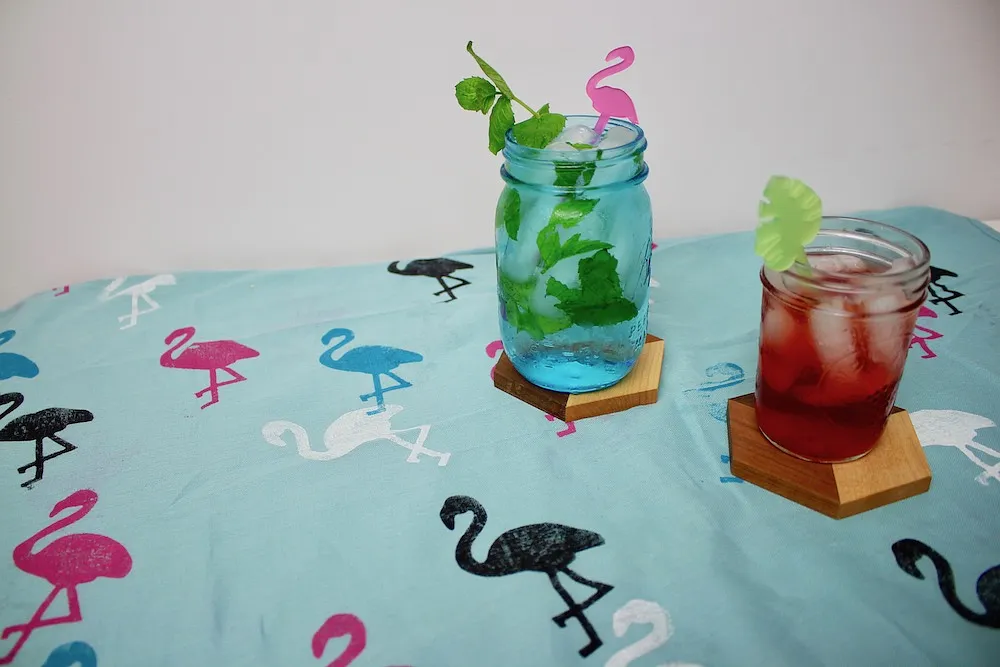

Stamp your project
I use Speedball fabric block printing ink and rubber brayers (rollers) to apply ink to linoleum stamps. These products have worked great for me time and time again. In this case, I stamped some tea towels, but I've used these fabric inks on koozies and t-shirts. too.
Happy stamping!
