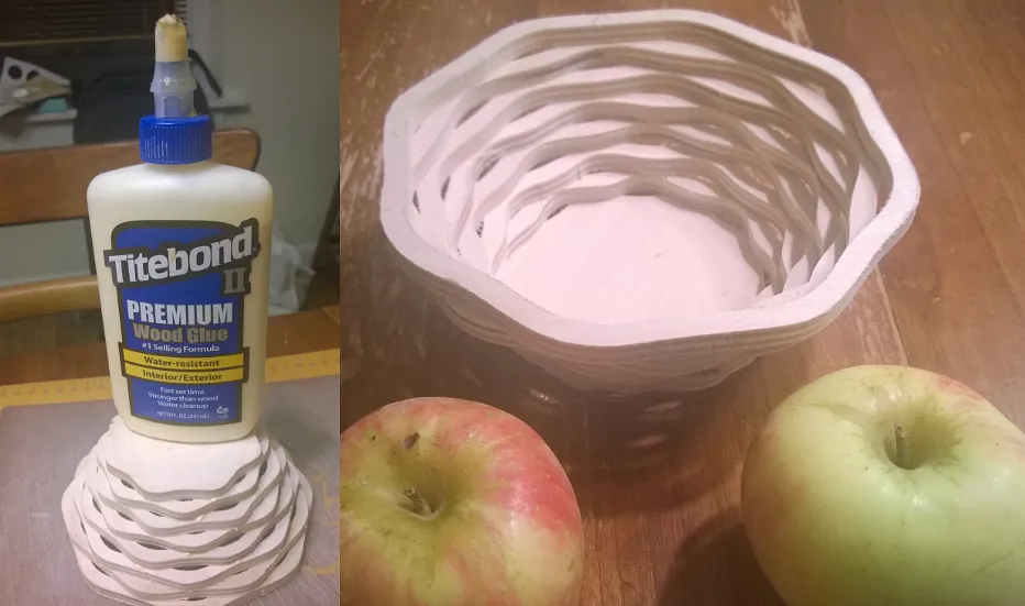

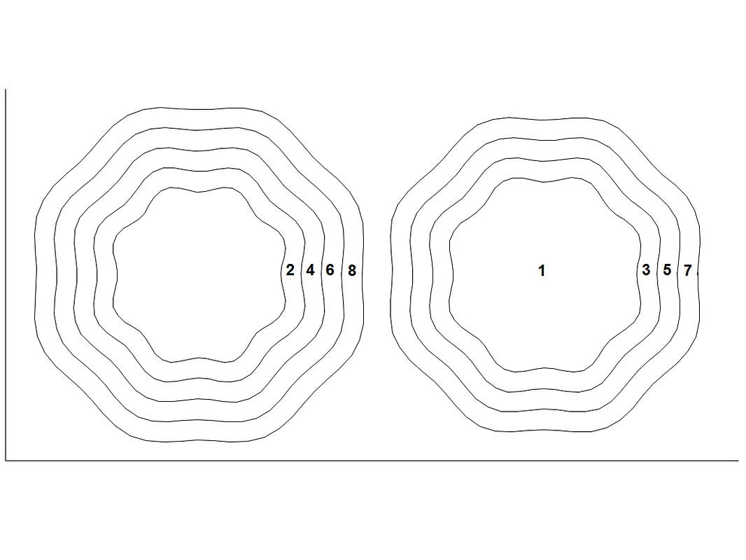

Order of assembly
The rings will need to be glued in a stack. The order of rings is shown in the picture. Start with 1 and glue 2 on top and so on. Each layer should be slightly twisted with regard to the layer below it so that the outer bumps of the lower ring support the inner bumps of the ring above it.
