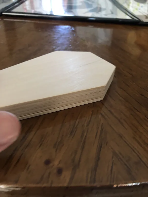

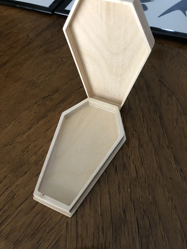

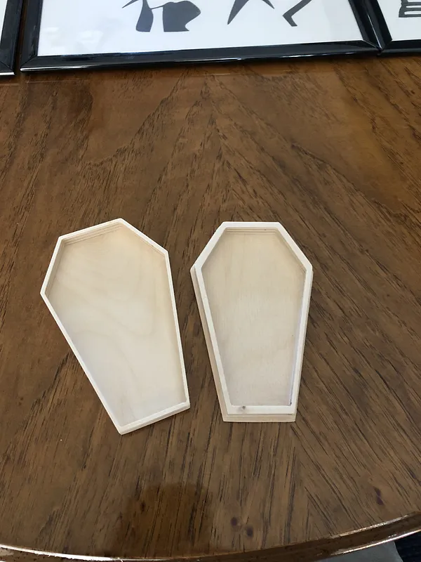

* PLEASE READ BEFORE MODIFYING *
These will not fit together properly is modified. They have to be remade with a specific formula. If you try to resize them, even if you resize them together the exact same in every way, they will not fit together properly. Also, YOU HAVE TO USE AN 8TH IN BIT WHEN YOU CUT THEM. The formula I create to make these was made using the measurement when cut with an 8th in bit. This is because some paths are cut outside, some are on path and these paths with the bit size determines the wall thickness and placement. I haven't tried resizing them and then cutting them, but I have to imagine that since everything is changing and the bit size remains the same, then I have to assume the wall thickness and placement must also change.
