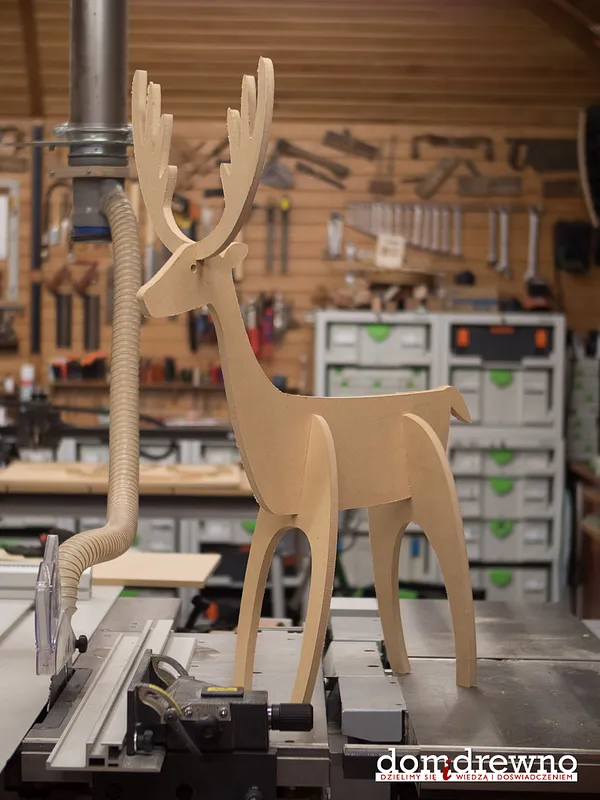

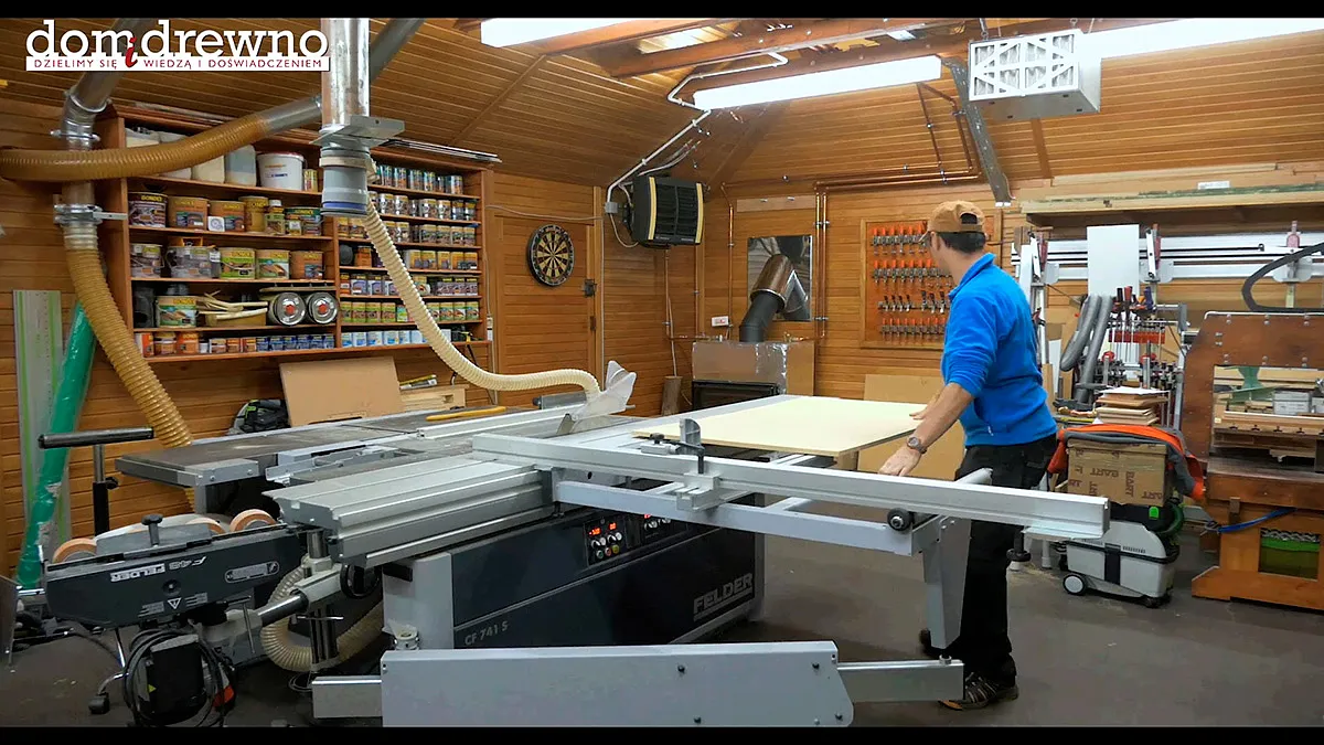

Formatting MDF on the table saw
Easy part ;)

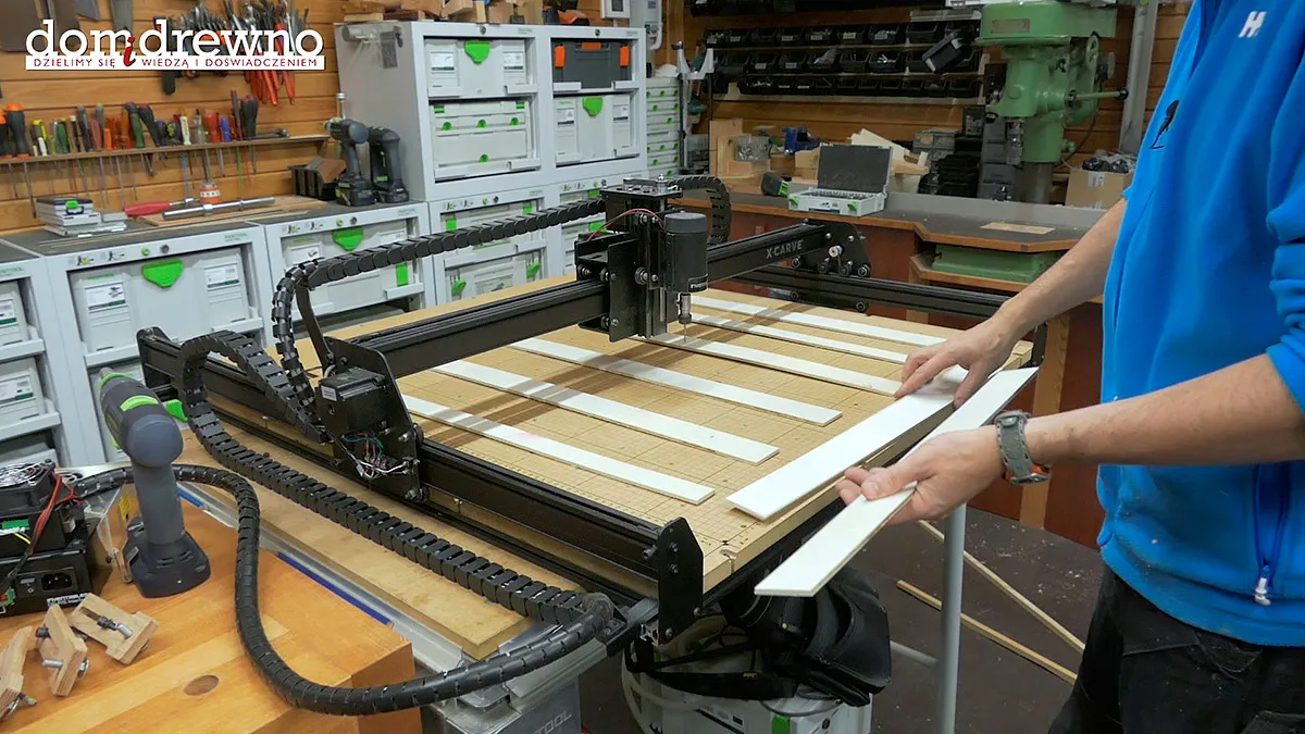

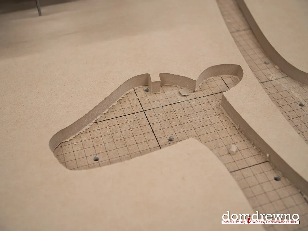

Preparing thin material under MDF
Couple shims 5mm to safe the main table
Estimated time: 3 minutes

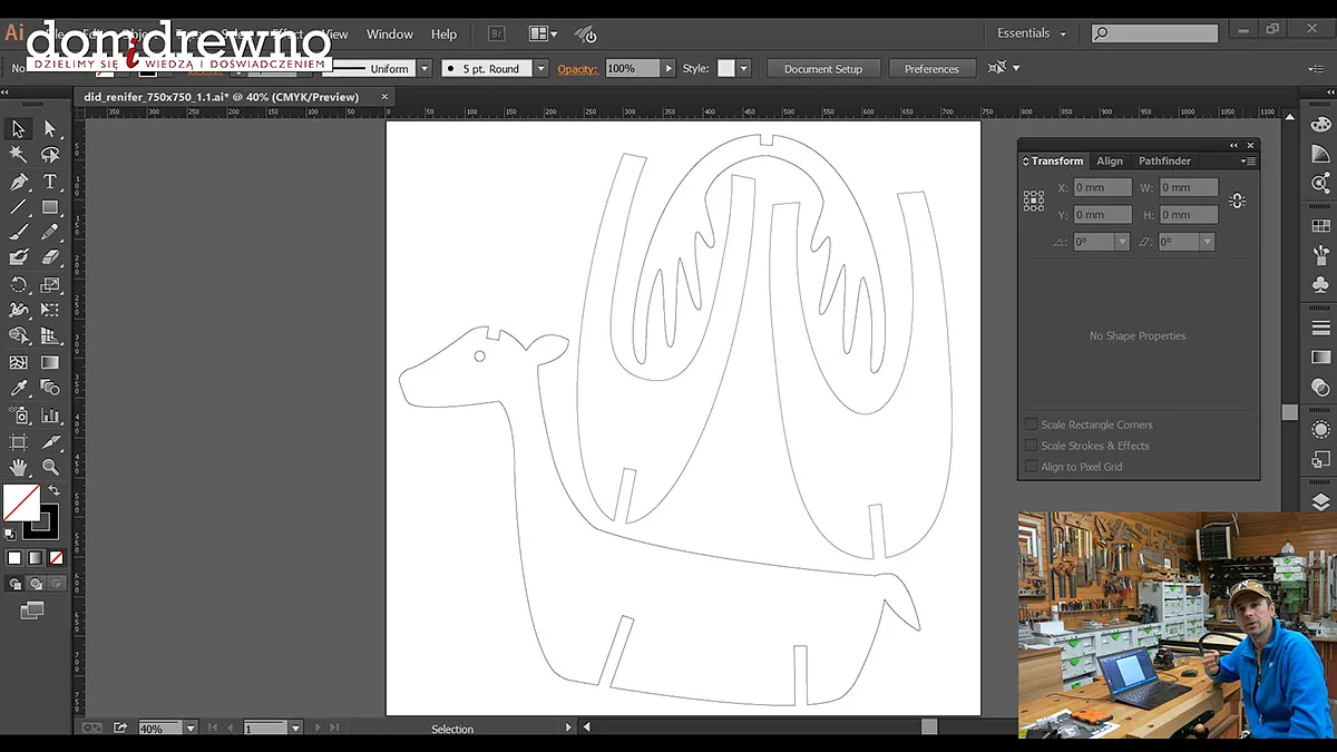

Preparing project on Adobe Illustrator

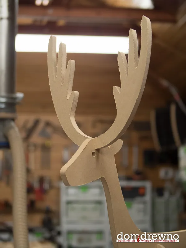

I need to finish joints - cut 16mm on all elements.
Estimated time: 5 minutes

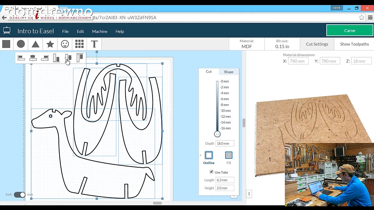

Work on Easel soft

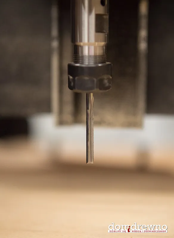

Import SVG and setup MDF, 3mm bit.

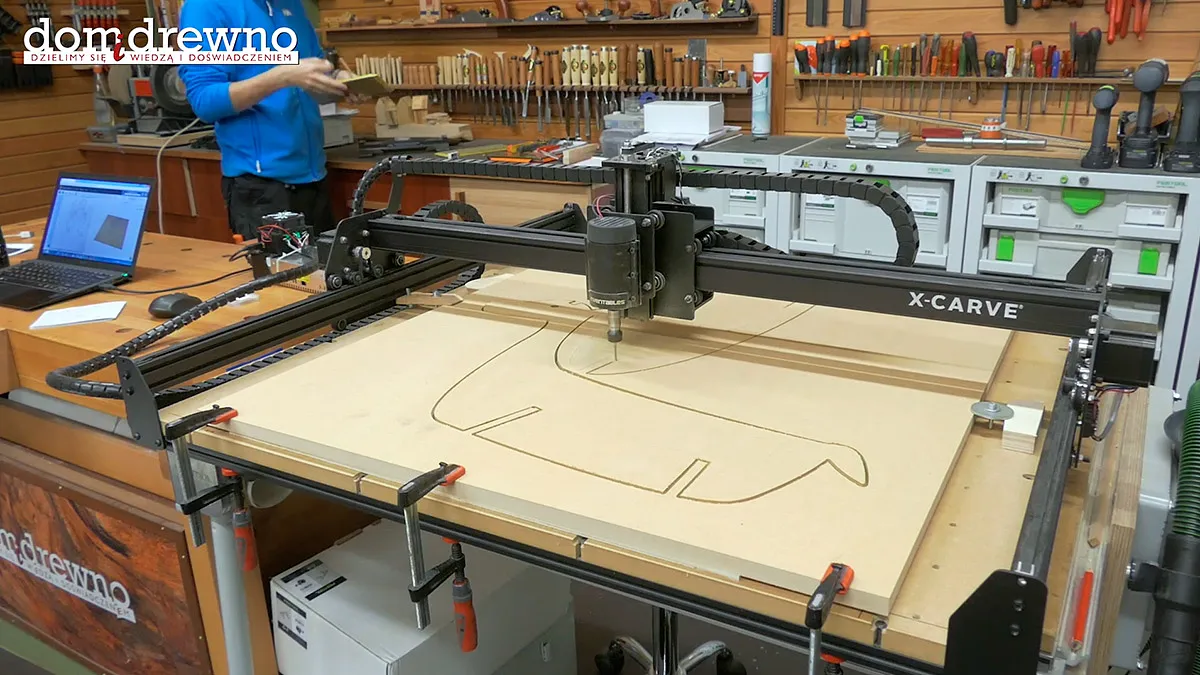

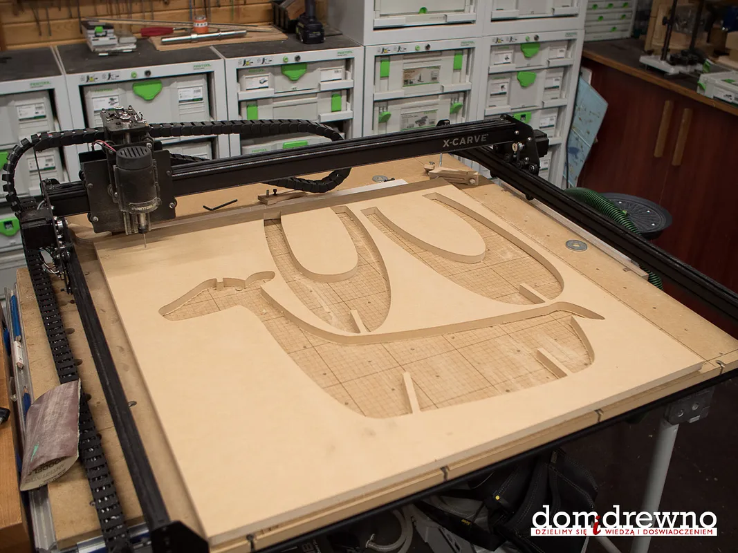

Cutting MDF on X-Carve
Waiting fot final resoults :)
Estimated time: 120 minutes
