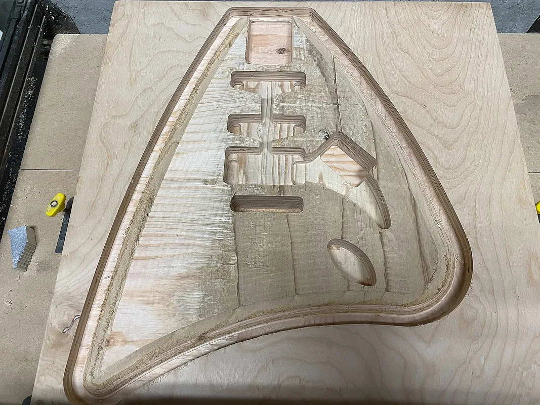

Clamp the stock so that the reference hole is in the near left corner (0x0). For all steps align the tool with this hole.
Using a 2" 3/8" Straight Bit carve 1001 and 1002. You may find that you have to shift the router up a little, and may still not have space to use the probe. This project is right on the limits of the X Carve.
Switch to a 1/8th Straight Bit, again aligning with the reference hole, and carve 1003.
Setup complete.
Estimated time: 90 minutes
Setup 2
Flip the stock so that the reference hole is in the near right corner. For all steps align the tool with this hole. It is easier to do this whilst the 1/8th bit from the previous step is still in the router.
Using a 1" facing mill carve 1004.
Switch to the 3/8th" straight bit and carve 1005.
Finally, switch to the 1/8th bit for finishing and carve 1006.
