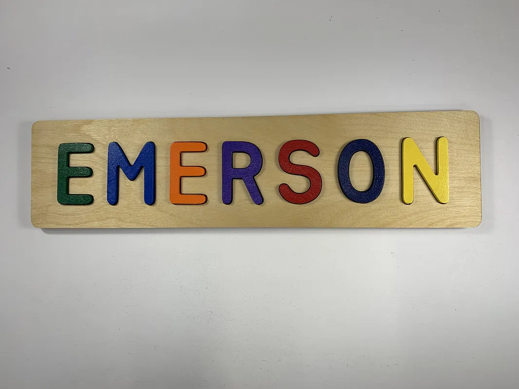

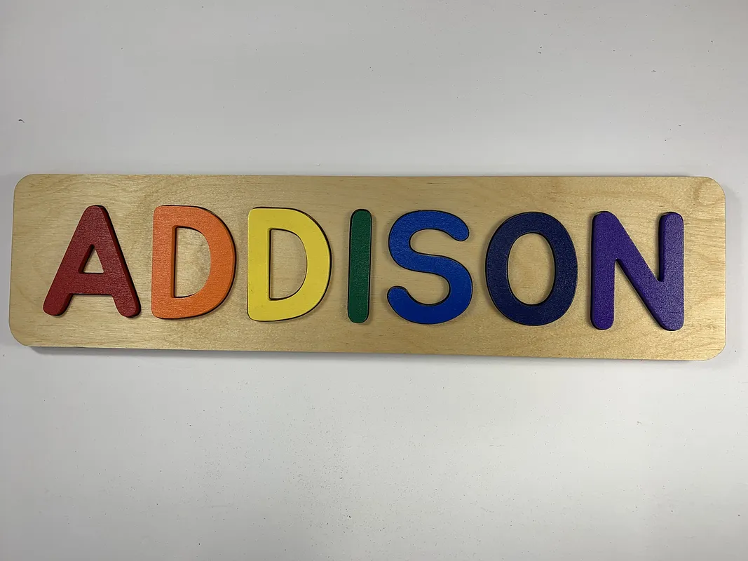

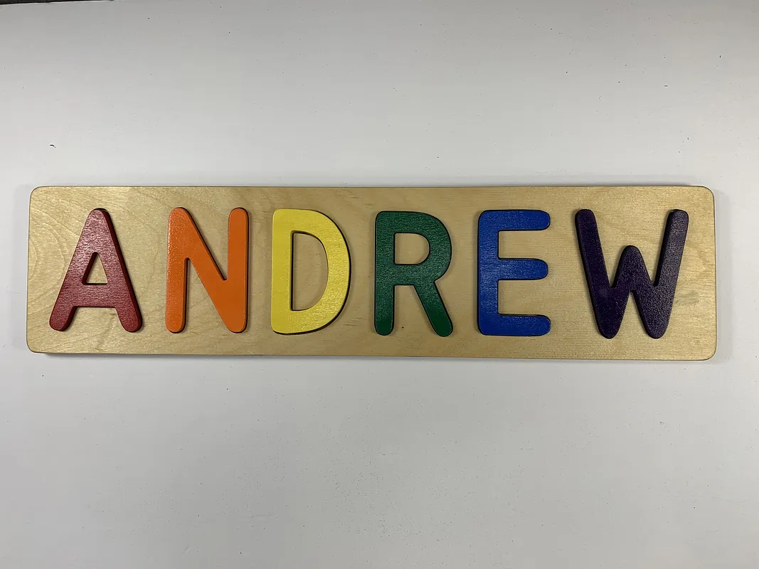

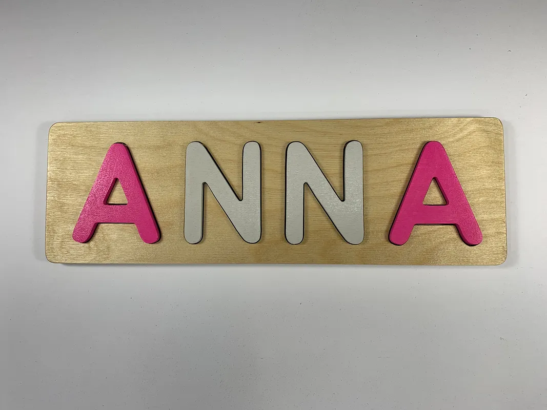

Using the Xploder and inlay app in Easel, making a name puzzle is super easy.
Puzzles are made from 1/2" baltic birch ply and then painted with craft acrylic in rainbow order when there are 7 letters. Final protective coat is shellac and a good coat of bee's wax. All very kid friendly.
