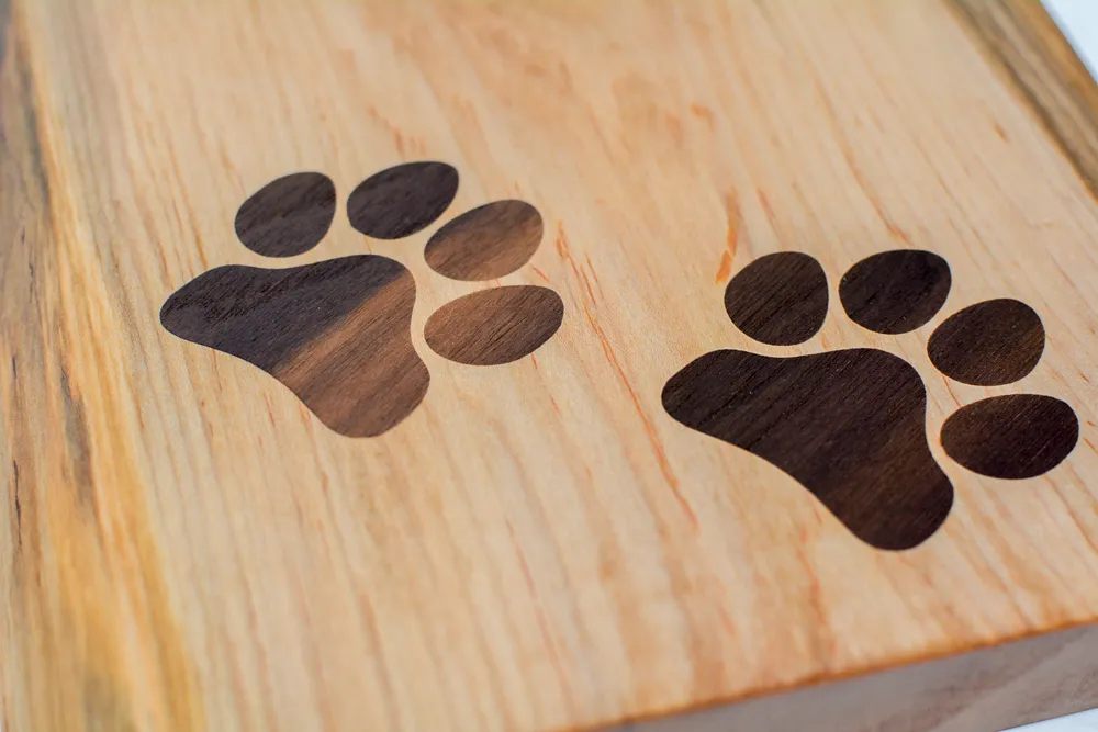

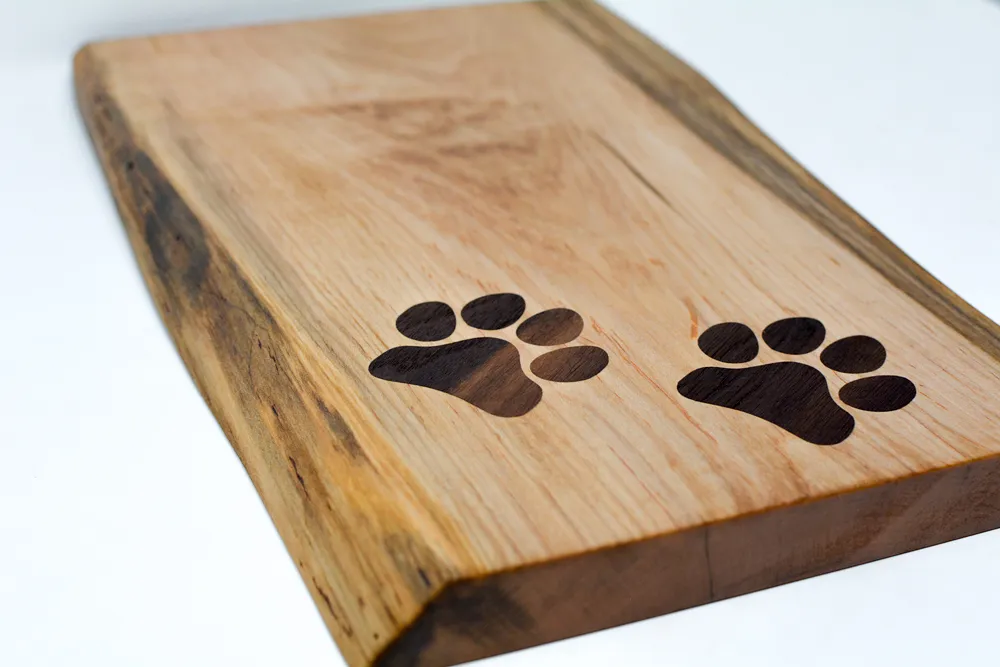

Inlay of a Paw Prints using a 1/16" bit.
All tool paths have been changed on the original picture to make the edges smoother and to accommodate the tight corners to allow the bit size.
x-carve 2016
Walnut
What is the offset setting on these?
Derek ShoemakePro · December 28, 2017
I use a .0015" Tolerance with a 1/16" bit
