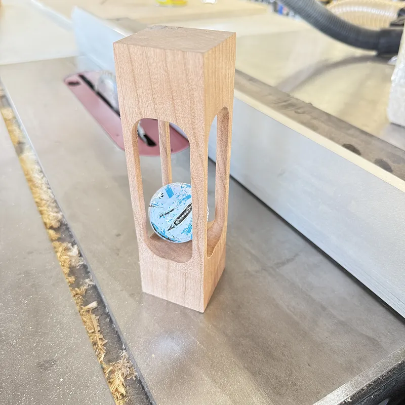

Hi Natalie -- Here is a quick rundown. Get a saucepan on the stove and bring some water up to around 200 degrees. Drop the piece in and start a timer. 10 min then push the ball into place. Cool/Sand/Finish. Hope that helps!
Neat! How did you get the golf ball in there?
Natalie SturdyPro · September 03, 2025
Cale DansbeePro · September 03, 2025
That's clever! Thanks for the explanation!
