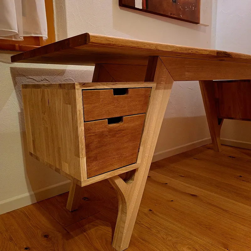

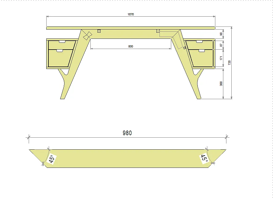

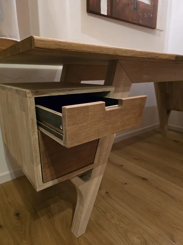

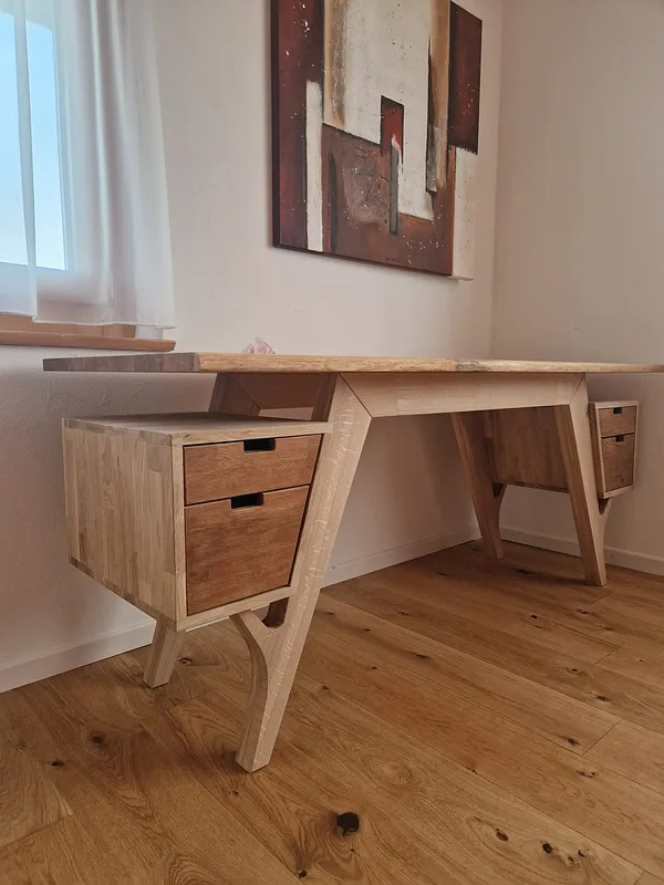

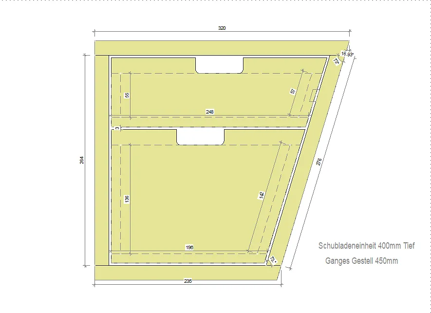

I only routed the front and back panels of the drawers and the legs with the CNC.
The legs are only 28mm thick on the easel, which means I glued two pieces together for each leg to make one leg.
The connecting piece in the middle is easy to make by hand.
TTC450 Pro CNC
Walnut
