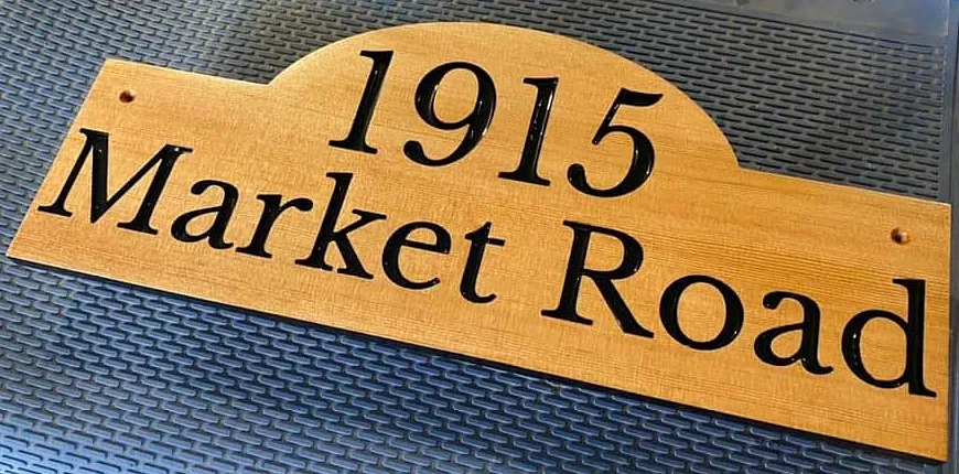

my process is to cut out the letter and shape, then paint with black acrylic paint (without any masking) then i sand the top flat surface to remove the overpaint, then varnish... hope this helps.
Did you paint the black with a brush or spray?
