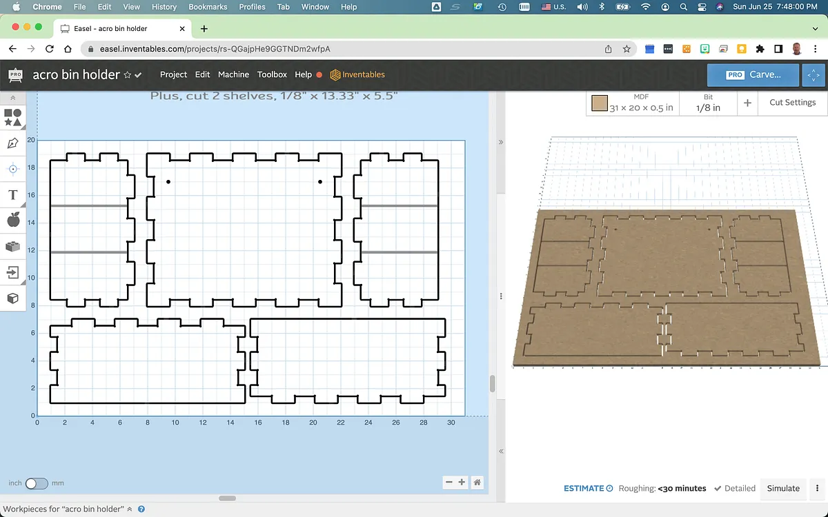

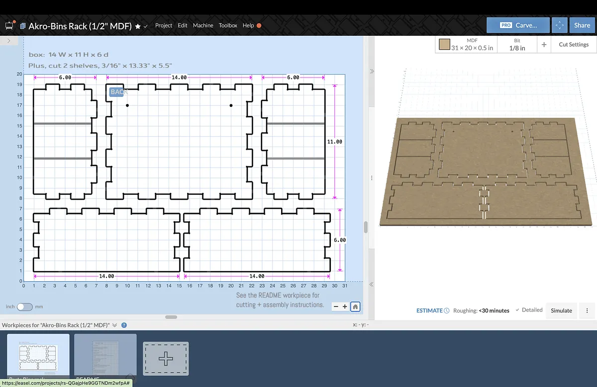

Find a piece of 1/2 MDF scrap, about 20" by 30".
Mount on CNC.
Carve per the attached digital file.
While carving, you can find some scrap hardboard (I used pegboard), and make the two shelves.
