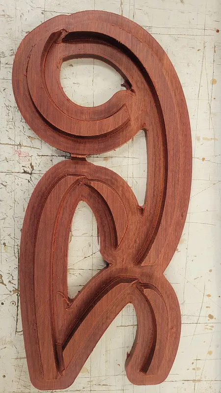

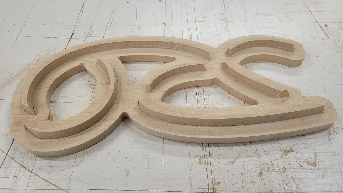

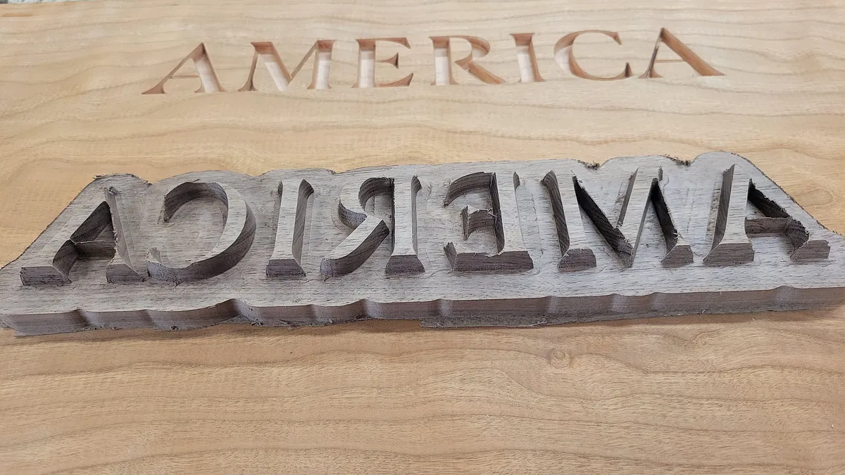

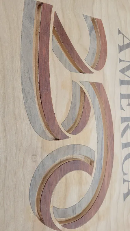

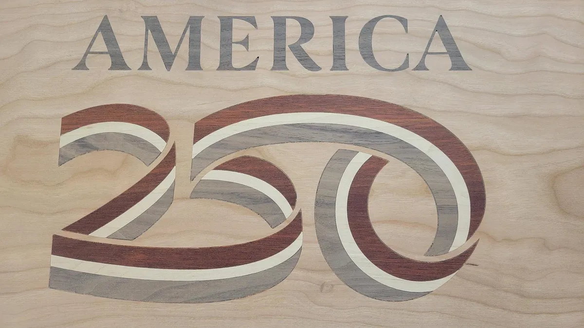

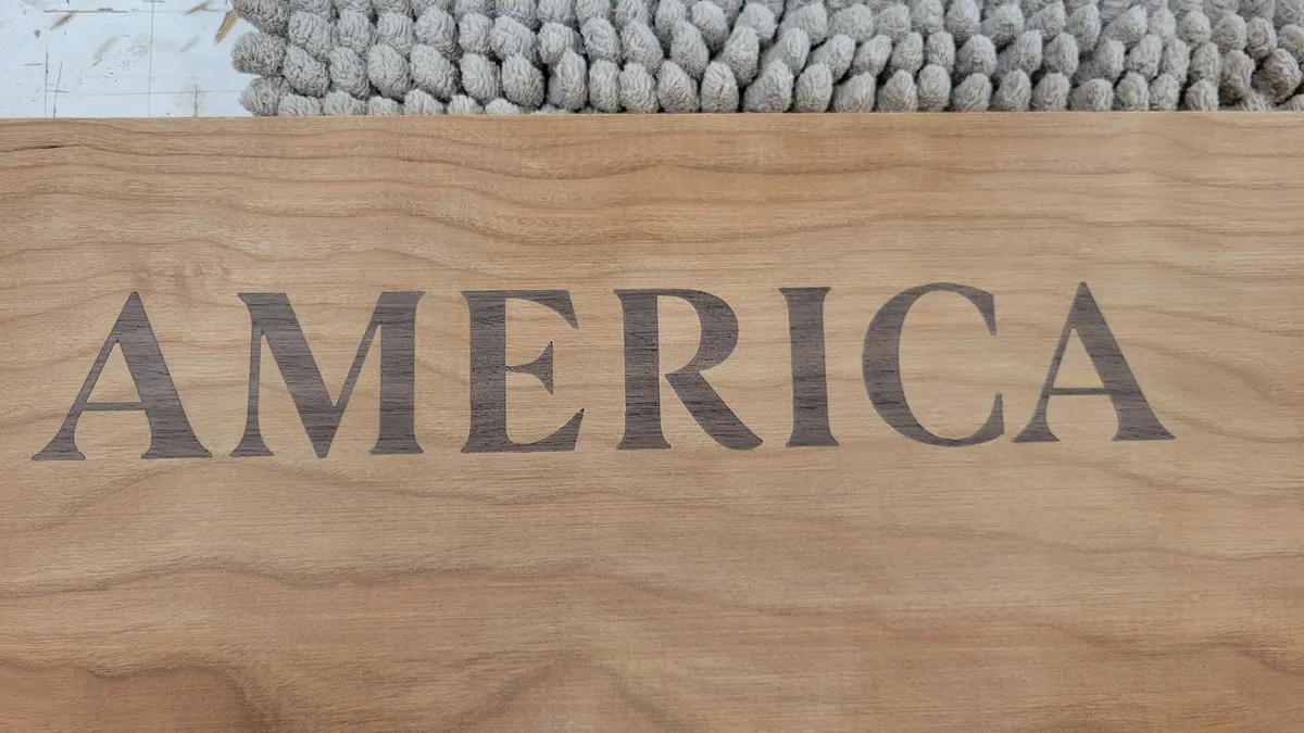

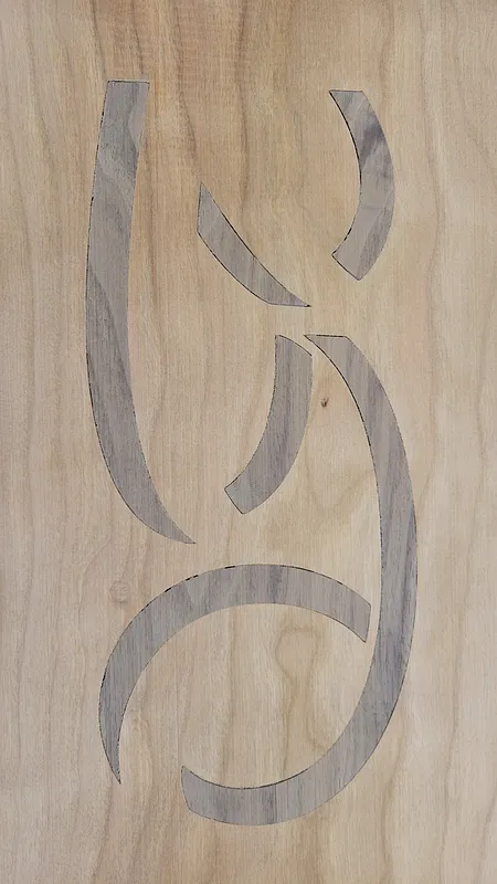

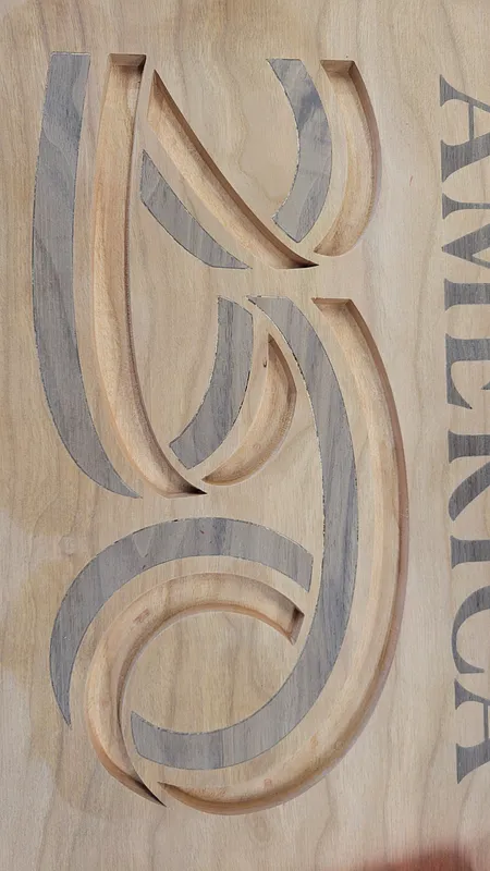

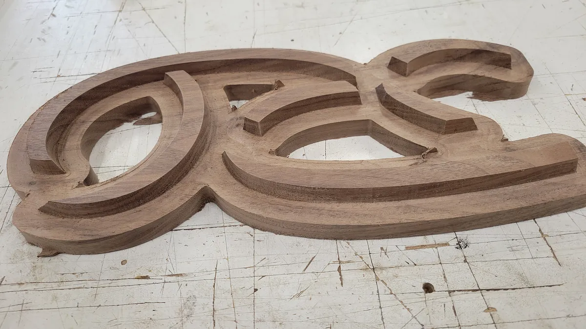

All carves were done with 1/4" downcut endmill and 15 degree V Bit except the socket for the "AMERICA", it was done with a 1/16" downcut endmill and 15 deg V Bit
This looks really good
HenryPro · July 24, 2026
I think this is one of the most impressive results I've seen yet. Nice job taking the tool and making art.
Brian AdlePro · July 25, 2026
Very nice job!!
Corey SchroederPro · July 25, 2026
Great job
