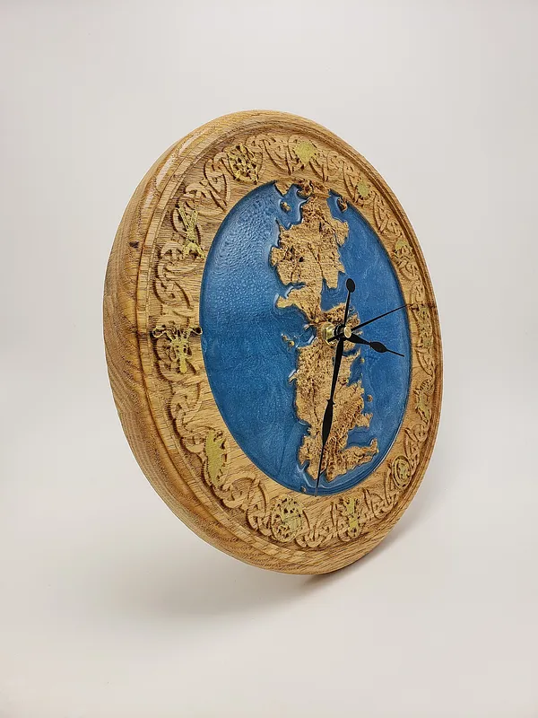

Topographical Map of Westeros. Poured in epoxy.

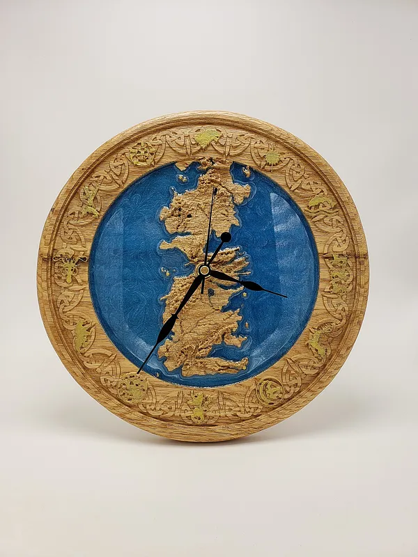

Love the clock! Do you have a tool list to go with the tool paths?
William S Searles · October 16, 2020
Thanks for looking! Yes, bits listed on the notes in the files. Its a long carve. One of the first I designed. I'm sure someone can clean it up. You're at 2.5mm End Mill on Rough 1mm End Mill on Waterline 1mm End Mill Parallel 1mm End Mill on Pencil
