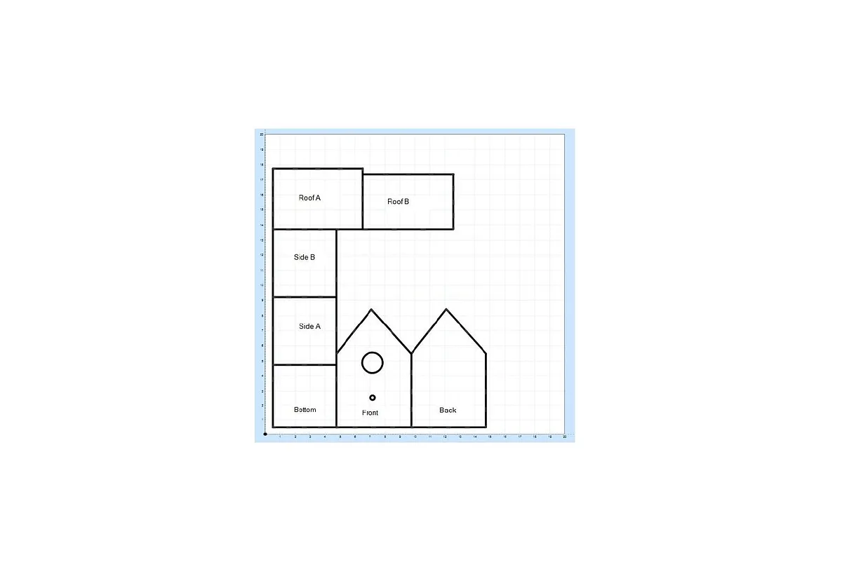

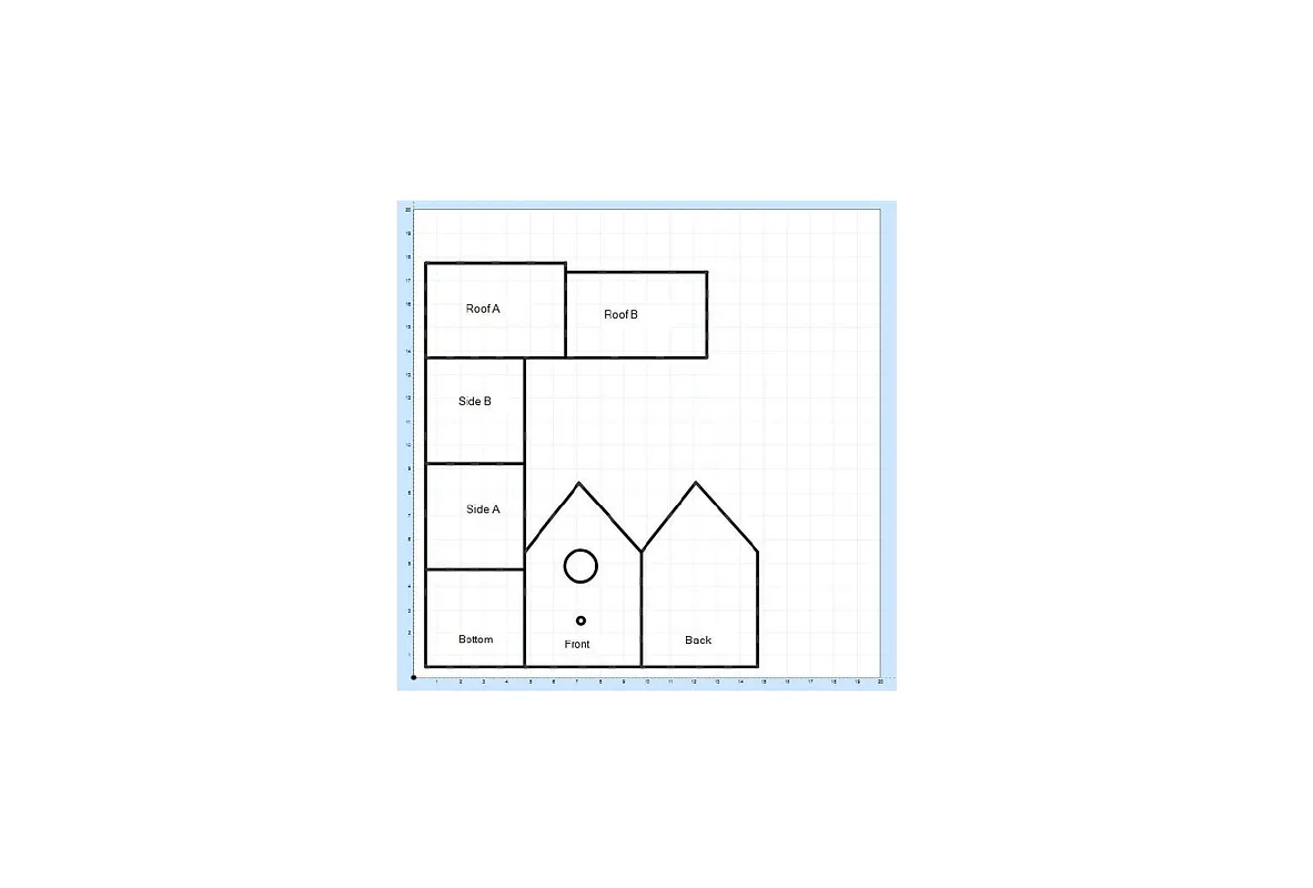

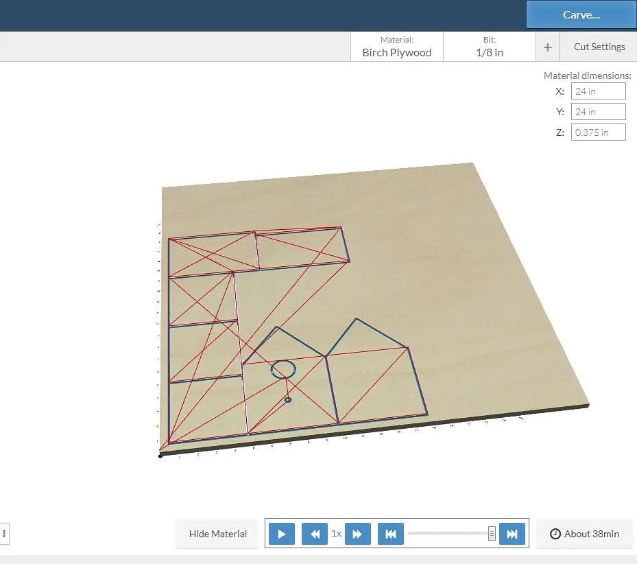

Cut parts on X-carve. If I had an X-carve I would have nice assembly photos. I will update with photos if I win. I promise. Cut from 3/8 inch birch plywood. I designed this with just line cuts, so there would be no double cutting of sizes that were next to each other. The dimensions should be spot on, but might need adjustments, after actually being cut. I will make adjustments the plans as needed once I get a X-Carve and build one!!
Estimated time: 38 minutes
