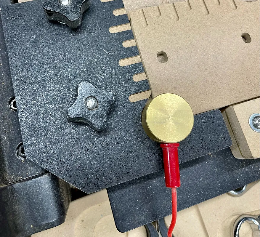

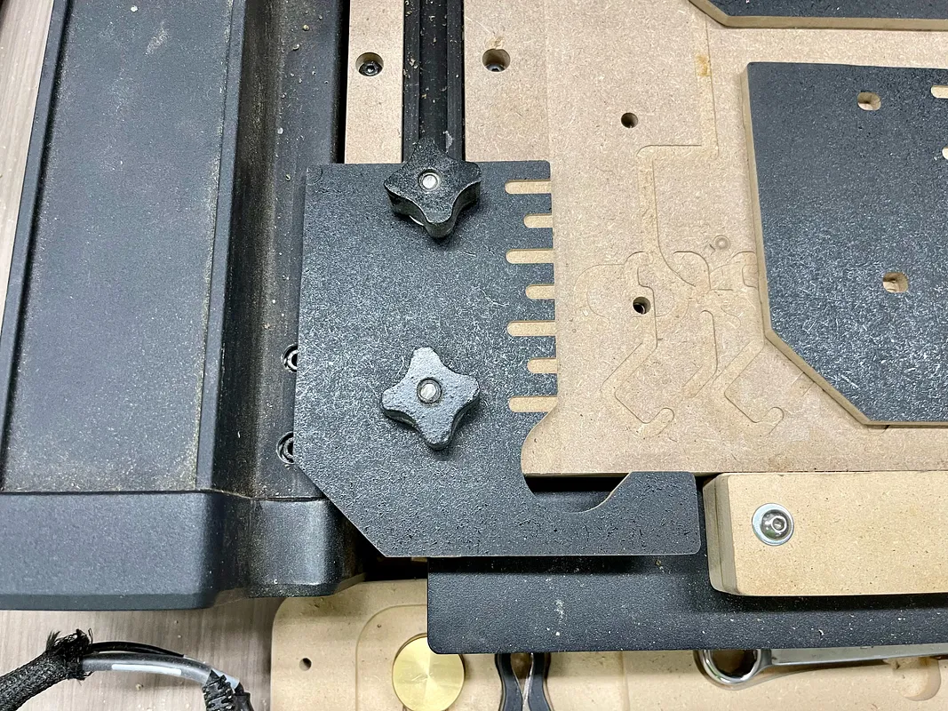

An alignment plate for the left side on the T-Track to square up your board to the zero position when homed. Designed for 1/4 inch MDF.

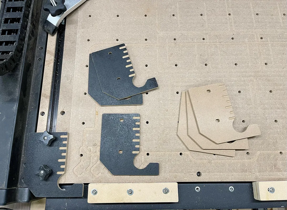

A front alignment plate is included too. You have to double up the front plates by gluing them together to make them 1 inch tall. Designed for 1/2 inch MDF.

It says designed for 1/4 and 1/2, so two bottom alignment trays in 1/4 and the one etched top plate in 1/2?
Brett nosakowski · March 02, 2023
It’s two 1/4 inch thick pieces glued after cutting
Rick RatayczakPro · March 03, 2023
This is a great idea but... The holes for the T-track are too far to the right. It's a simple fix but your file, as is, will result in unusable parts.
