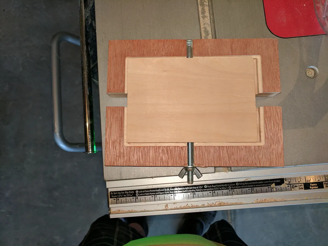

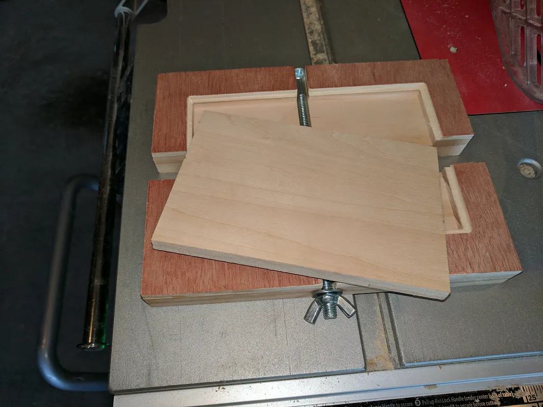

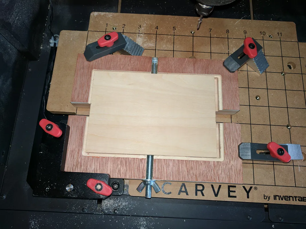

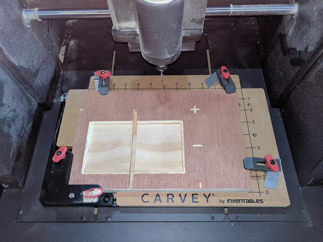

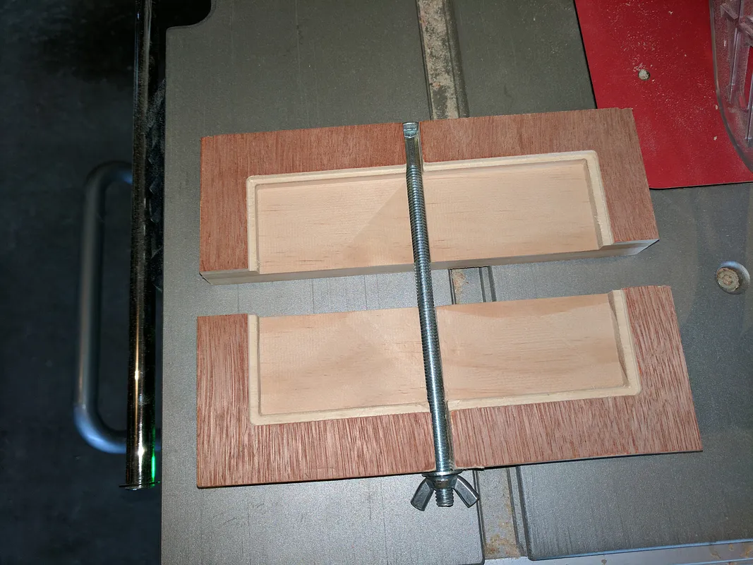

This clamp makes it possible to use a fully recess printed block with no borders in Carvey. This one is 3/8" 4x6
- The depth of the square is the depth of the target block.
- The bolt is a 5/16" x 7 carriage bolt.
- Using a wingnut for tension.
