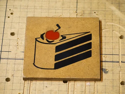

Cut MDF
First cut the MDF down to a 4x4 square.
CNC
Now mount the square and cut the cake out with both the roughing pass and detail pass
sanding
Give the mdf a light sand to fix any burrs that my have formed during cutting.
Resin
Pour the resin into the pockets as carefully as possible. The more you spill the more you sand.
sanding resin
Now sand off the excess resin. There will probably be air bubbles that get exposed from sanding.
Lacquer
Apply the lacquer to give the resin back its shine then let dry.
