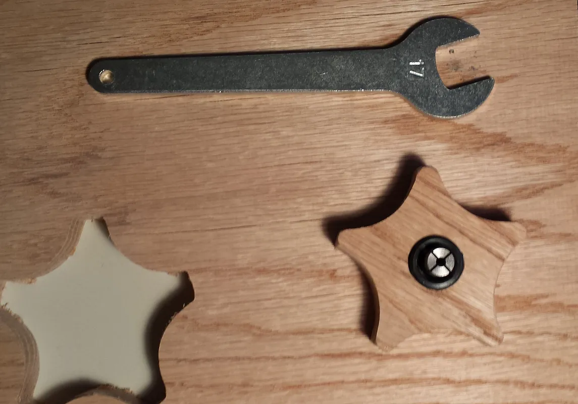

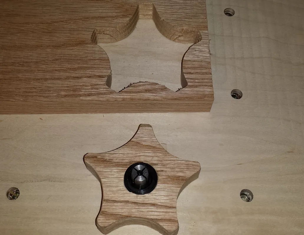

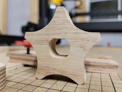

After changing the bits under my new Dewalt 611 router I found the stock wrench very troublesome. So I made one out of 3/4" Oak.

Hi Bill, you forgot to share your project into Easel, nice idea by the way!
Thanks for sharing, I made one from your Easel file about two months ago and it is so much better than the stock wrench (its collecting dust somewhere).
Irony, I opened in easel, didn't have any quality wood, used some .50 scrap MDF, worked perfect. Haven't touched the stock wrench since. You can see the dirt all over mine to prove use... Good share... THANKS.

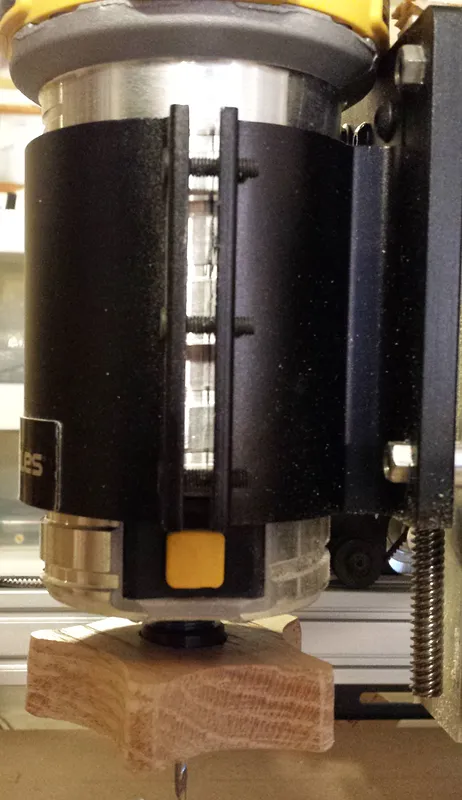

I also made one for I didn't like the movement of the spindle using the wrench. I added one feature to the already designed spindle cut out. I drilled 2 1/4" holes through the tool thickness and inserted 2 pin magnets as to prevent the tool from sliding off of the spindle while reposition my grip
This was not made to leave it on.
I wanted a smaller tool to tighten the bit in the router, rather than the wrench that comes with it.
Alternatively, check the diameter of your cutting bit, if it is a bit smaller than .125" then the hole that is cut will be smaller.
I made mine from HDPE. Used a 1/16 round over bit to clean it up. Works great! I wasn't sure about leaving it on. It was a tight fit but I wonder if it'll degrade the router performance and router itself over time?? I'll probably just take it off and make the inside hole bigger...

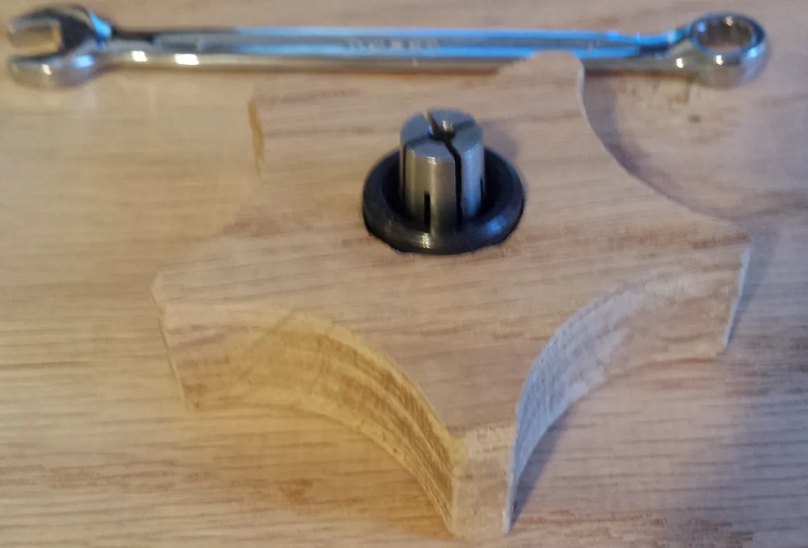

Made one doesn't fit.
Gary FlorencioPro · August 16, 2020
Gary, What dint fit? Too loose, too tight?
Bill Lawrence · August 17, 2020
Too tight....sanded it down and it fights snug. Dumb question am I supposed to leave it on?
Gary FlorencioPro · September 09, 2020
This was not made to leave it on. I wanted a smaller tool to tighten the bit in the router, rather than the wrench that comes with it. Alternatively, check the diameter of your cutting bit, if it is a bit smaller than .125" then the hole that is cut will be smaller.

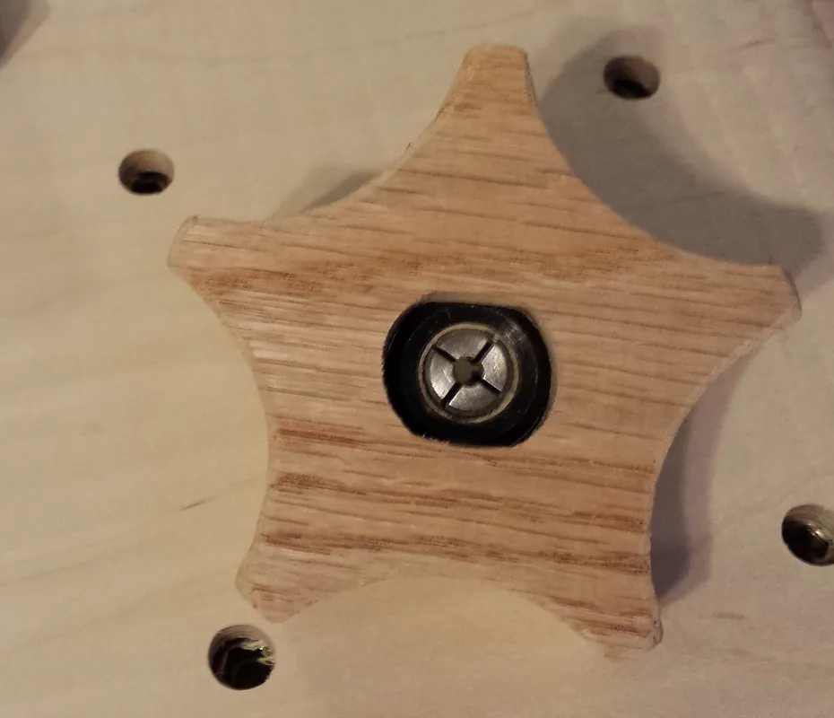

Pete DonchenkoPro · September 23, 2020
Hole's to small (TWSS) will have to remake but edit the center, still using 1/8" bit. Love the concept though!

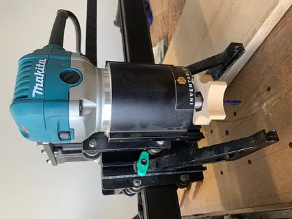

Hello, great idea as I have problems with my hands, does anyone know if this will work with a Makita router, not sure if they all have a generic collet
