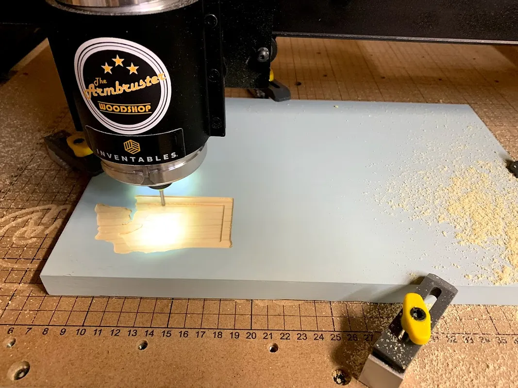

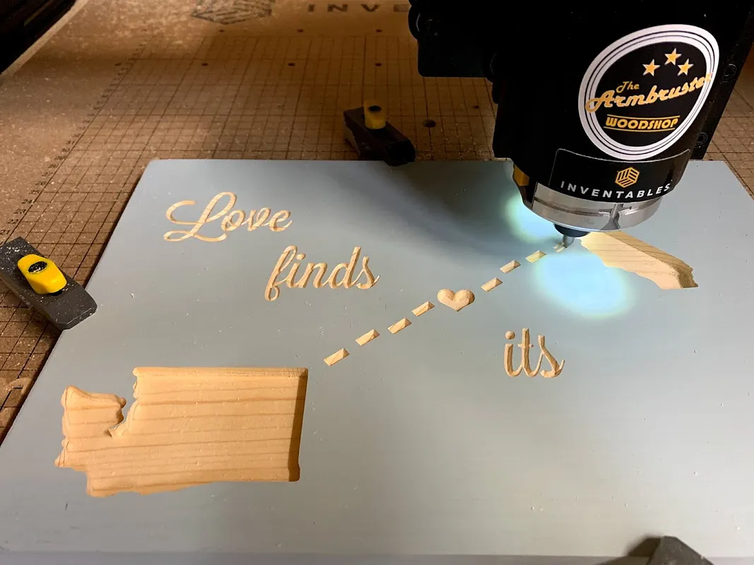

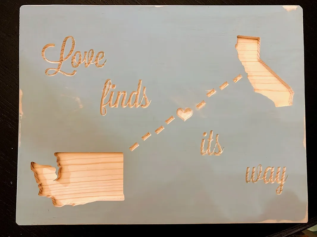

I changed the easel file to have a shallower cut on the states as I felt the sign I made was deeper then needed to be. I used a downcut fishtail bit for the states and a 60 v bit for everything else.
x-carve 2016
Birch Plywood, Hard Maple, Soft Maple
