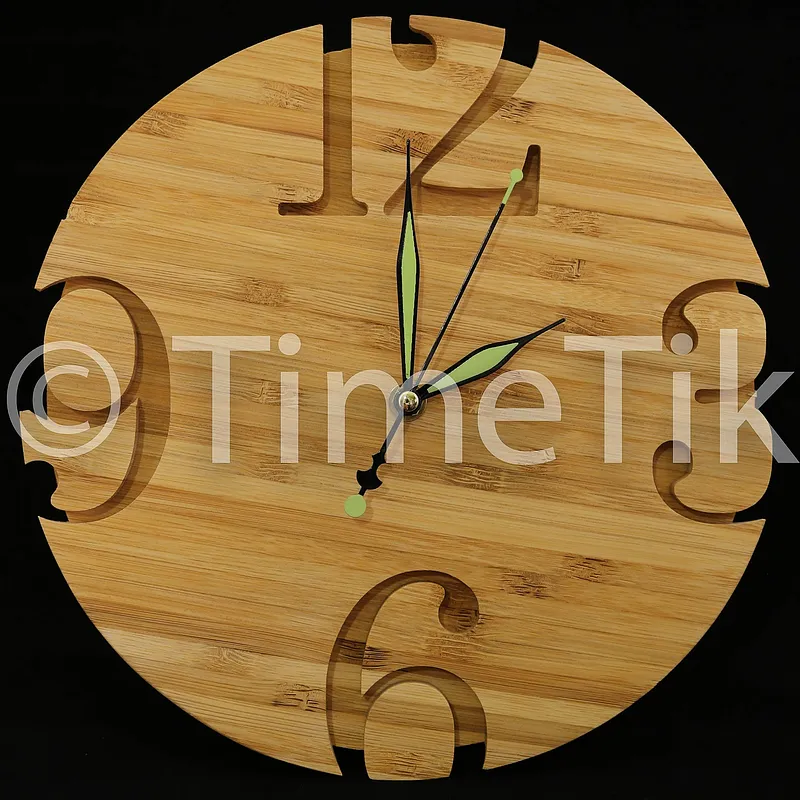

prepare the wood
prepare the bamboo ply wood piece and make sure of the alignment, the dimensions don't allow for a lot of tolerance
Estimated time: 5 minutes
open the easel project and carve
once the bamboo piece is secured properly to your CNC, start the carve. best to use 1/8 inch up-cut bit if you have to minimize the face tearout
Estimated time: 58 minutes
finishing
once done, clean out the tabs and take out the clock body and apply 2 coats of finish. I applied some polyurethane coats, it gave a nice look and feel to the clock
Estimated time: 120 minutes
add the mechanics
you will need a clock mechanism with a long shaft to adapt with the wood thickness, you will also need it to have a holder on the body as wel.
Secure the clock mechanism to the back of the clock, set the time, and hang it on the wall
Estimated time: 10 minutes
