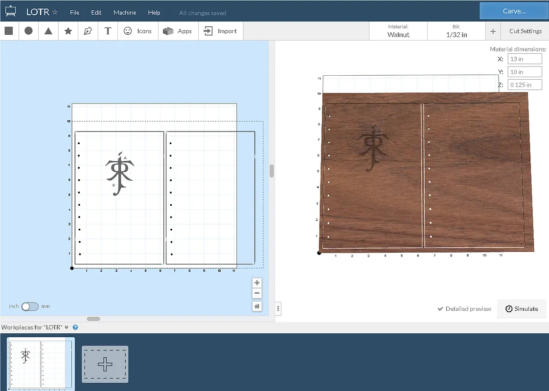

First, choose which species of wood you'd like for the cover. I love the look of walnut. The book covers are 6" x 9". If you find a 13" x 10" x 1/8" you should be good to go. I didn't want to cover to be too thick, so I chose .125" thickness. Once you'd chosen your wood, open the file and start cutting.

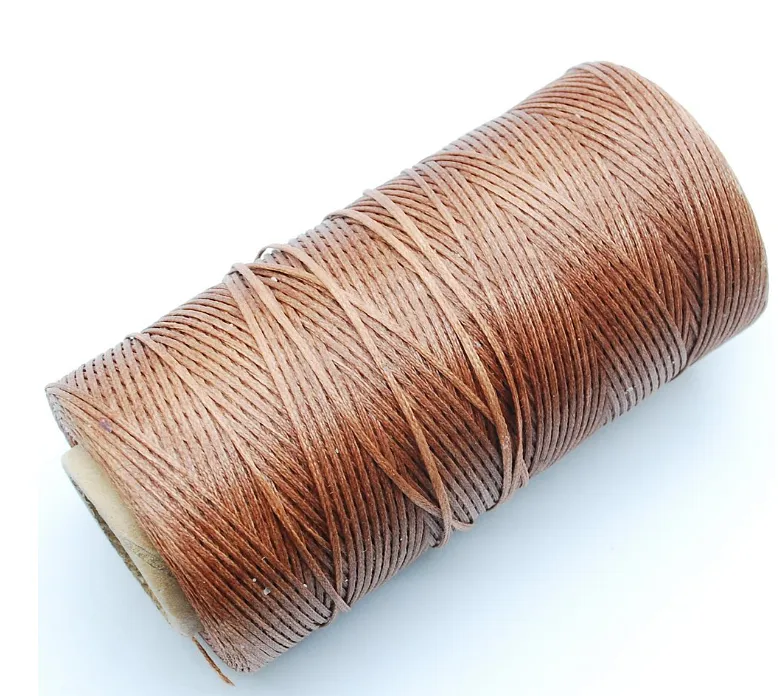

Some people may choose to skip the leather binding. If so, line up the pages between the covers and punch holes through the paper corresponding to the holes in the wood. Then thread leather sewing thread through the holes in the wood and the paper to tie them together.

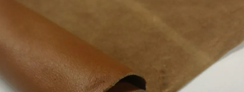

If you want to add leather binding, there are multiple techniques and guides out there to help add an extra flair to your custom book.
