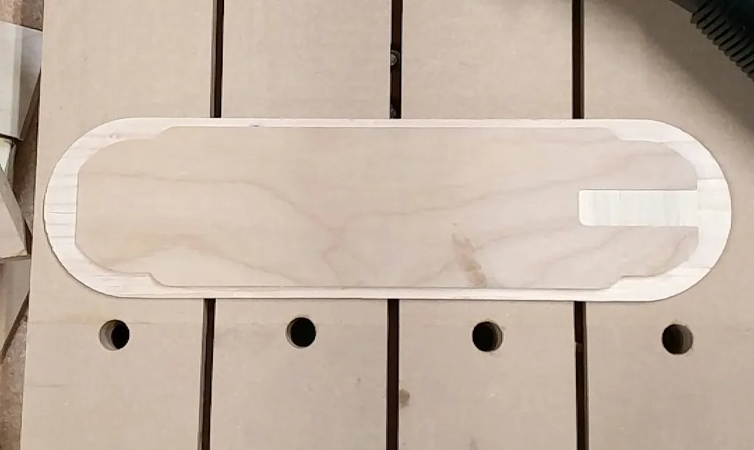

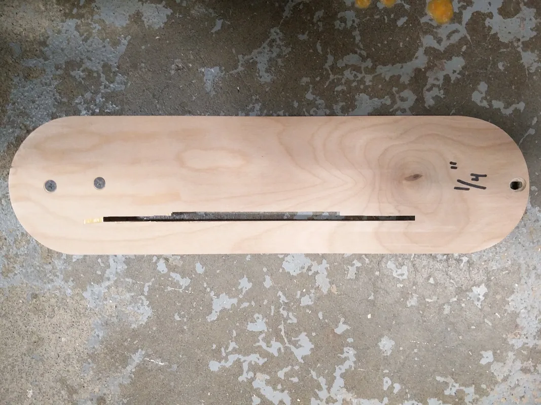

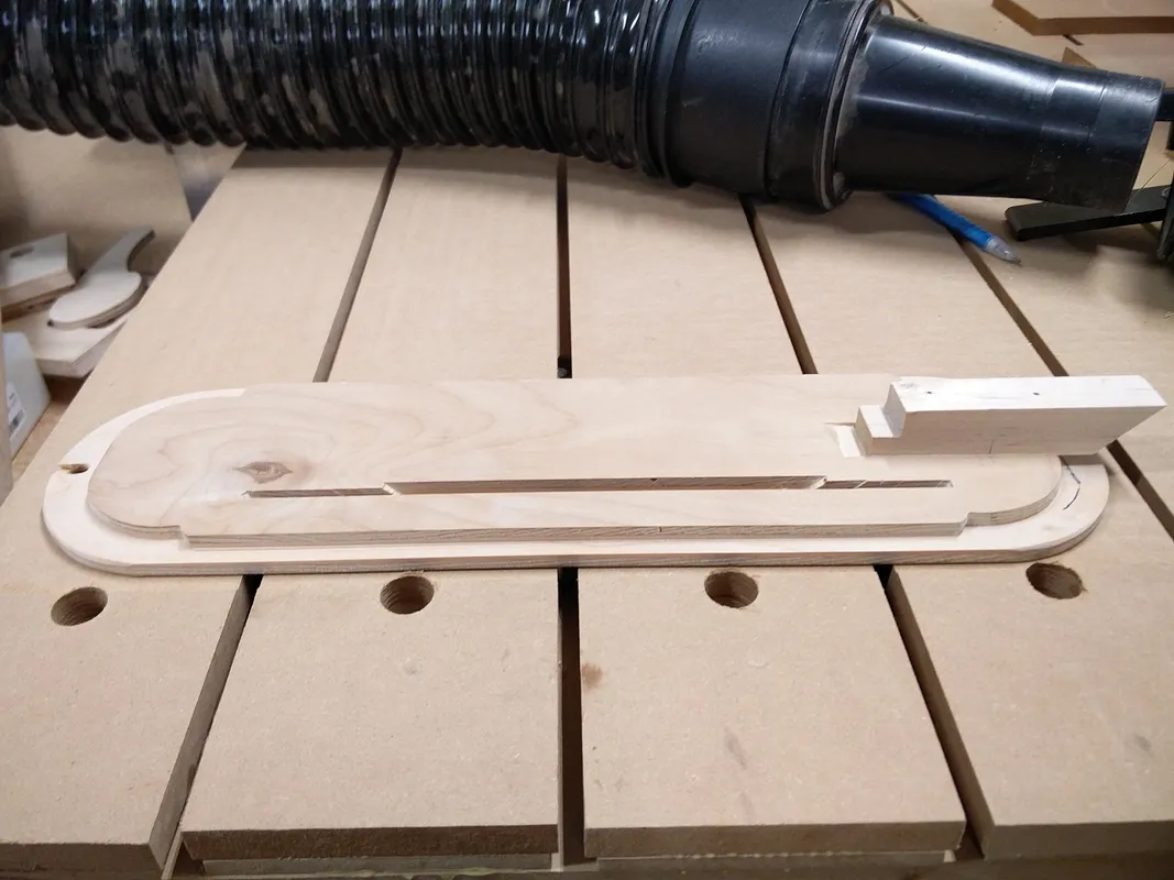

Rigid Table Saw Zero Clearance Plate
Template for making zero clearance table saw inserts for Rigid table saws. *Design is for 7/16 plywood, adjust depth of cut for your stock so the plate thickness around the edges is 0.21875 inches thick. *Pocket at the back is to attach an angled piece to prevent lifting in the back.
