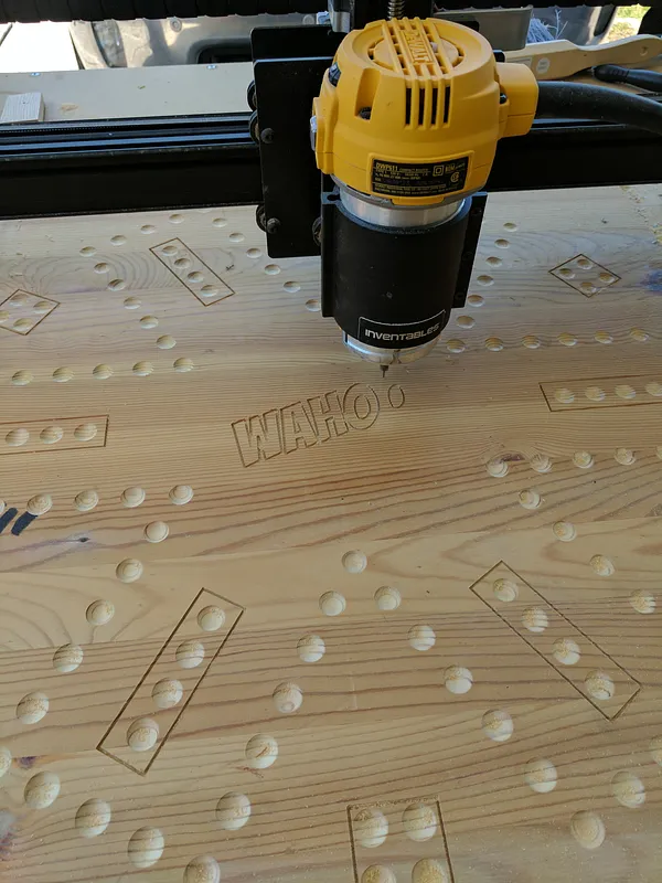

24x24 piece of wood
I used an old table top that was lying around.
Use a 3/4 inch round nose router bit
This bit works best for the marble holders, as an alternative you could drill holes and use wooden golf tees instead of marbles.
1/16 end mill bit for all other carving
Used a standard 1/16 end mill bit for all the rest of the carving.
Final cuts
use a 1/4 end mill for the outside , I ran it about 3/8 down and cut the rest out with jig saw and finished with a hand router.

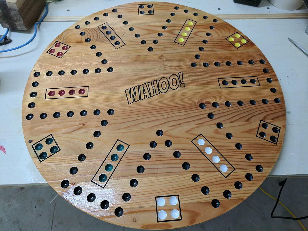

Paint and purchase marbles
I paint , so i had several colors of acrylics around the house, finished it of with lacquer. below is a link to where i bought game marbles. I bought these because a made 2 different games you could probably find just enough cheaper.

nicely done. I wanted to make this but it seems the marble holes are missing from the project.....
Jay McCoyPro · January 10, 2019
there are 3 cuts to this project the first is the 1/4 for the shape, the second is a 1/8 bit for the rectangles, and the third is the roundnose for the marbles in easel all three opened for me.
