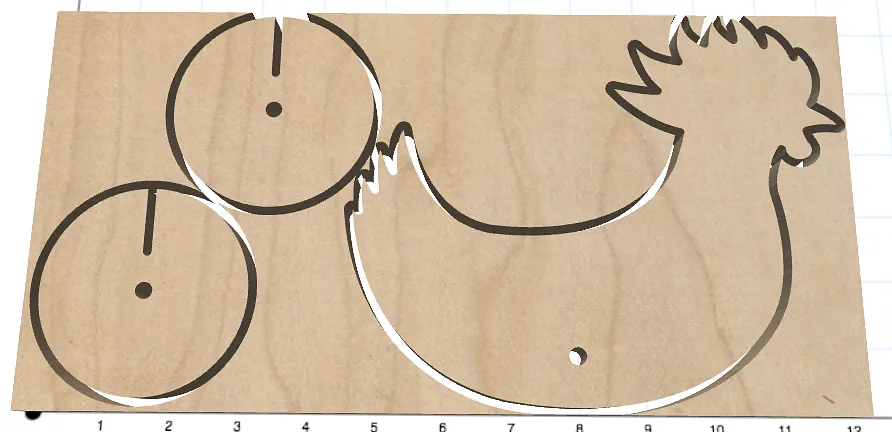

Cutout Chicken and Wheels
Set up the 6"x12" 3/4" hard maple board, setup the X-Carve with an 1/8" bit and hit carve.
Estimated time: 24 minutes
Cut out Linoleum feet
Set up the 4"x6" 1/8" linoleum, using a 1/16" bit in the X-Carve then hit carve.
Estimated time: 2 minutes
