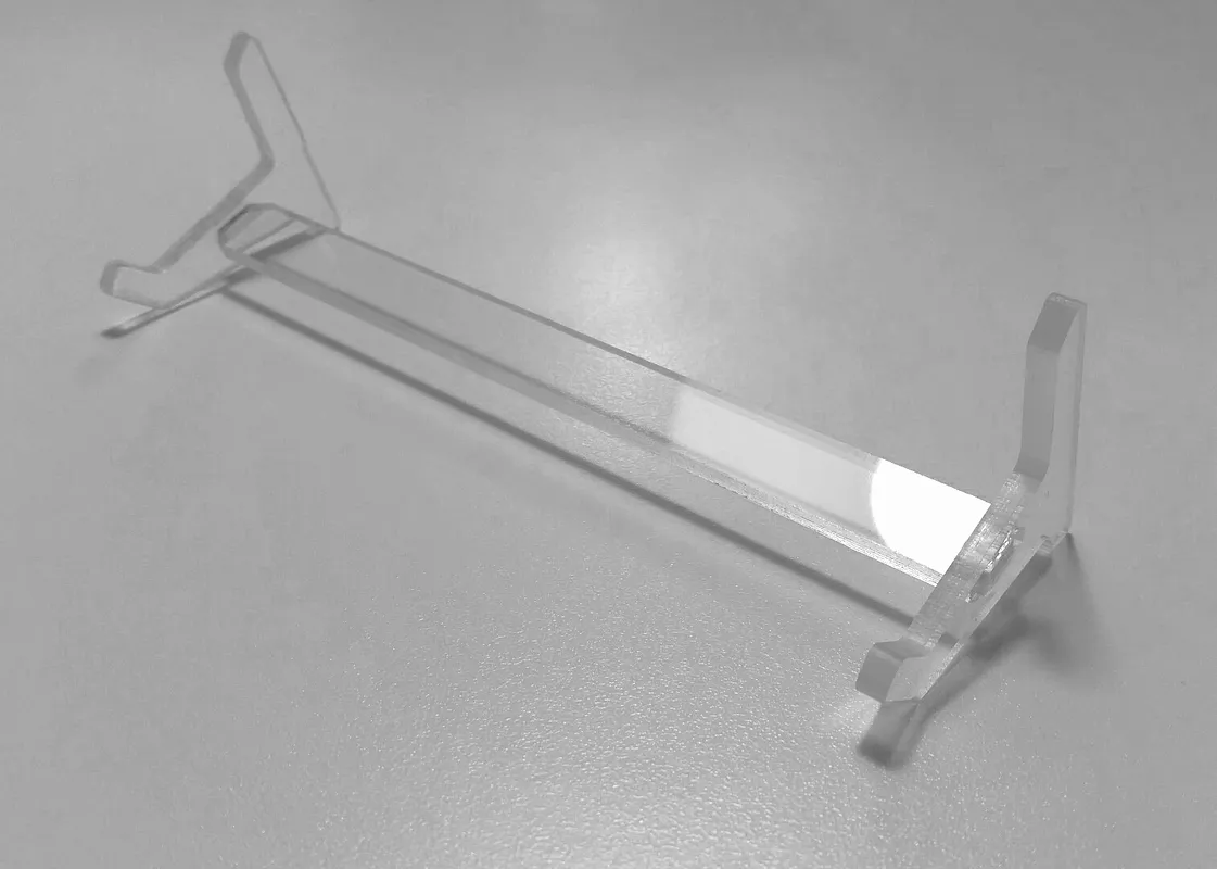

Cut it
Cut the 3 parts with a carving machine. I used the shapeoko 2 with a 1/8" single flute from inventables at 18.000 rpm. Maybe it was a bit too fast turning, because the acrylic sometimes began to melt on the milling bit. I used the default Easel Settings for acrylic.
2
Glue it
Glue the pieces together. That's it.
