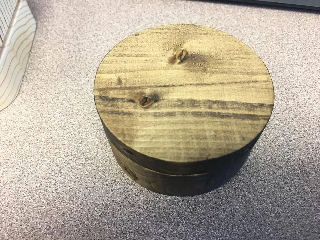

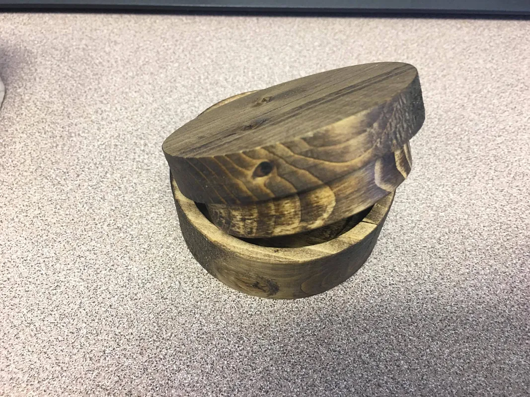

A circle box made from a 2x4 using a 1/4 router bit. Recommended: 1. set depth per pass to be 20% of over all thickness of the wood. 2. make sure you zero x and y at low as possible on the piece of wood.
