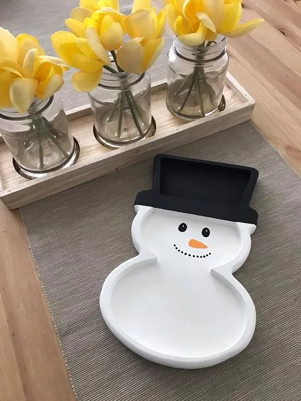

Cut Material
Cut your favorite piece of wood at 6.5" L x 10" W x .75" thick.
Estimated time: 4 minutes
Clamp
Hold down your material.
Estimated time: 2 minutes
Start Carving
Adjust your tray depth if needed.
I used a 5 flutes 1/4" endmill.
Custom Rates: - 100 in/min Feed Rate - 40 in/min Plunge Rate - 0.125 in/min Depth Per Pass
Paint/Finish
Pain or Stain it. I used acrylic water based paint.
Estimated time: 20 minutes
Clear Coat
I gave two Gloss Clear coat.
Estimated time: 30 minutes
