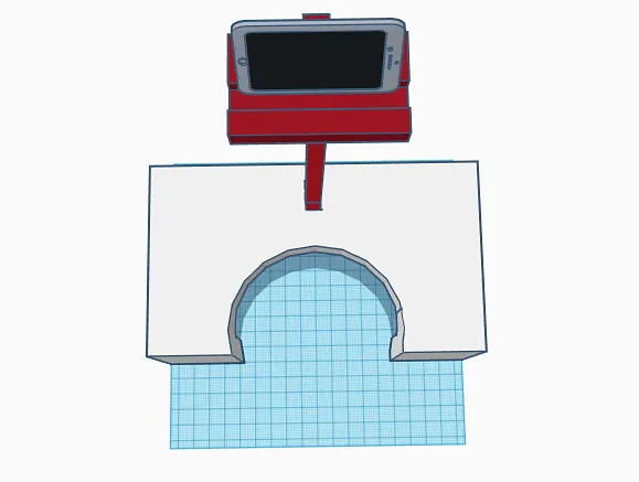

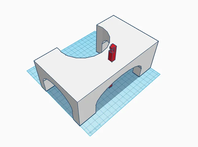

Acquire Squatty Potty or Stool

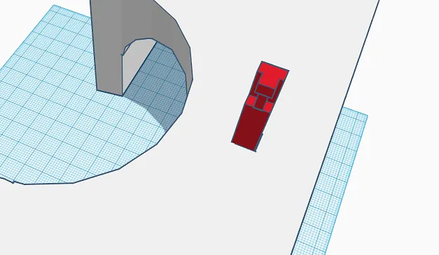

First, purchase a Squatty Potty or some sort of low stool. Make a square opening that is approximately 3/4" square (.75" x .75") in the top of the stool between where your feet will sit.

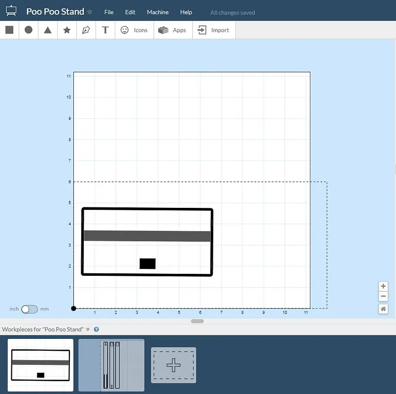

Cutting the Stand

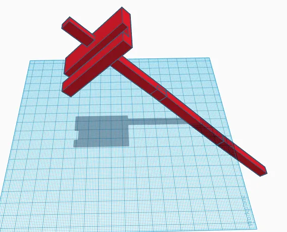

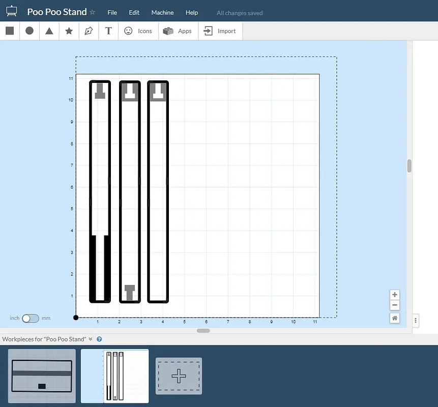

Place your material on the CNC and get it positioned. Open Easel and begin the first cut on your first piece of 6"x12"x3/4" wood. Go ahead and cut. This first piece is the top of the phone stand.

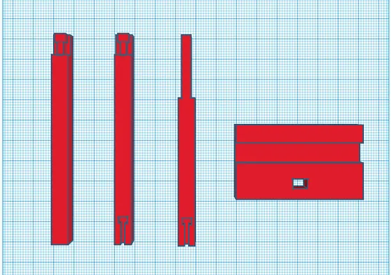

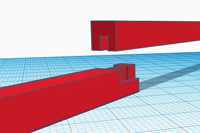

Once the first piece is finished, repeat the steps using the second page and second piece of material. The second page has the pole that will thread through the Squatty Potty and will hold the top of the phone stand. Each pole is designed with a "T" style cutout so that they will fit together.
Estimated time: 10 minutes

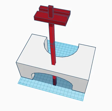

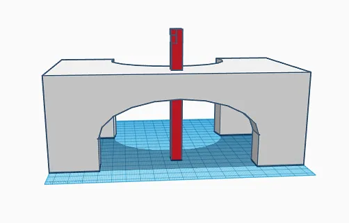

Assemble
When the cuts are finished, sand off any rough parts and then assemble. You can either glue the poles together, or leave them as-is so that the stand can be broken down and stored in smaller sections.
Once assembled, enjoy your hands-free experience!
