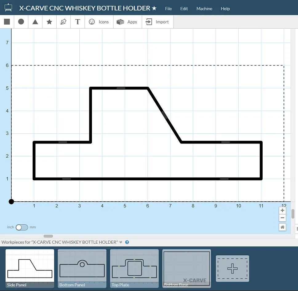

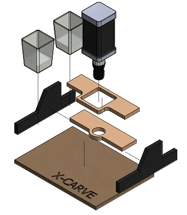

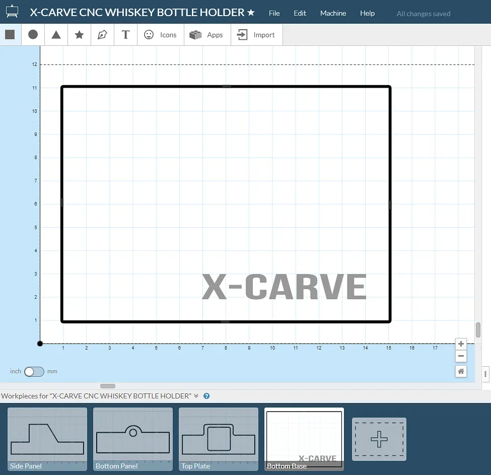

Step-1 Carve Side Panels (Mini CNC Maker Slides)
You will need to run this program twice (both sides of Mini CNC) & place aside for later assembly
Estimated time: 12 minutes

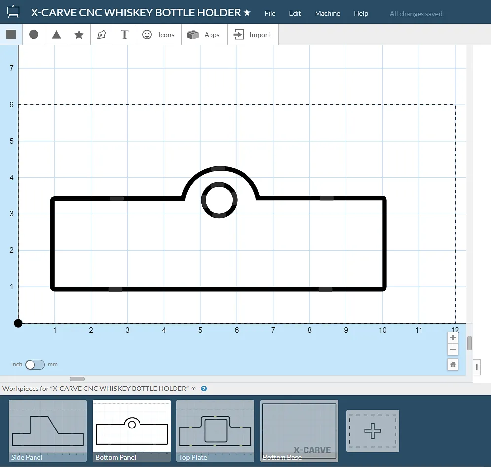

Step-2 Carve Bottom Panel (Gantry Bottom)

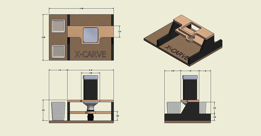

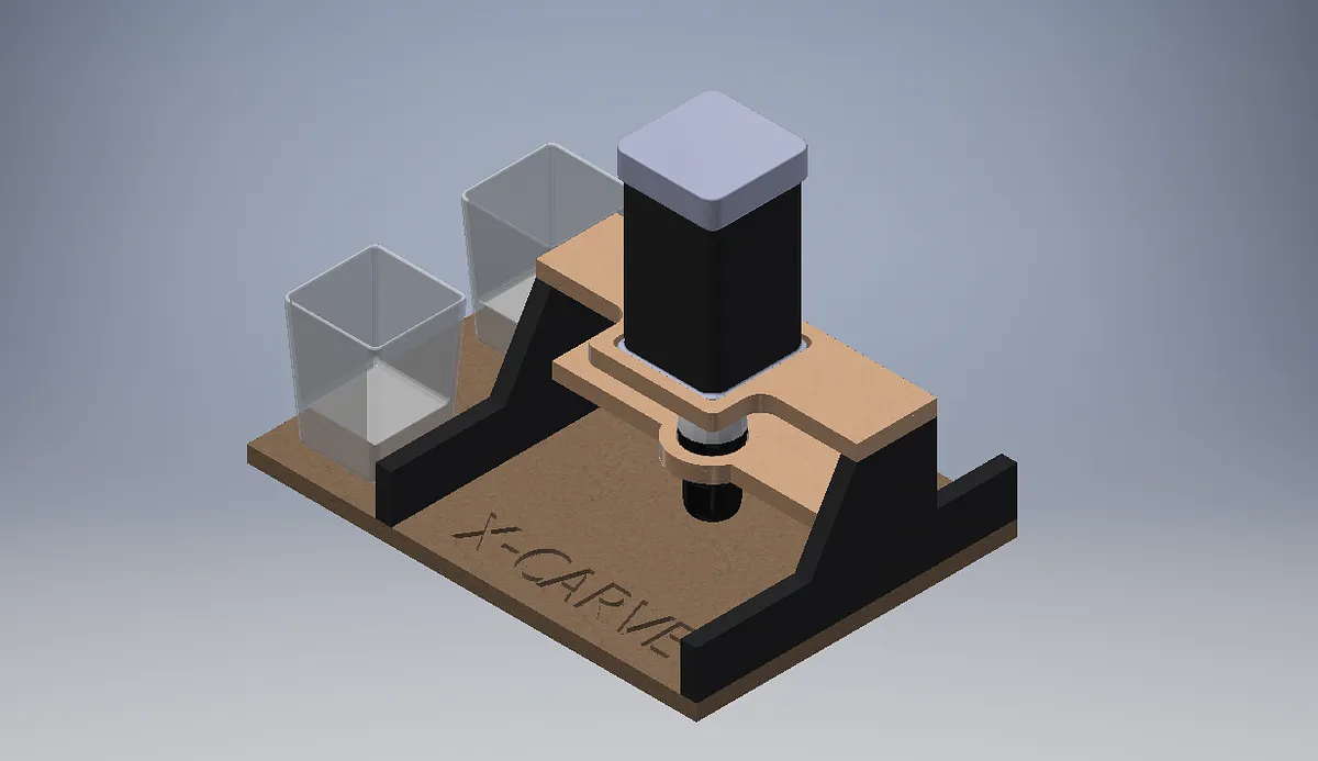

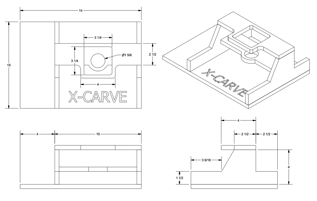

Depending on what bottle you plan to use this will be per your modification. I designed mine to fit a 750 ml square Jack Daniels bottle.
Estimated time: 7 minutes

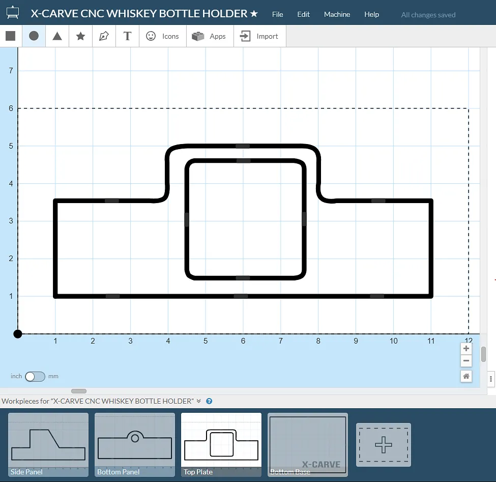

Step-3 Carve Top Panel (Gantry Top)
Again here depending on what bottle you plan to use here is your place for modifying the opening to hold the bottle. Mine is square
Step-4 Carve Bottom Base (Mini CNC Waste + Side Board)
This is where you can really make it yours. I engraved just the X-Carve name where the spindle (bottle) would carve into the waste board.
Estimated time: 19 minutes

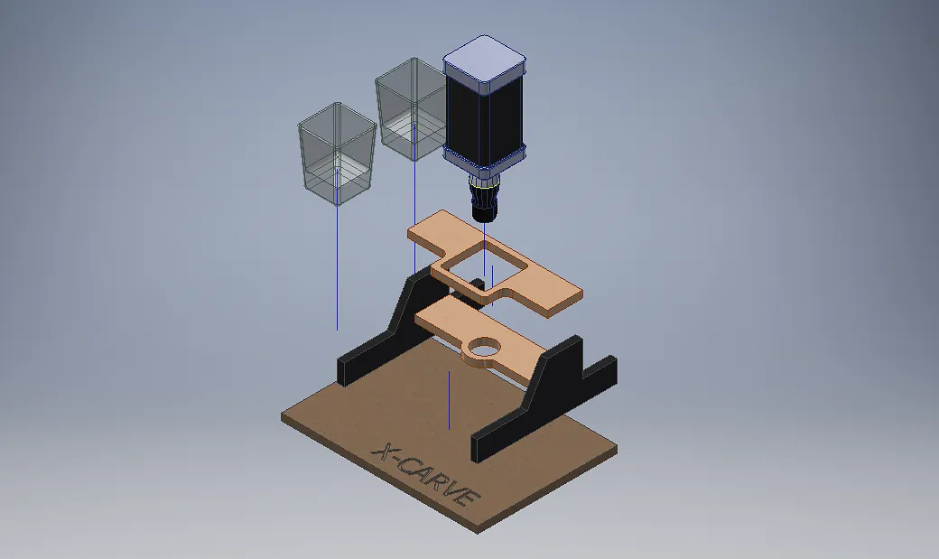

Step-5 Assembly
I'm going to say this will take about 11 minutes so total time will be at 59min. Sand and smooth all parts paint as desired I would paint my side rails black to match X-Carve and clear coat MDF to prevent any water damage. Place all parts together with glue/screws.
Estimated time: 11 minutes
