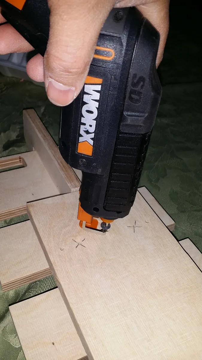

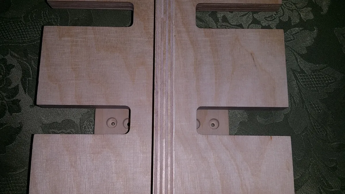

Countersink the holes
Make sure to countersink all the holes for the screws.

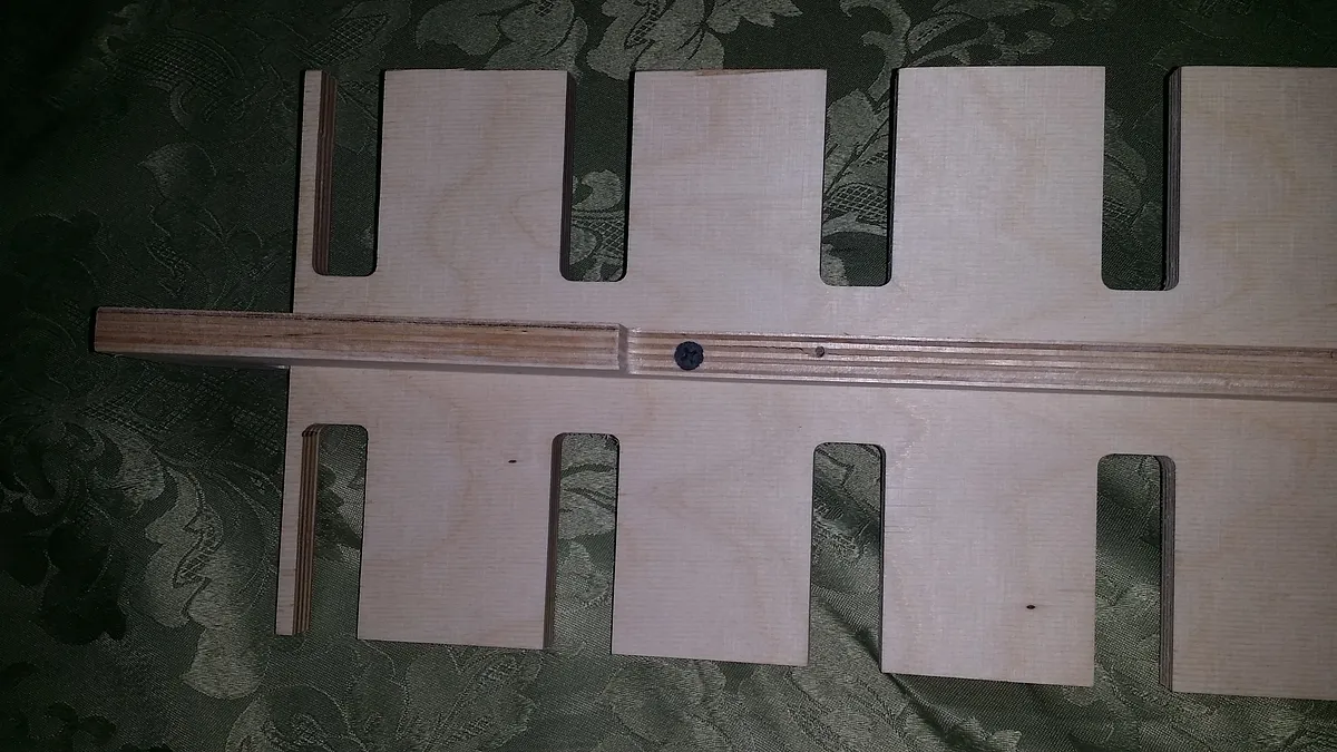

Slide the notched part
Next, slide the notched piece through the gapped one and drill holes on the top and bottom 1/2" from the edges and countersink those too.
