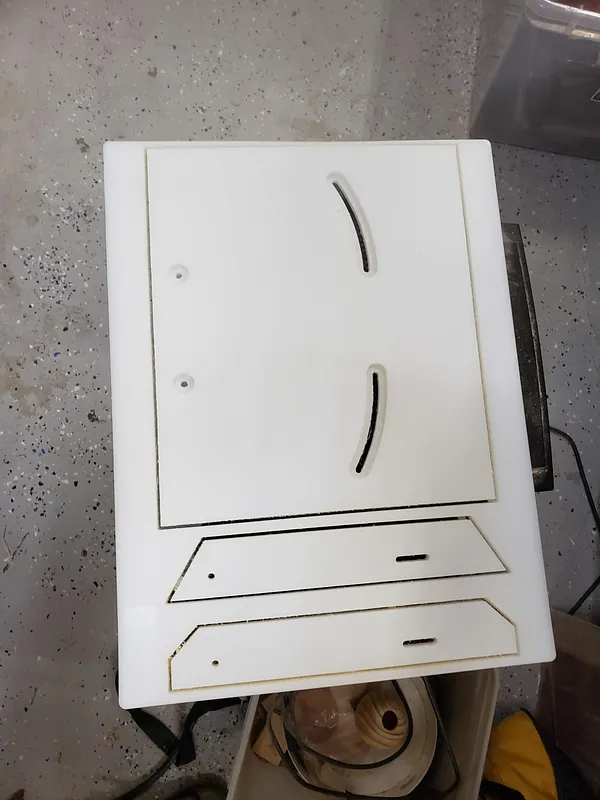

Wedgie Sled w/ Fences
This file creates a complete Wedgie Sled including the fences. Instructions are available at: http://www.segeasy.com/wedgiesledplan1.pdf.
The required hardware is listed below:
(4) 1/4-20 Carriage bolts 1 1/2" long (4) 1/4-20 Star knobs
recommended (1) MicroJig Zeroplay Miter Bar
x-carve 2016
MDF

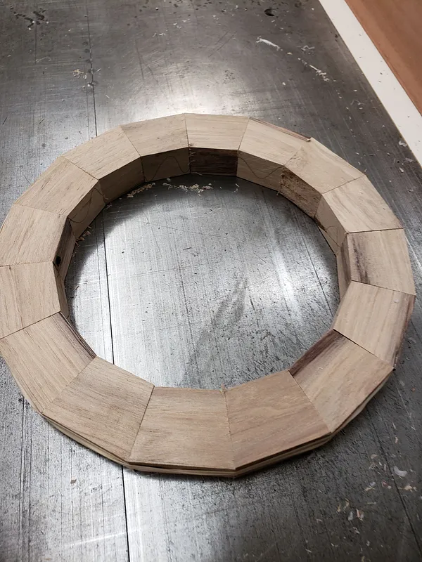

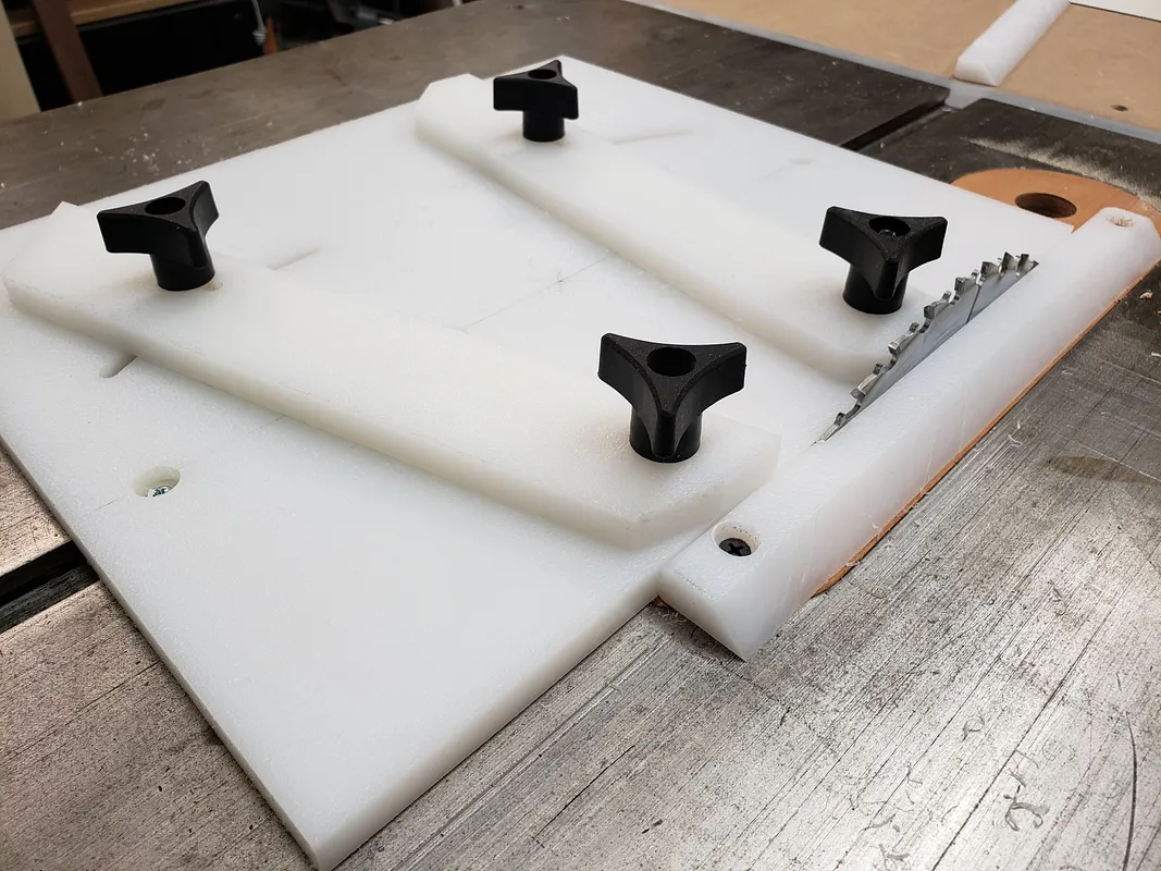

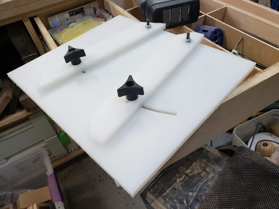

This was a great project. I did make one and its working great! The only thing I changed was the distance between the 2 fences. I moved mine apart so I could cut a segment 3 inches in length. Thank you for sharing!!
