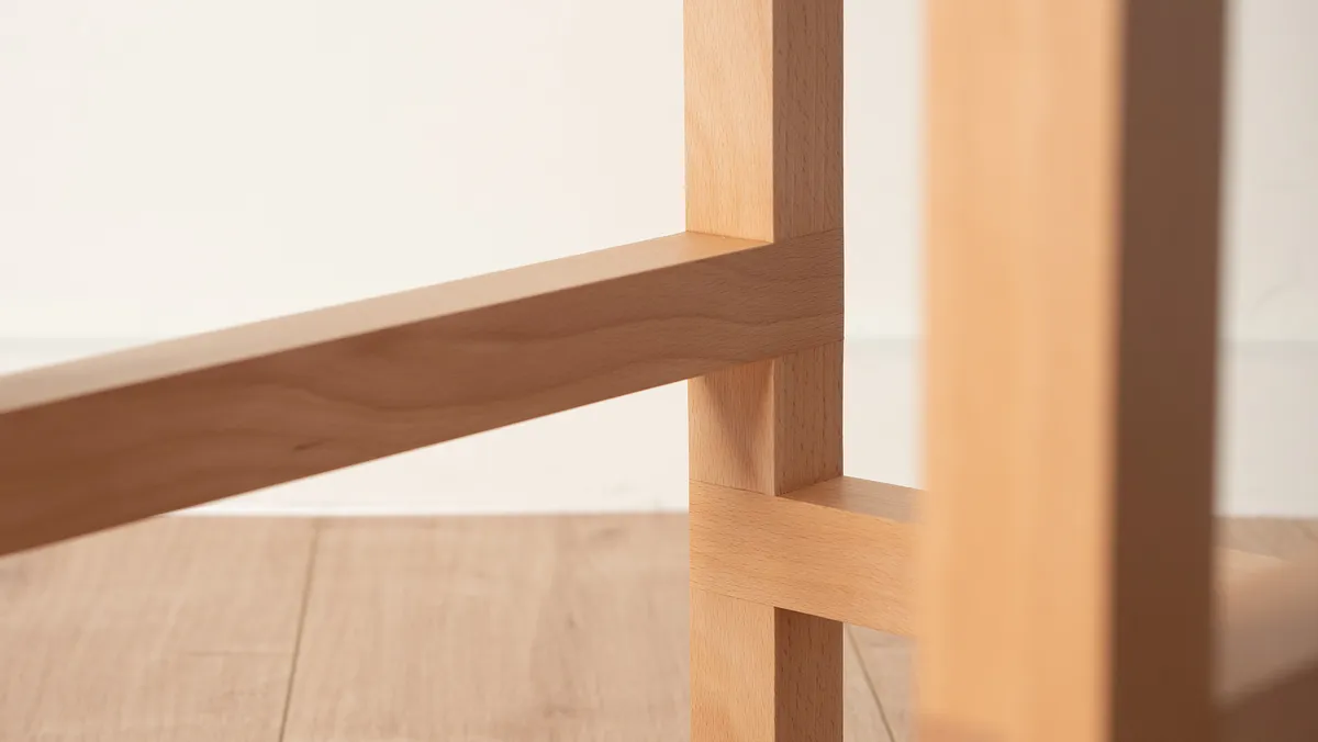

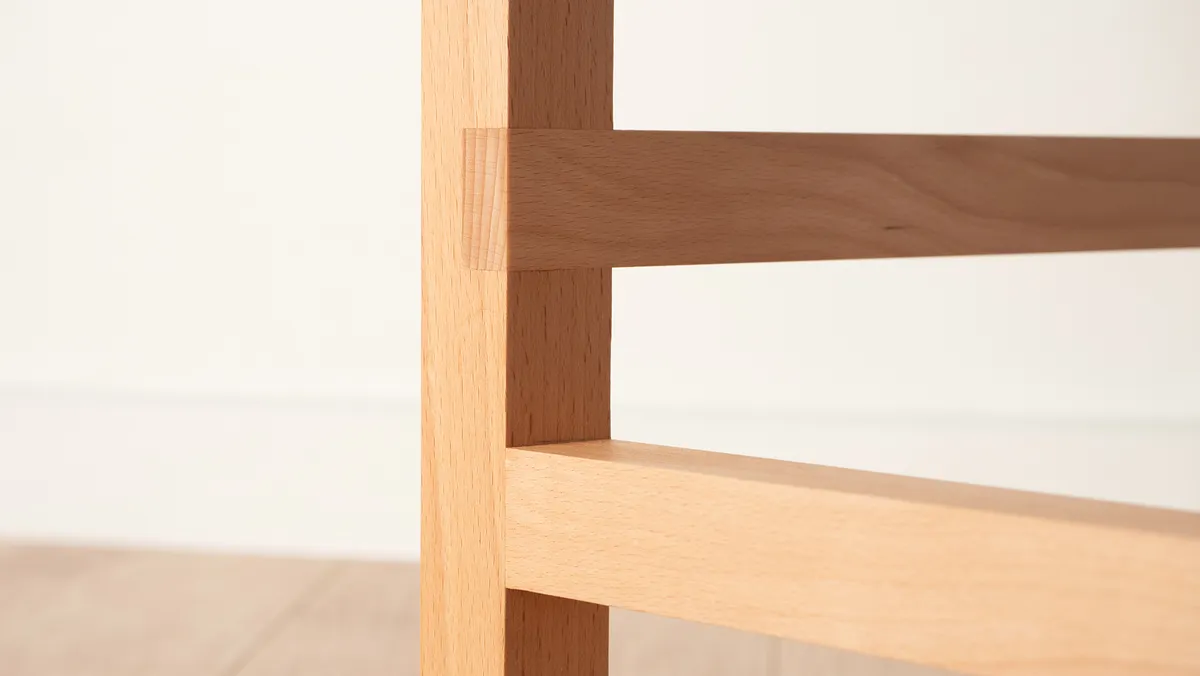

Carve all the parts
To make sure everything works out nicely, make sure to use 30mm thick wood. Start by carving one leg and one stretcher and test the half-laps. If they are well fitted, go ahead and carve all the parts!
