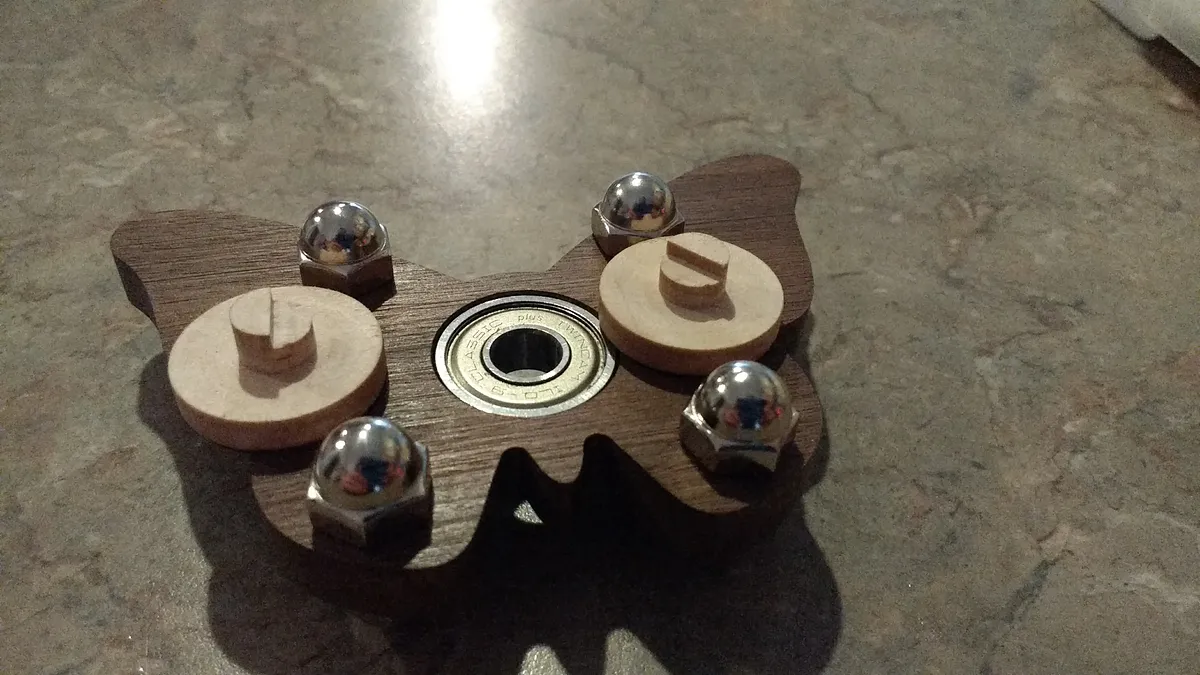

When assembled there is a 9mm ((10.5-5.0)+(8.5-5.0)) gap between pads. This allows for 1mm of clearance on each side if you have 7mm thick bearings. You will have to adjust if your bearings are thicker or thinner. I mainly chose the 9mm gap to match the thickness of my spinner material, which is just under 9mm. You may want more or less clearance based on your spinner material thickness.
I would recommend editing one of the models and then copy and pasting to get the heights set for the second.
Some thoughts for changes: - The pads are 5mm thick, but could be slightly thinner. - The diameter of the pads is 22mm which matches the diameter of bearing, so that the bearing is exactly covered. You can still see a bit of the bearing when viewed from an angle. You could increase the pad diameter to more fully cover the bearing, but allow some clearance to prevent rubbing. On the other hand, you could reduce the pad diameter and have the pad sit below the level spinner material.

The posts fit pretty tight in the bearings, but eventually they came loose. A small drop of glue on the mating surfaces, works great.
