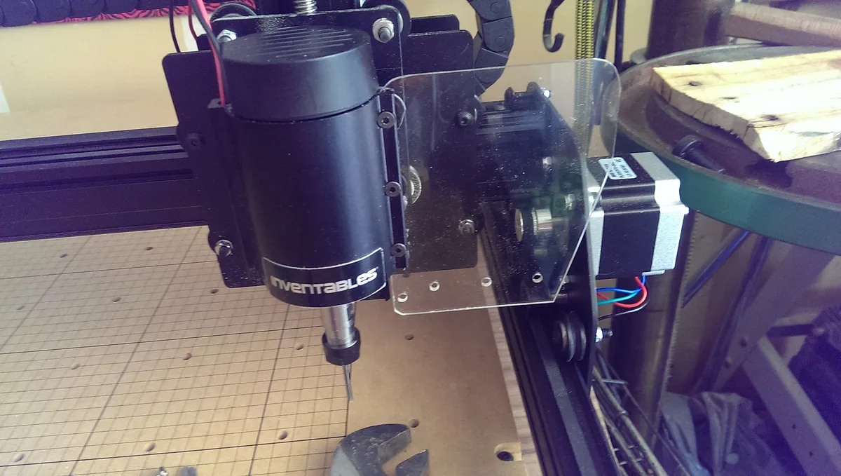

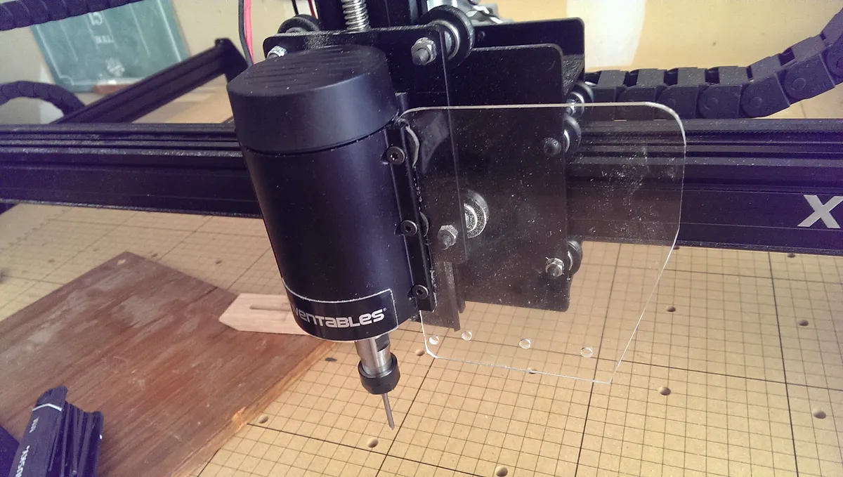

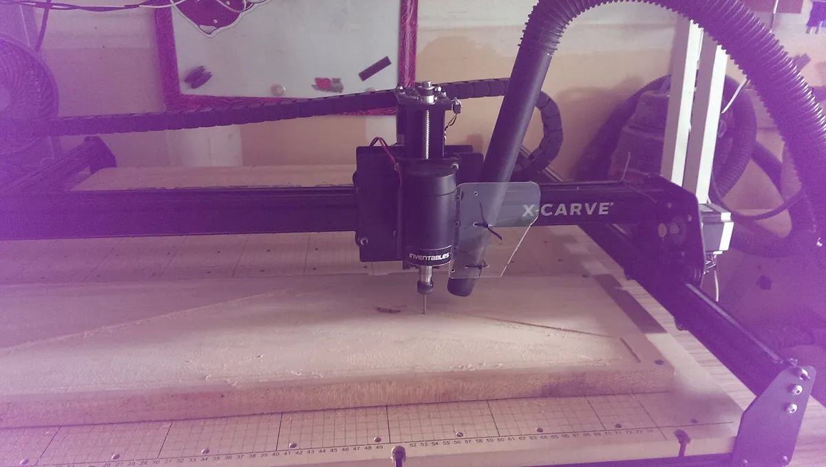

X-Carve holder for the JTech Laser. Trimming occurred to make it fit better and more x-axis available.
-0.093" thick acrylic.
-4.5" X 4" overall.
-4mm holes.
-Spindle holes-30mm apart, 4.5mm from the left edge.
-Bottom holes-24.6mm apart, 14.8mm from bottom.

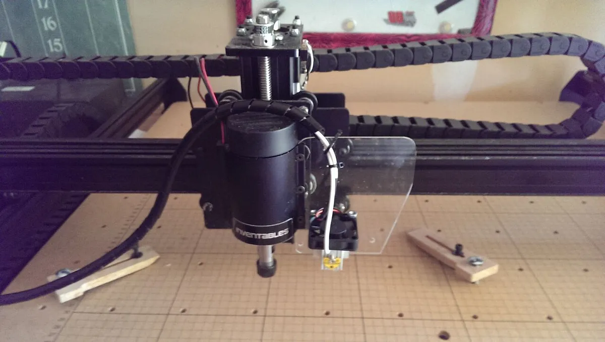

where are the pictures of finished project with laser mounted?
Michael Zawicki · July 03, 2015
Thanks for the feedback. I am not sure why I did not post the final photo. It is uploaded now.
Jeremy Hill · July 04, 2015

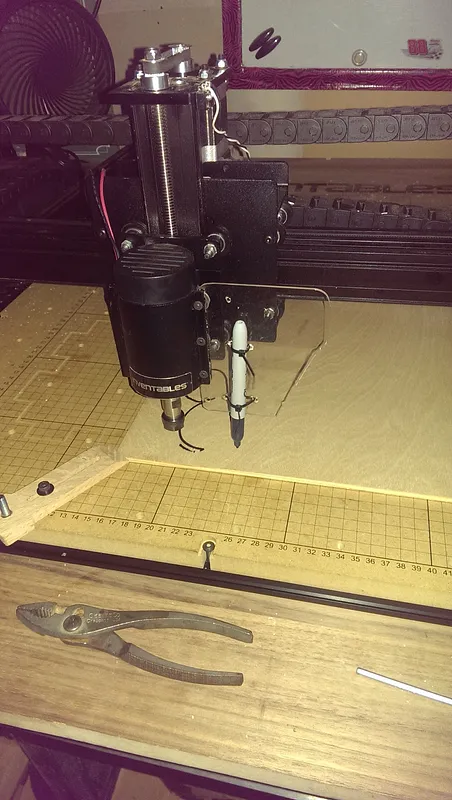

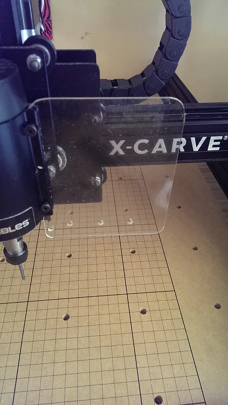

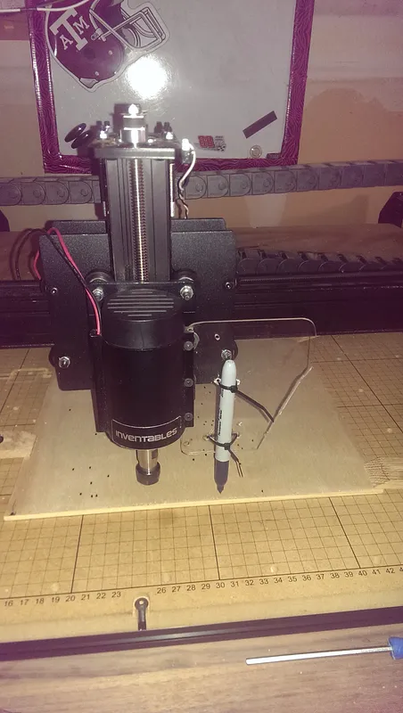

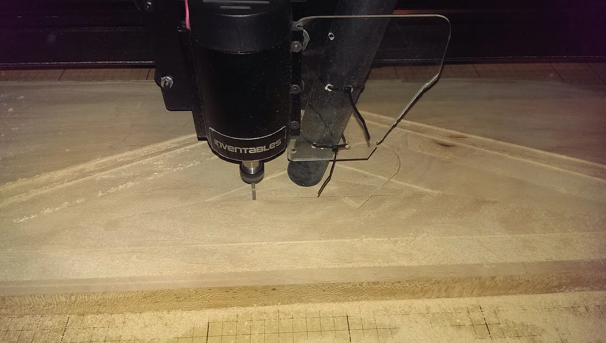

Since the start, I have sanded down he right side a bit more to give me room/movement. I also added a few more holes with a drill bit to install other things. I have now used this setup for a laser, pen, and a vacuum/shop vac hose.
Jeremy Hill · July 13, 2015
