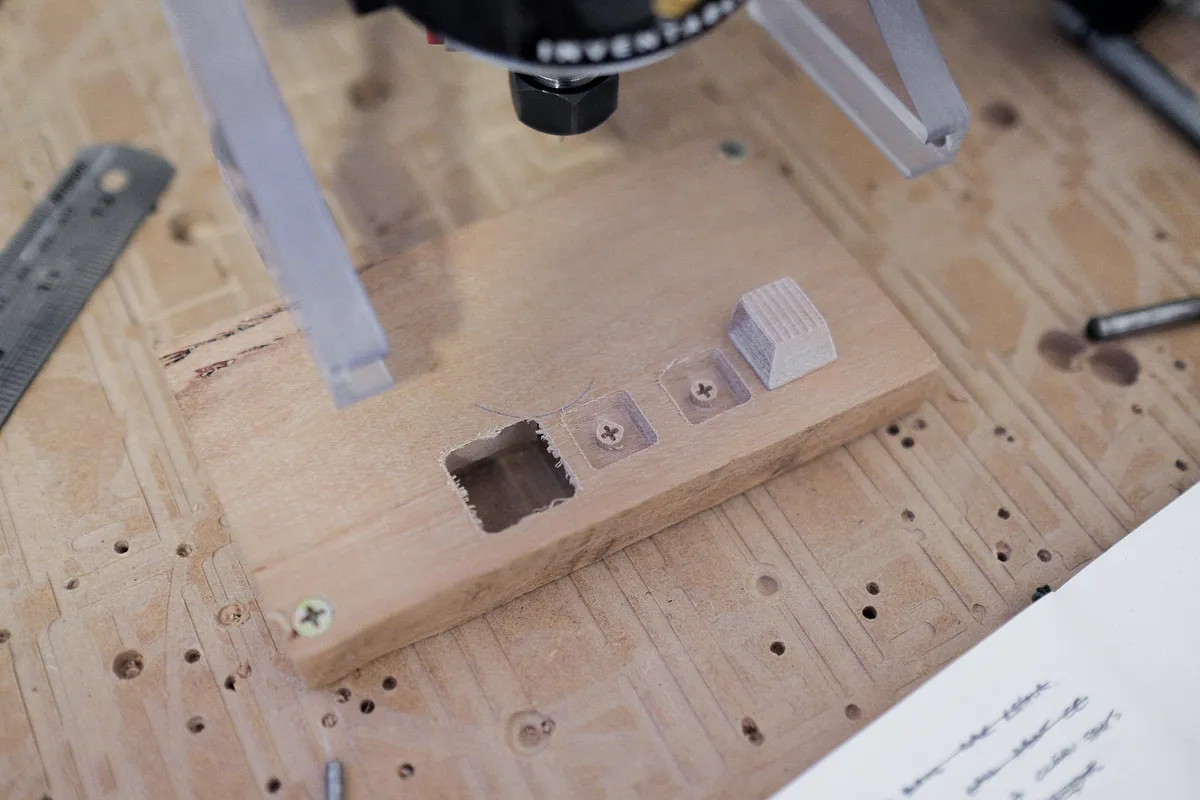

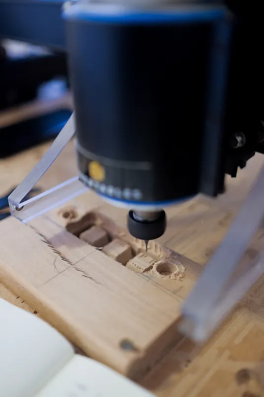

Cut 1 was done with a 1/4 inch straight bit (2 flutes) which cut the bulk of the material and two reference holes which I used dowels in when I flipped the piece (the reference holes were carved into the wasteboard so I did not need to zero once I flipped the timber)
Cut 2: 1/8 inch straight bit (2 flute)
Cut 3: 1mm straight bit (1 flute)
Cut 4 (reference into wasteboard): 1/4 inch straight bit 2 flutes. Dowels used for the referencing were 1/2 inch I believe
Reverse side cut 1: 1/8 inch straight bit 2 flute
Reverse side cut 2: 1mm straight bit 1 flute. Definitely need the finer bit for this pass to allow the stem to fit
