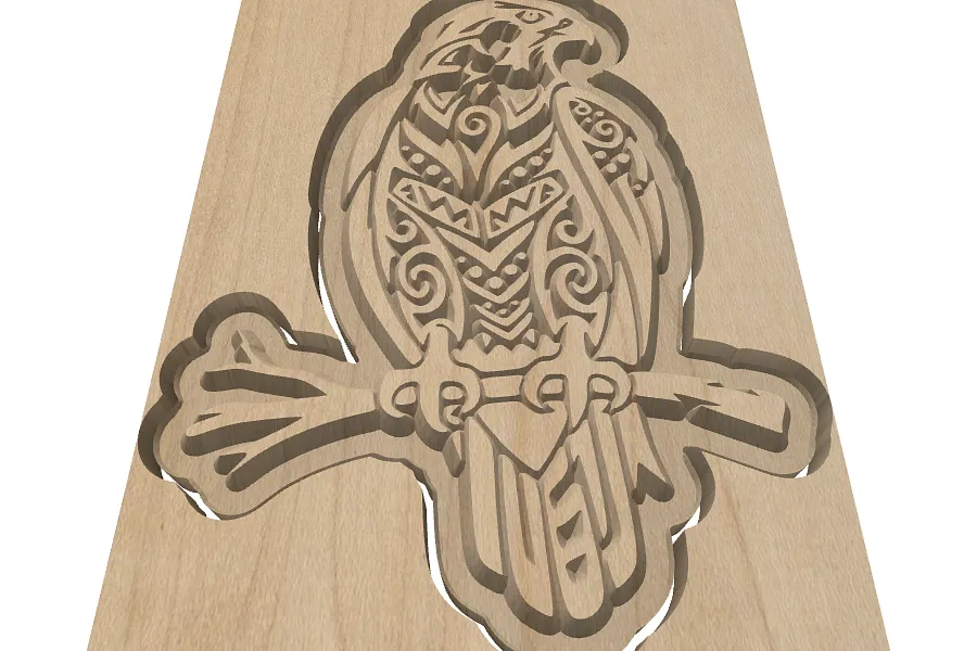

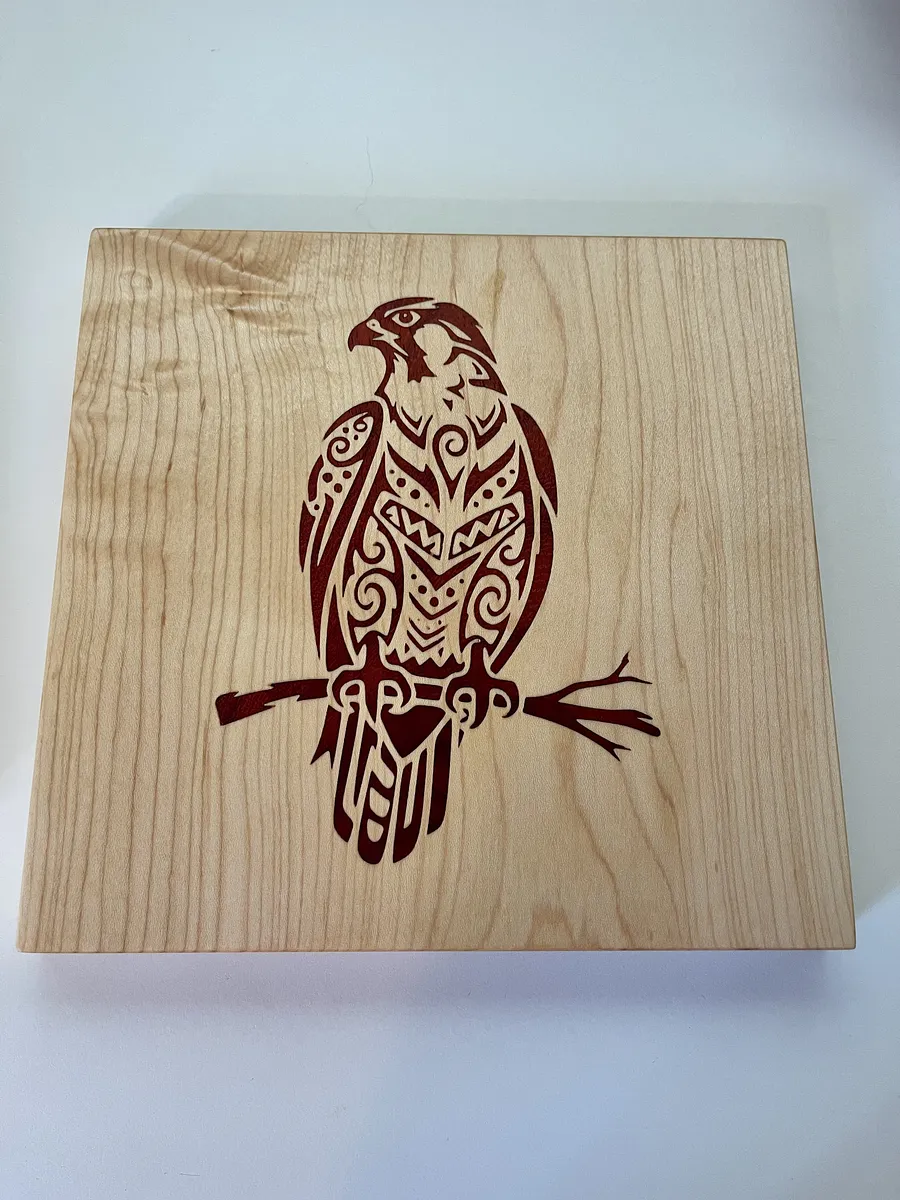

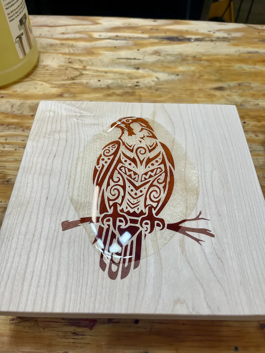

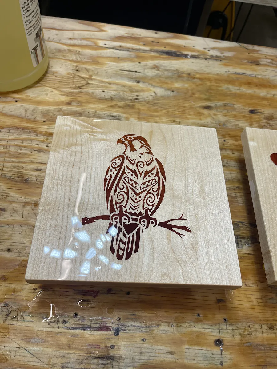

This was experimental. I'd love feedback on this design. I am pleased with results.

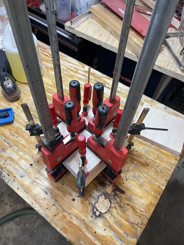

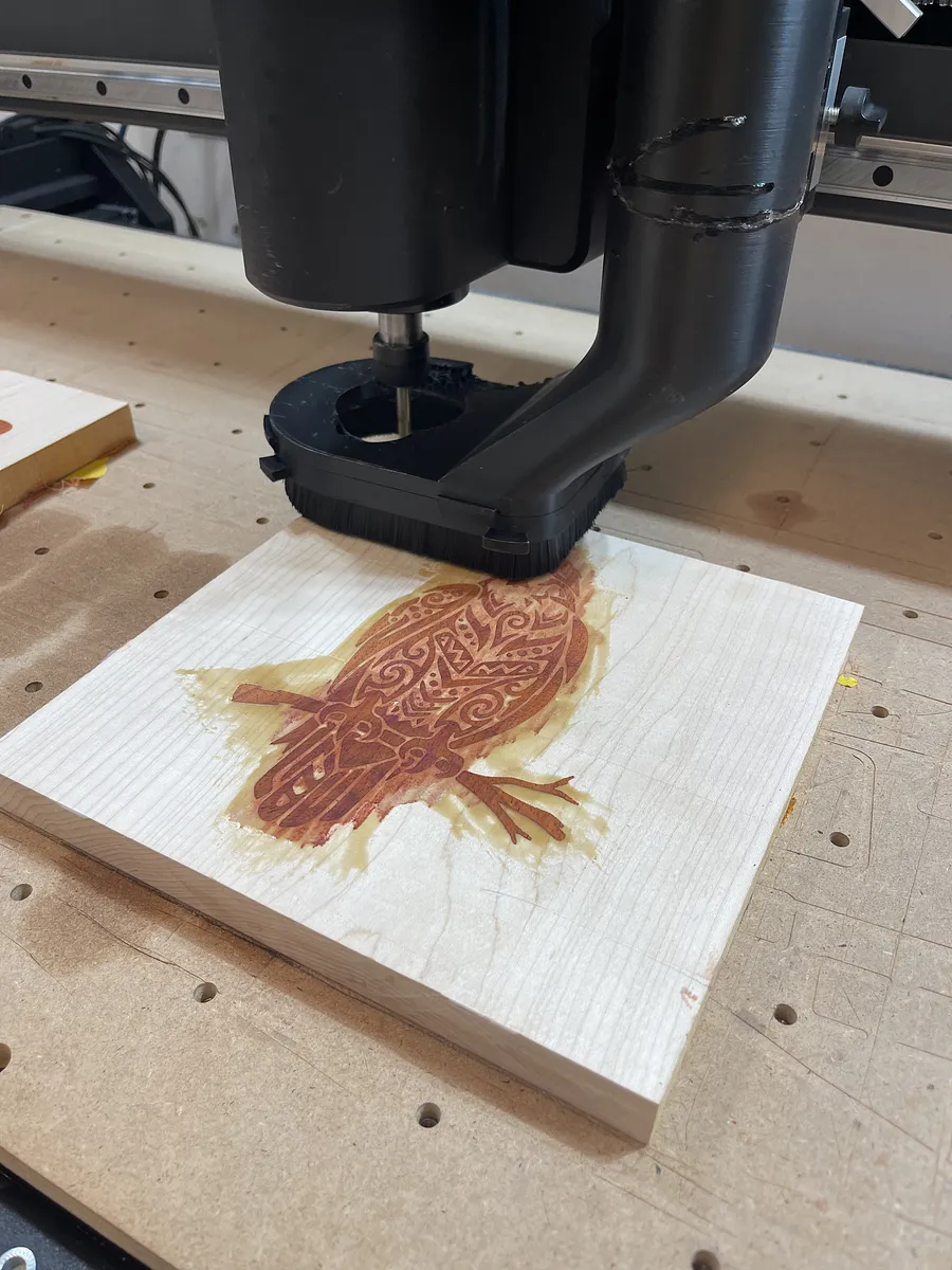

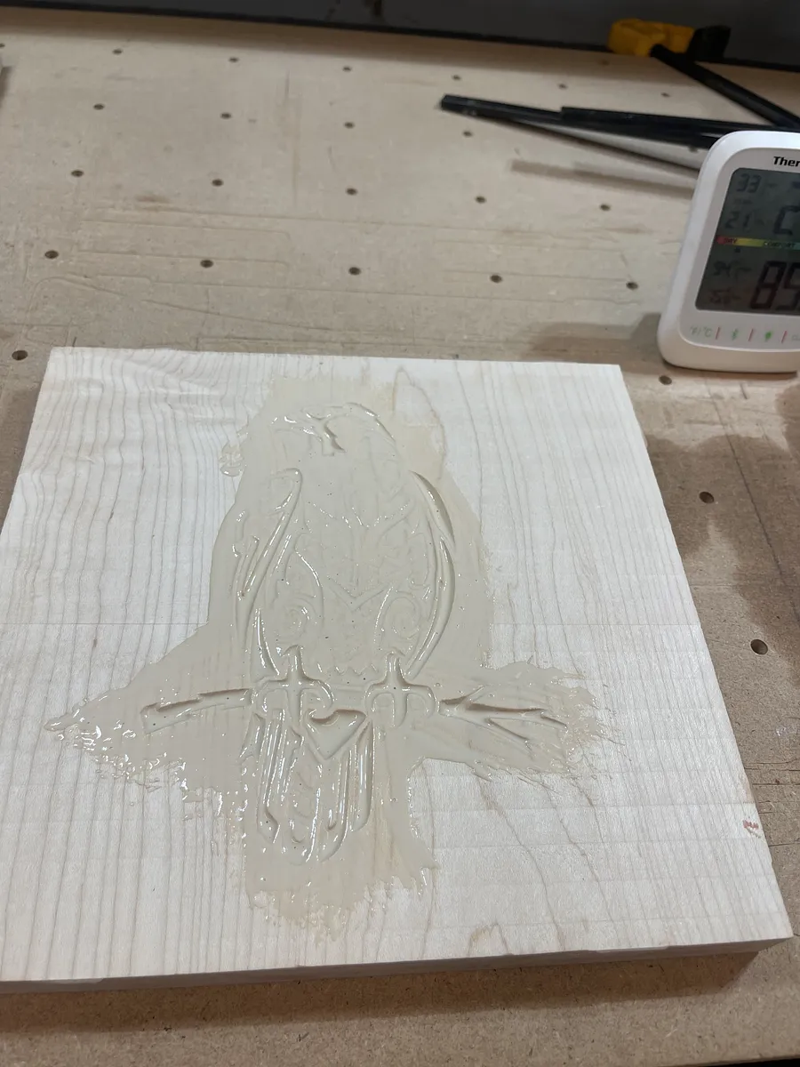

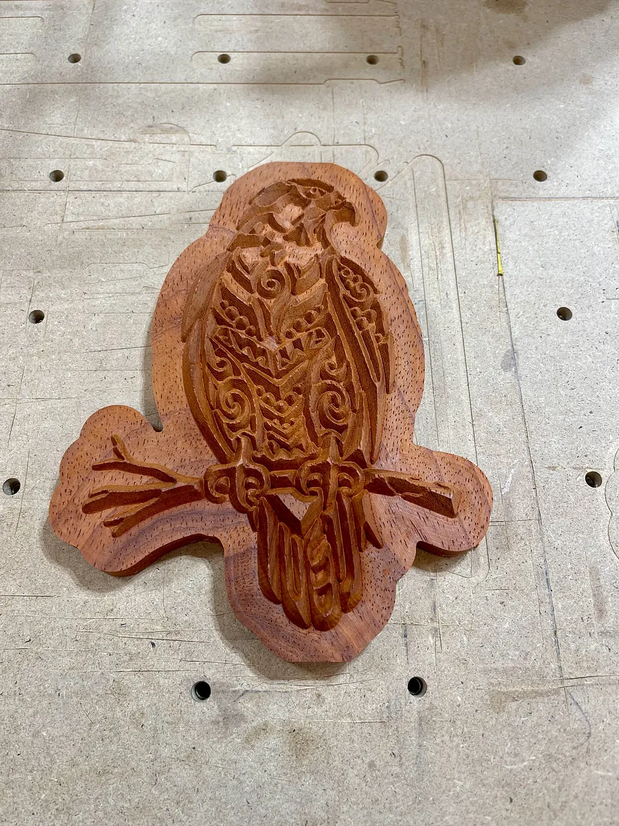

here are some pics of the process

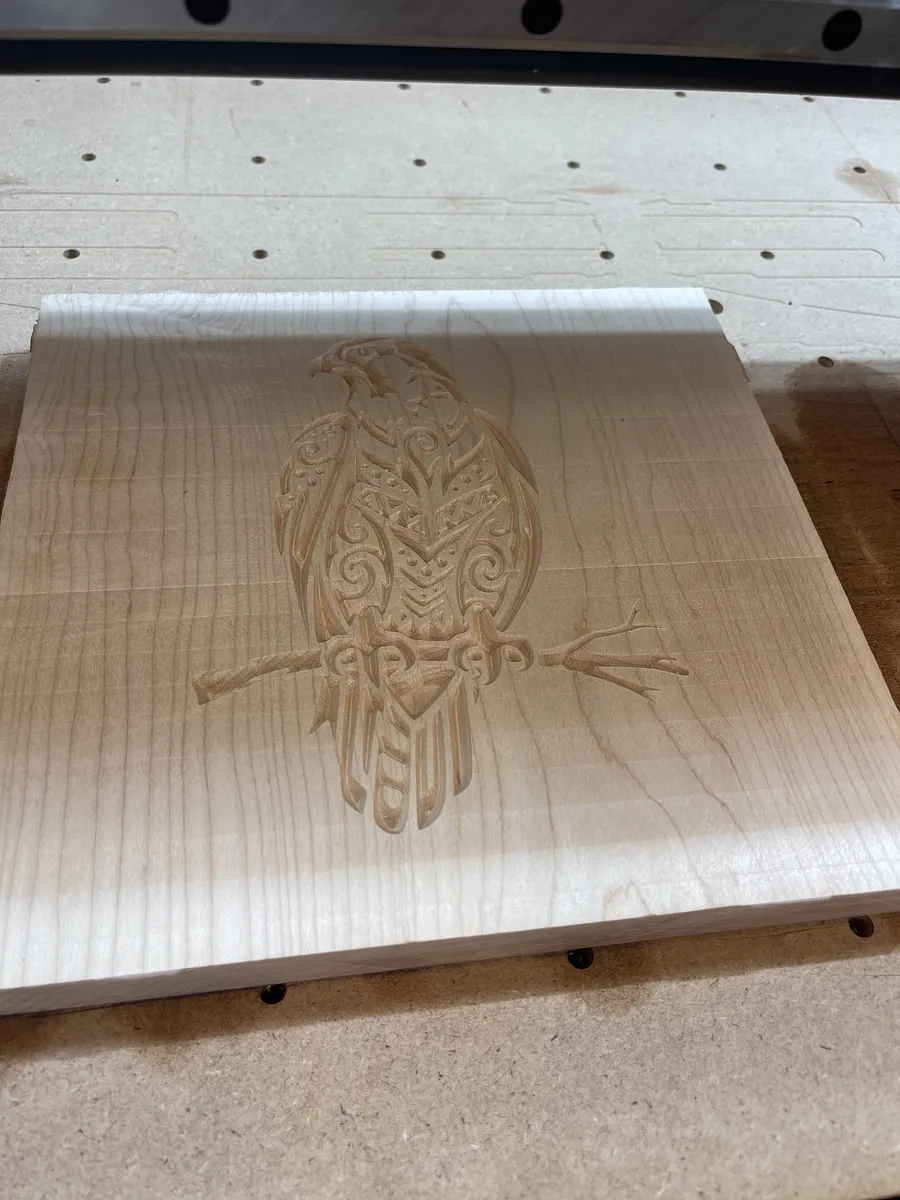

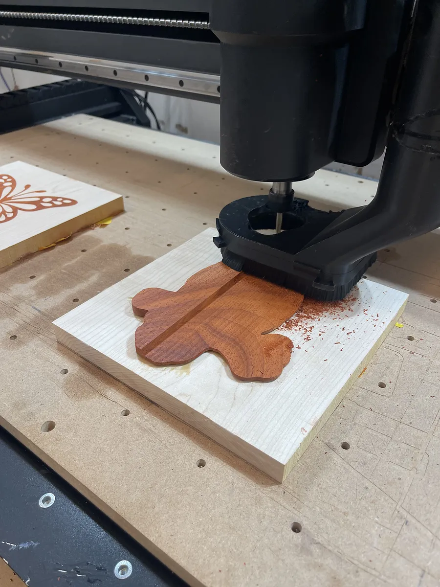

a few more

turned out great!
Jeff TalbotPro · June 18, 2026
WOW!!! That looks awesome!
Natalie SturdyPro · June 18, 2026
Very Well done. Did you use a 30 or 60 degree bit?
John B. WattsPro · June 19, 2026
Looks like a 60 degree bit is setup in the project
Jeff TalbotPro · June 20, 2026
I initially experimented with a 30 degree bit on some basic shapes and did not get great results so I switched to a 60 degree bit and ended up with tighter tolerances
Richard CampbellPro · June 20, 2026
Great design - looks sharp. I have been having same challenges with a 30 degree bit - thought it would allow for better detail. 45 or 60 degree bit seem to work better
