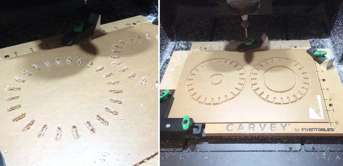

Cut out the rings
We will be cutting the pieces out in 2 steps, first the slots and then the outlines. This is because we are using 2 different bit sizes to save wear on the smaller 1/16th bits that are needed for the slots.
Measure the exact thickness of the translucent white acrylic (or whatever color you’ve chosen as the primary color), and set the Z value to this measurement as well as the cut depth.
Using double stick tape, firmly secure to the acrylic to the wasteboard.
You will first cut out the slots in "this file":http://easel.inventables.com/projects/ZRDxpKEgYEQammBoYQkyow and then outlines in "this file":http://easel.inventables.com/projects/lZZpwAyD4VTz6404v0UxvA using a 1/16 2FL fishtail bit (blue ring). Leave the material on the board, and cut out the shape outline in this file using the 1/8 1FL straight bit (black ring).
Mill one sheet.
Estimated time: 25 minutes
Modern Hanging Lamp — Cut out the rings

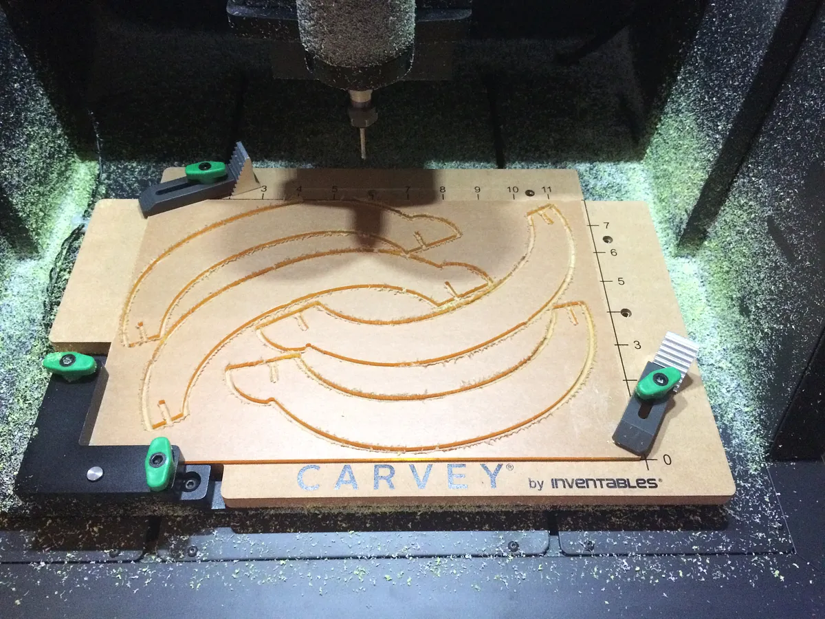

Mill the large rib pieces
Mill the large ribs using your main lamp color. Remember to measure your material and adjust the Z-value and cut depth accordingly.
First cut the slots using "this file":http://easel.inventables.com/projects/qjdXEa6v7j-irE9SnaEazg with the 1/16th bit, leave the material secured to the wasteboard and then cut out the outlines using "this file":http://easel.inventables.com/projects/fojHcEp0tnZjBuWrM0308Q and the 1/8th bit.
Mill 6 sheets of the large ribs for a total of 12 pieces.
Estimated time: 90 minutes
Modern Hanging Lamp — Mill the large rib pieces

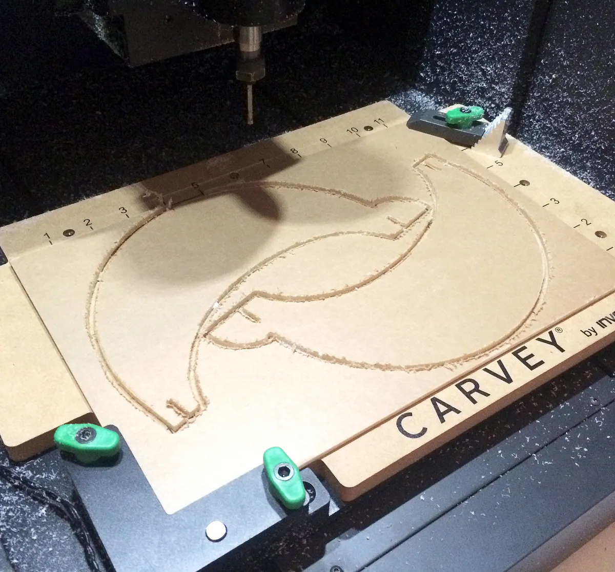

Cut out the small rib pieces
Mill the small ribs using whatever color you would like the core of your lamp to be. Remember to measure your material and adjust the Z-value and cut depth accordingly.
First cut the slots using "this file":http://easel.inventables.com/projects/plgOI-ArBhhNkZQCD-s9Ag with the 1/16th bit, leave the material secured to the wasteboard and then cut out the outlines using "this file":http://easel.inventables.com/projects/F0Cuarm-ZMxeULaT8a3Akw and the 1/8th bit.
Mill 3 sheets for a total of 12 pieces
Estimated time: 60 minutes
Modern Hanging Lamp — Cut out the small rib pieces

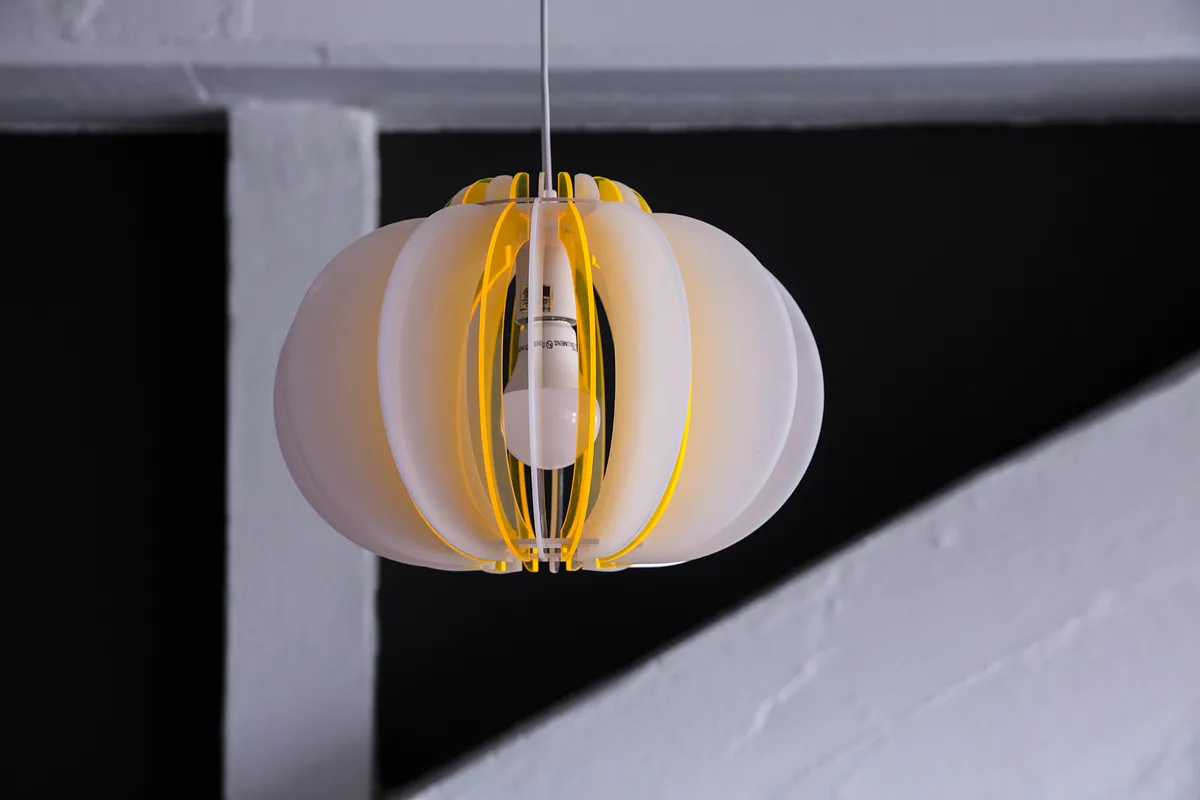

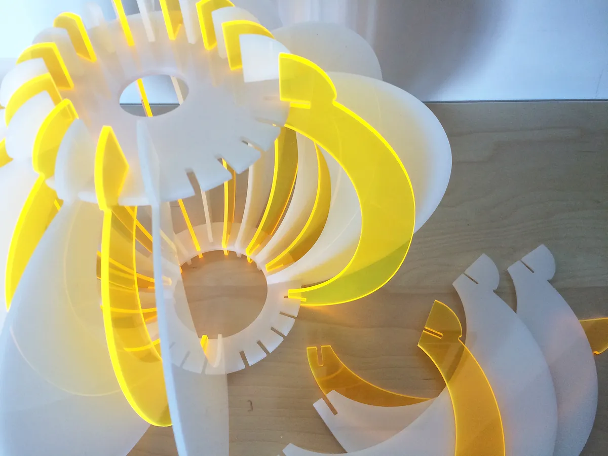

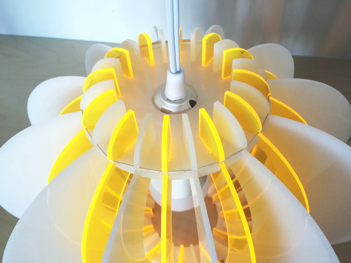

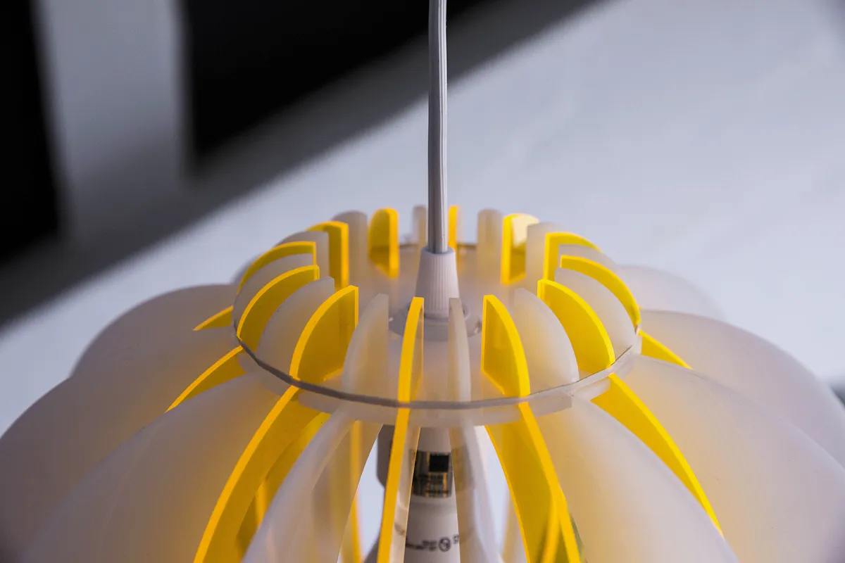

Assemble the pieces
The circle with the smaller center is the top of the lamp, and connects with the end of the ribs with the extra bump. Insert the slots on the ribs into the slots of the circle, alternating large and small ribs.
Once all the pieces are put together, stretch a rubber band or a hair tie around the top of the lamp, and fit it into the small divot at the top of the ribs. this will keep the pieces from falling apart.
Estimated time: 10 minutes
Modern Hanging Lamp — Assemble the pieces
Modern Hanging Lamp — Assemble the pieces (image 2)
