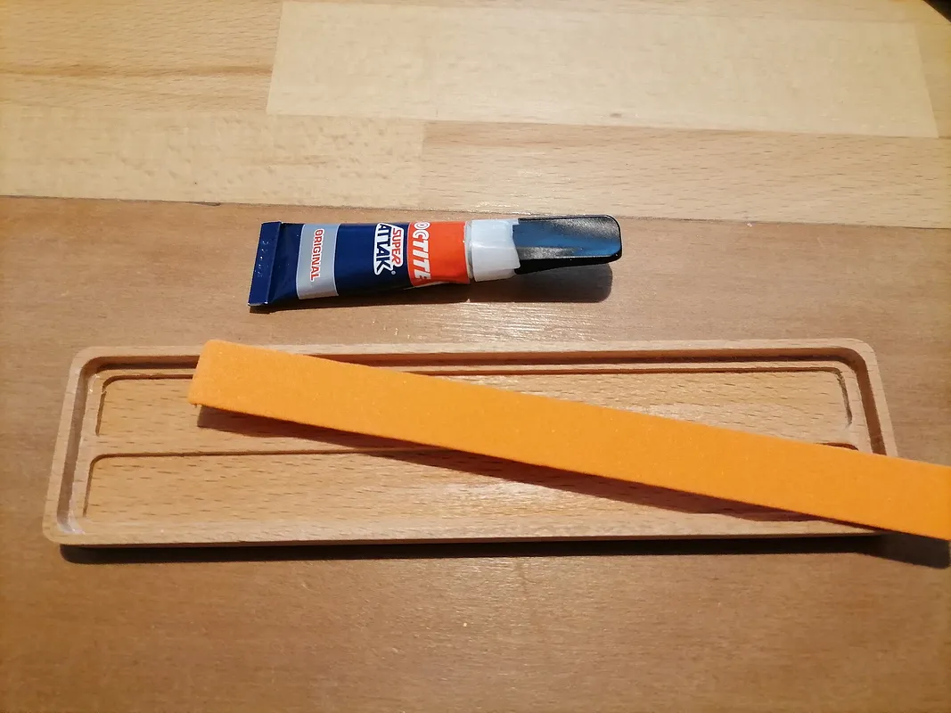

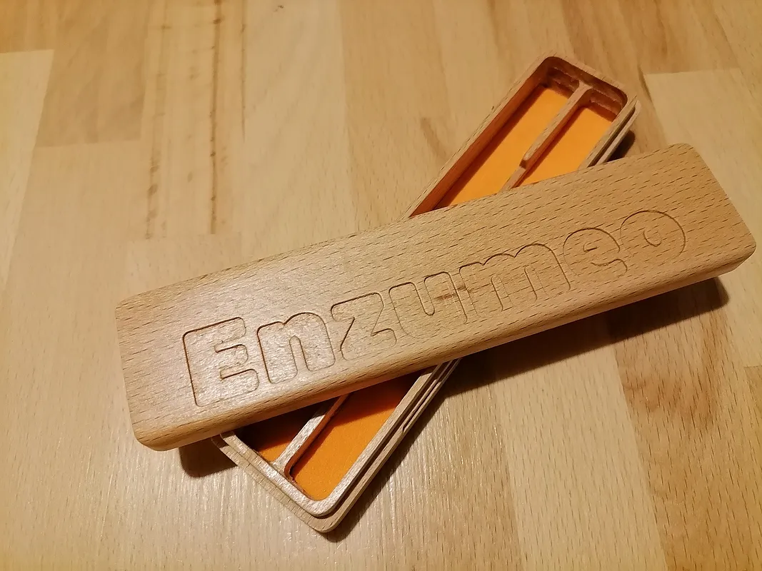

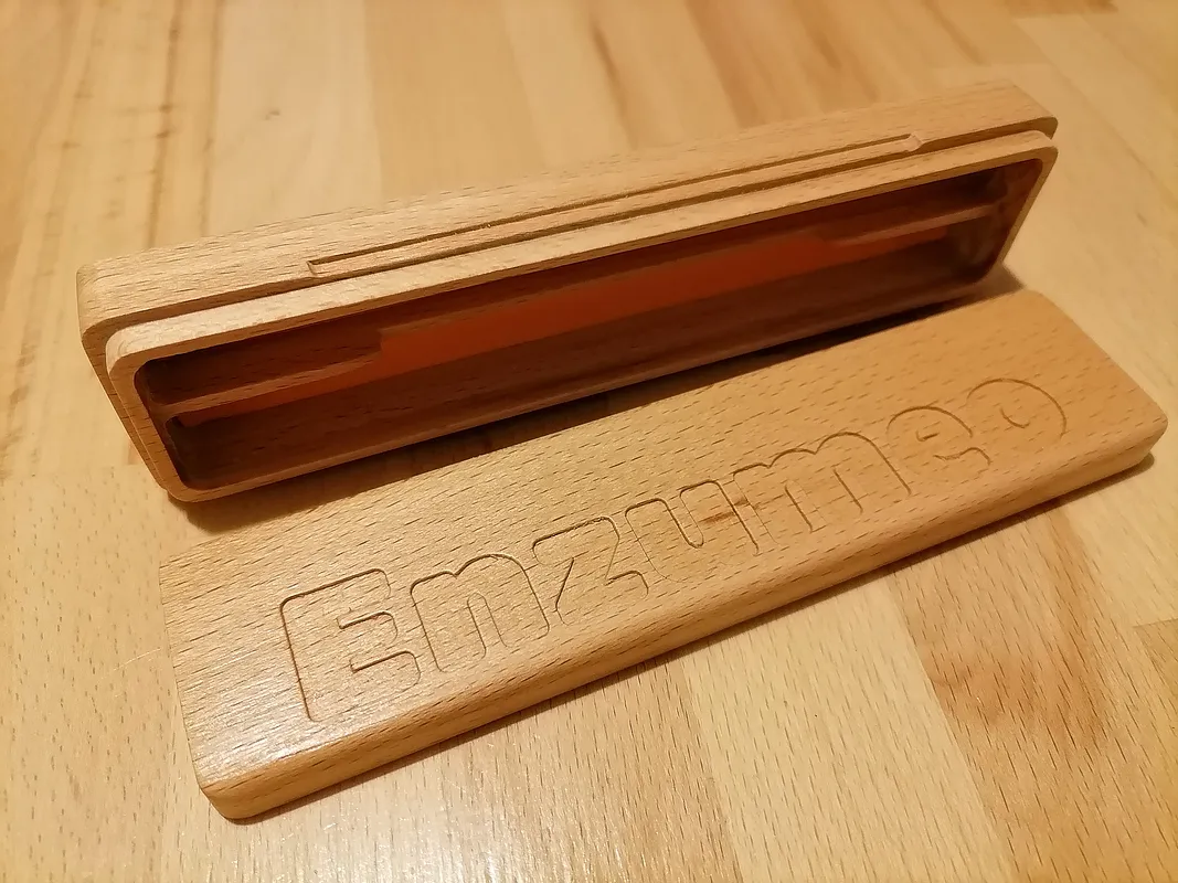

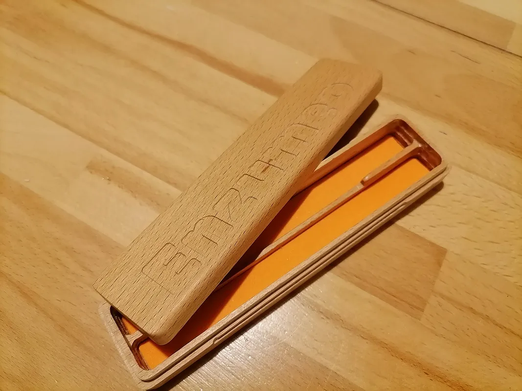

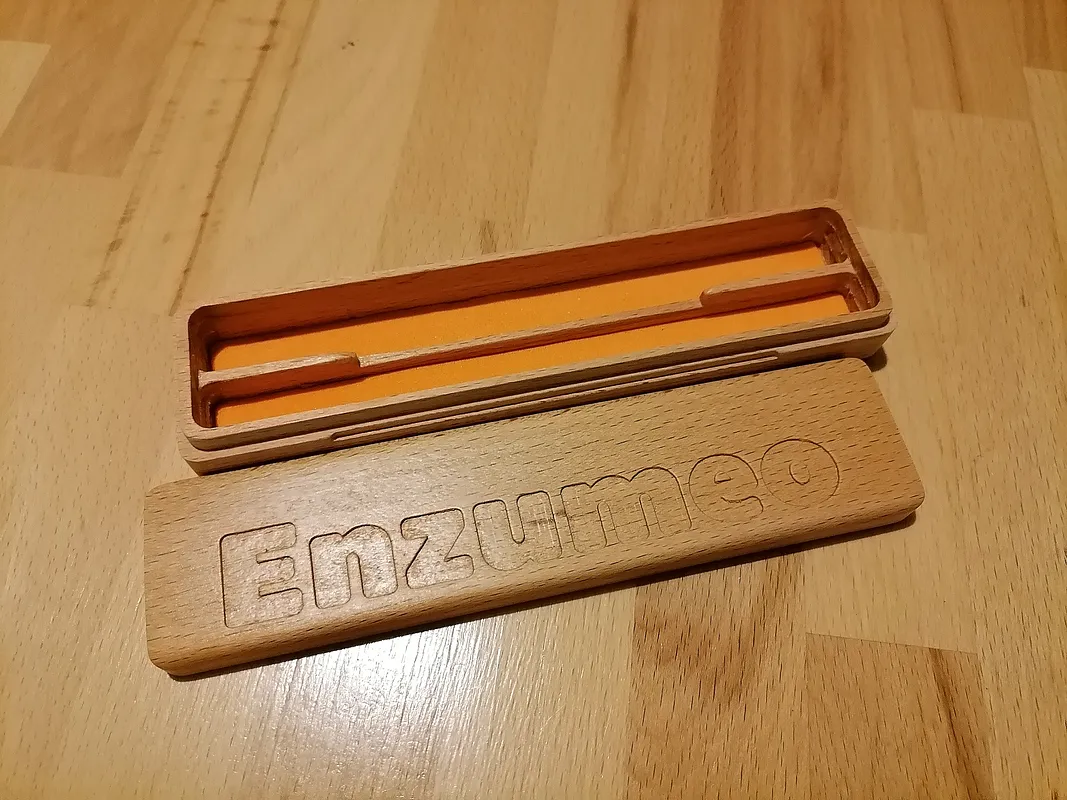

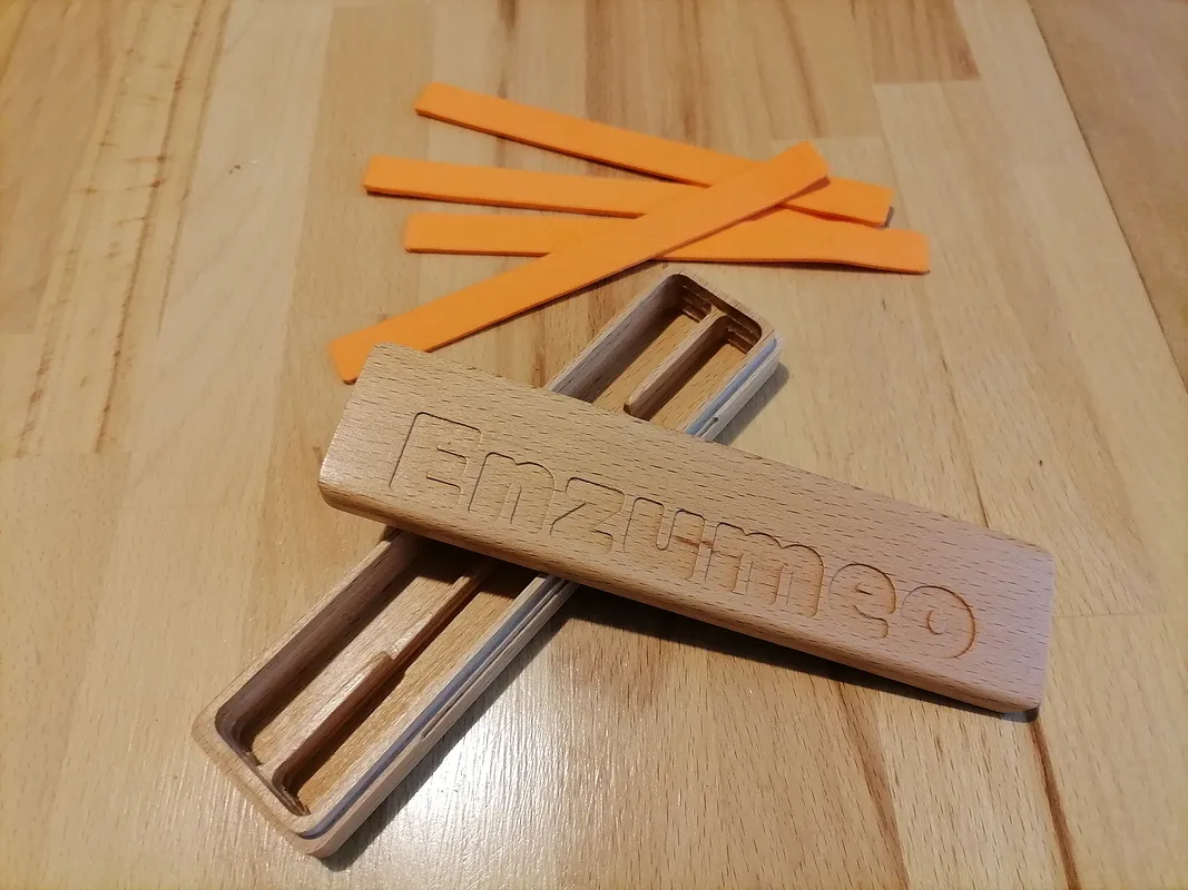

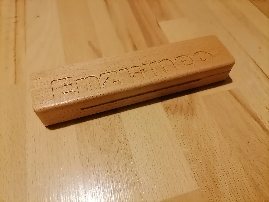

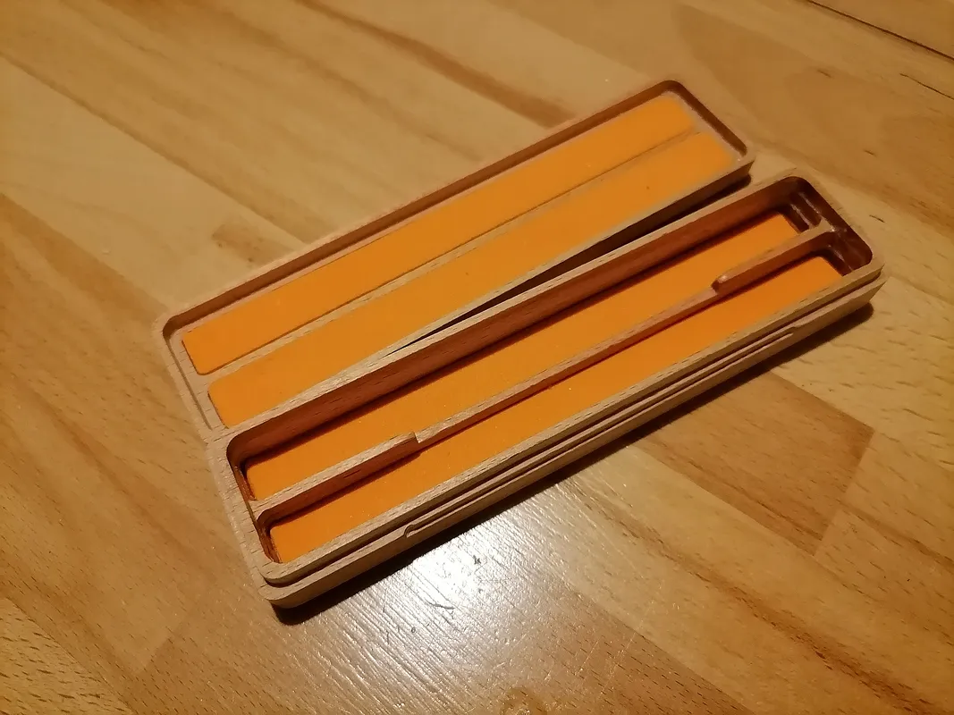

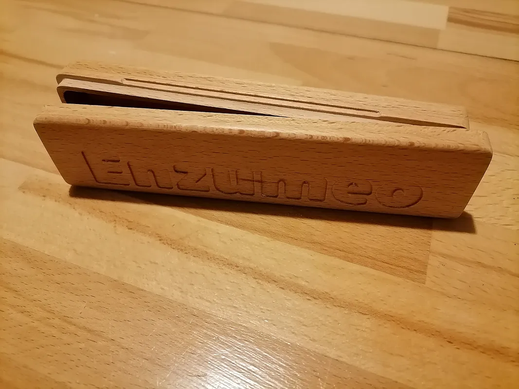

A pen holder in beech wood strips made with cnc 3018. "Enzumeo" in Sicilian means "Enzo mio". Various 5mm beech strips is glued together and 2mm foam inserts. The corners were rounded off with a plane. The product was smoothed with a belt sander, painted whit spray, smoothed with 240 grit paper.
