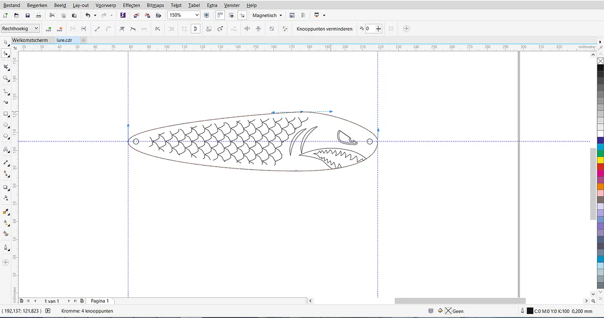

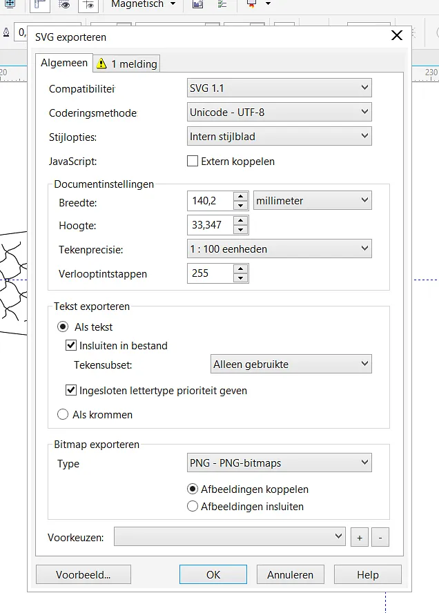

Sketch out your design (or you can use this design). When you are happy with it recreate it with a Vector program like Coreldraw, Illustrator or "Inkscape":https://inkscape.org/
Estimated time: 60 minutes
Export to .SVG and bring in to easel
When you are done with your design export it to .svg and import it into Easel. I scaled down my design because it was a bit to large.

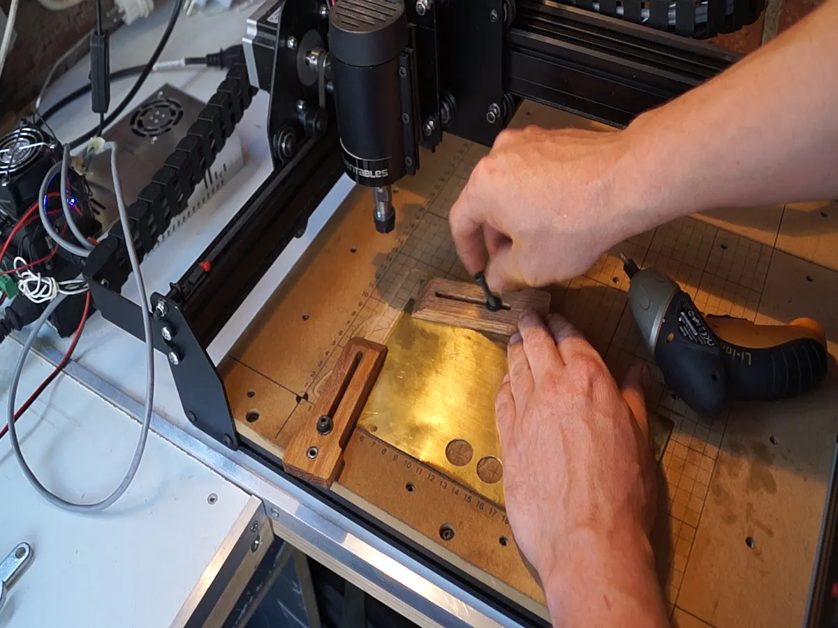

Clamp Down material tighly
Make sure to clamp down tightly and that your stock it flat to the waste board. mine wasn't completely flat and almost engraved to the brass. Take your time to measure and clamp down your material.
Estimated time: 2 minutes

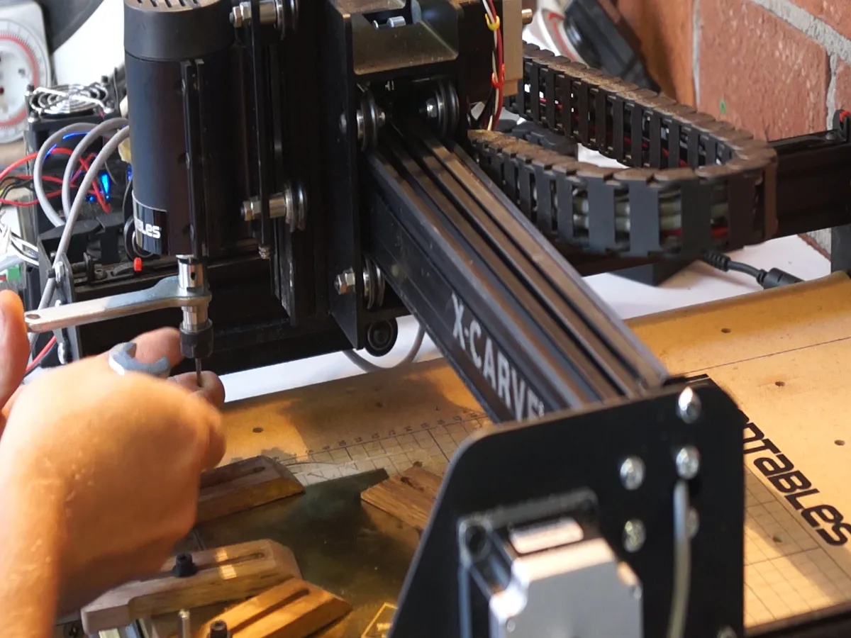

Home the X-carve and hit start
Make sure you cool your bit with cooling fluid.

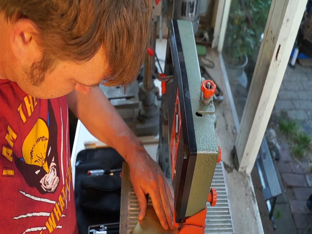

cut free and file edges
Release your clamps and if necessary cut your design free with a band saw or tin scissors. i changed the file so it does'nt cut trough the brass anymore but engraves it to a depth off 0.7mm, you should be able to push the lure gently out.
Use sanding sponge, file or band sander to clean up the edges. you can also give the surface a quick sanding with a sanding sponge but it is not necessary.
you can also drill out the holes if necessary.

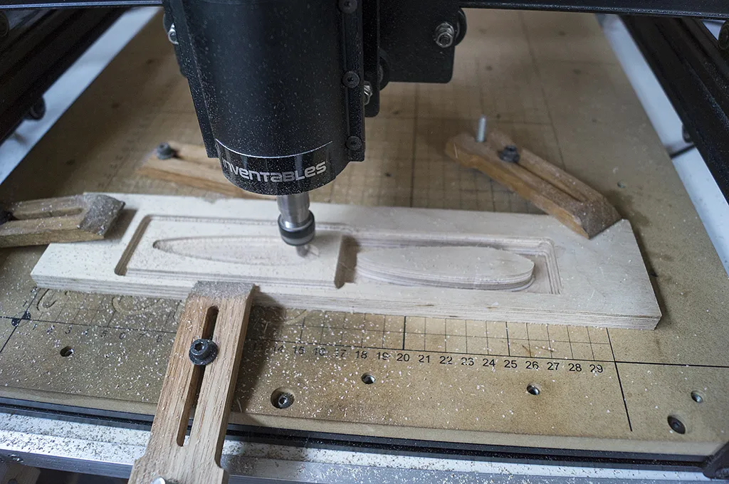

Clamp down your stock and home and start the X-carve.
I used a ball-end 1/8 bit to get more smoothing edges but any (wood) bit will do.

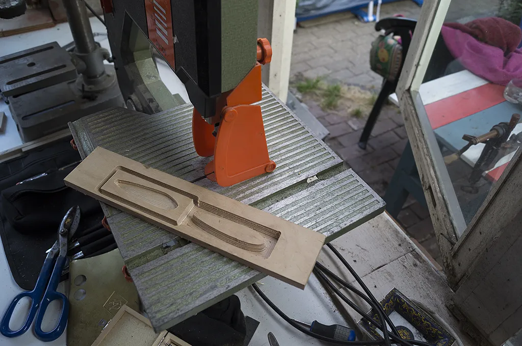

When the X-carve is done saw free molds ( i changed the design to the positive part has a backside, so it is easier to clamp)
Making the shape Mold

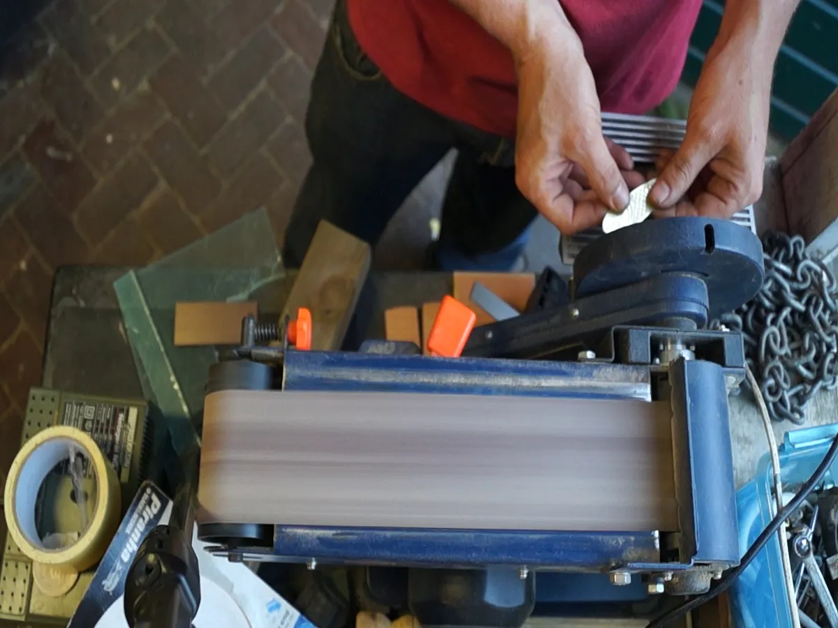

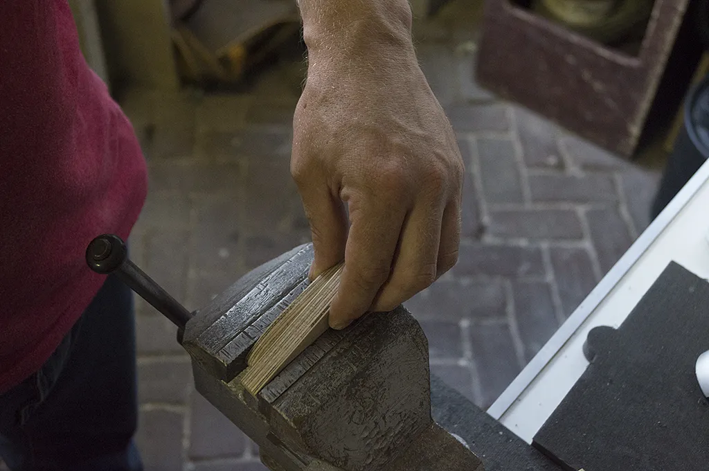

Use a belt sander or sandpaper and files to shape to positive mold part to a nice curved dome. Use a fine sandpaper or the fineside of a sanding sponge to smooth the dome when you are done shaping it.
we going to use this to give the brass a curvature so it is stronger and catches the light better.

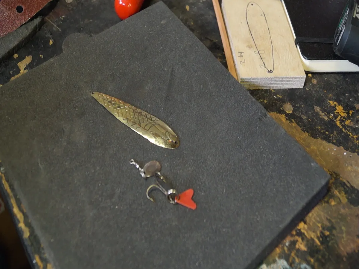

using the mold to shape the brass
Cut a piece of (16mm) EVA foam to fit in the negative mold, you can use the positive mold to trace the out line. if you don't have EVA Foam you also can use cloth or leather.
(note: you can also use the X-carve to cut out the Eva foam using the positive mold design (delete the negative piece and replace the positive)
Cut the Eva foam flush with the top of the mold.

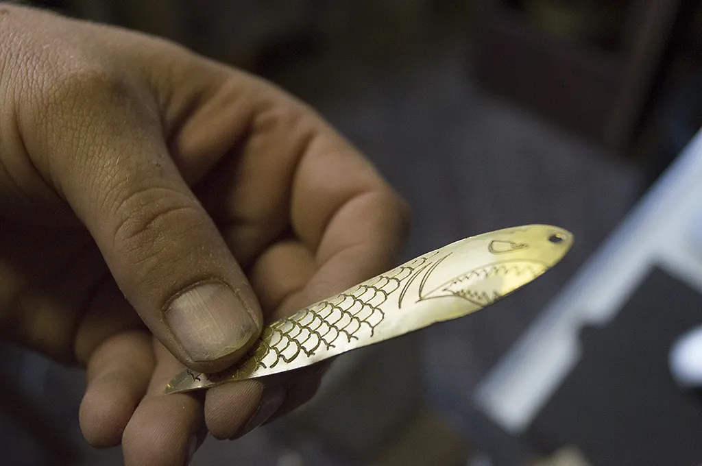

put your brass lure on top of the EVA foam with the engraving facing down
put the positive mold with the dome side down, facing the brass, on top of it. (you can use a rubber band to keep it together if you like)

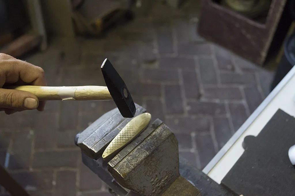

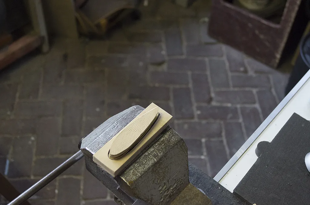

Use a Vice to clamp your assembly together put some force on it but be careful that you don't break the mold. repeat this step if necessary. your lure should have a nice rounded curvature.
Clamp your positive mold in the vice facing up and use it as an anvil to tap the lure in shape if needed. be careful not to damage the lure it self.

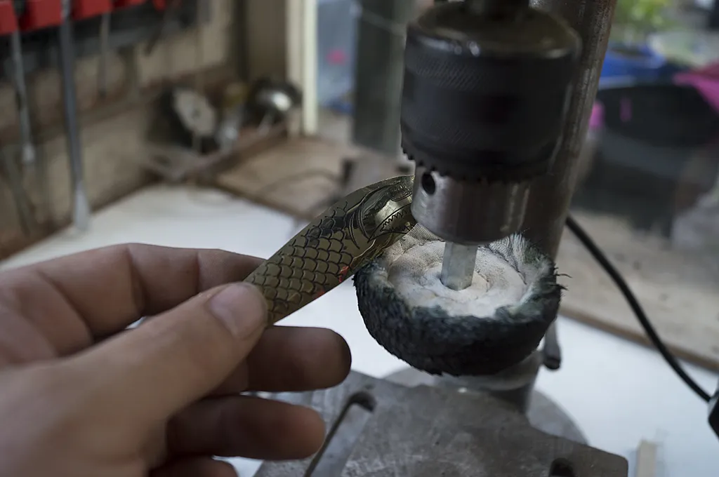

Use a polishing machine or a drill press with a polishing tool to polish your brass to a high gloss finish. you can also use increasingly finer sandpaper to accomplish this.

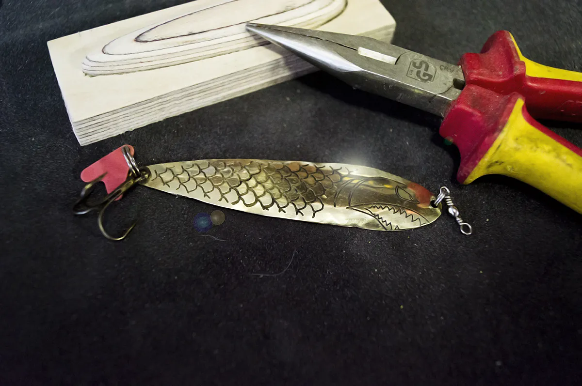

Attach the hook and eye to the lure
Use the hook and a eye from a old lure (or buy new ones) and attach it to the brass lure using needle pliers. you can cut a piece of thin (colorfull) plastic to cut a tail as a tail if you like.
