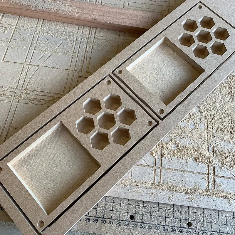

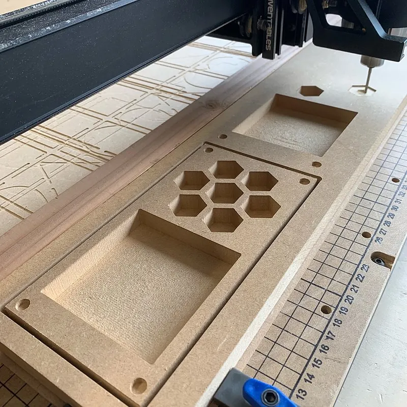

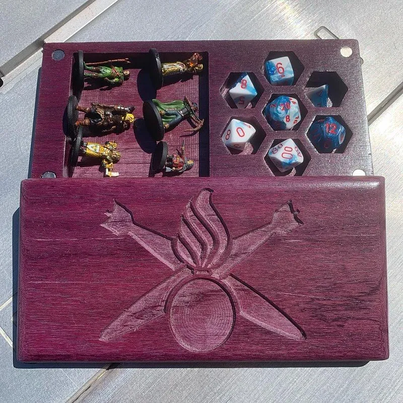

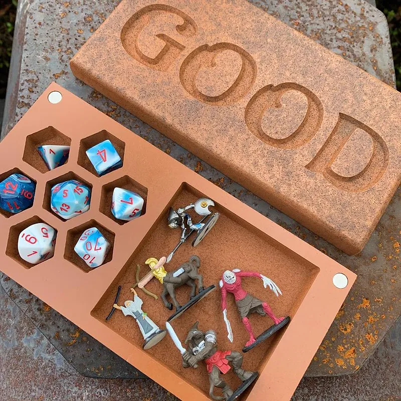

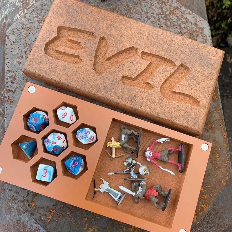

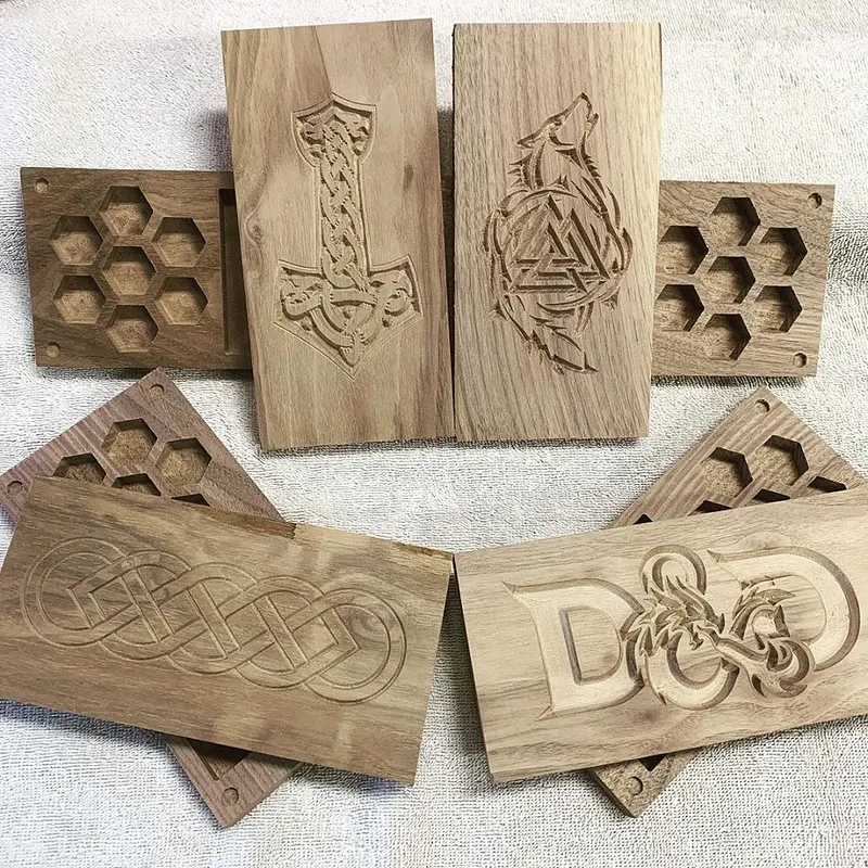

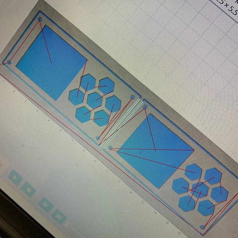

I've made these from 3/4" UMDF, Black Walnut, and Purple Heart Wood so far. The shallow holes in the corners are for 8mm x 3mm magnets (available on Amazon) to hold the two pieces together. I rounded over the outer edges on my router table. I've also carved designs on the outer halves as well.

Is the underside of the lid just flat?
Kurt Canez · February 03, 2020
No. The lid is a mirror image of the bottom. Each half is 3/4” think, and carved 1/2” deep, giving a 1” space when closed, and allowing you to do a 1/16” or 1/8” deep carving in the outside of the lid, for decoration purposes.
