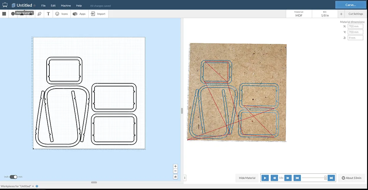

Machine the parts on your x-carve using the beautiful and intuitive software provided by Easels.
Estimated time: 60 minutes

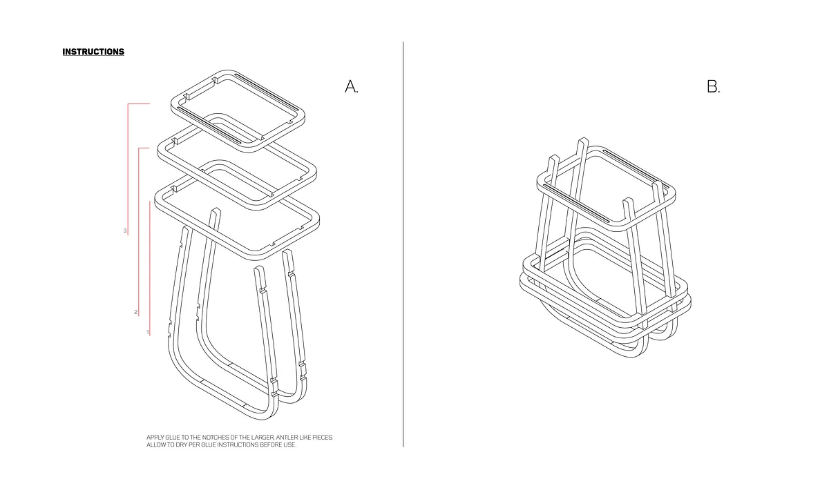

Assemble
Put together the machined parts as shown in the attached image.
Estimated time: 15 minutes
You should use plywood for your design instead of MDF. For the rings to fit around the large "U"s you have to flex them bit, mdf is not flex resistant at all so it might break.
Antonio Hernandez Menchaca · July 11, 2018
Thanks Antonio, I certainly considered using ply, but I felt like with such a wire-frame structure I would want the form to blend together a bit through the materials and plywood has such strong 'direction'. As inflexible is, the part should have more than enough give to allow assembly.
AJ Cox · July 12, 2018
