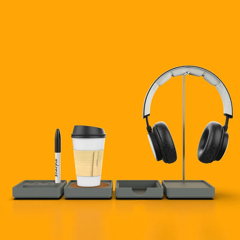

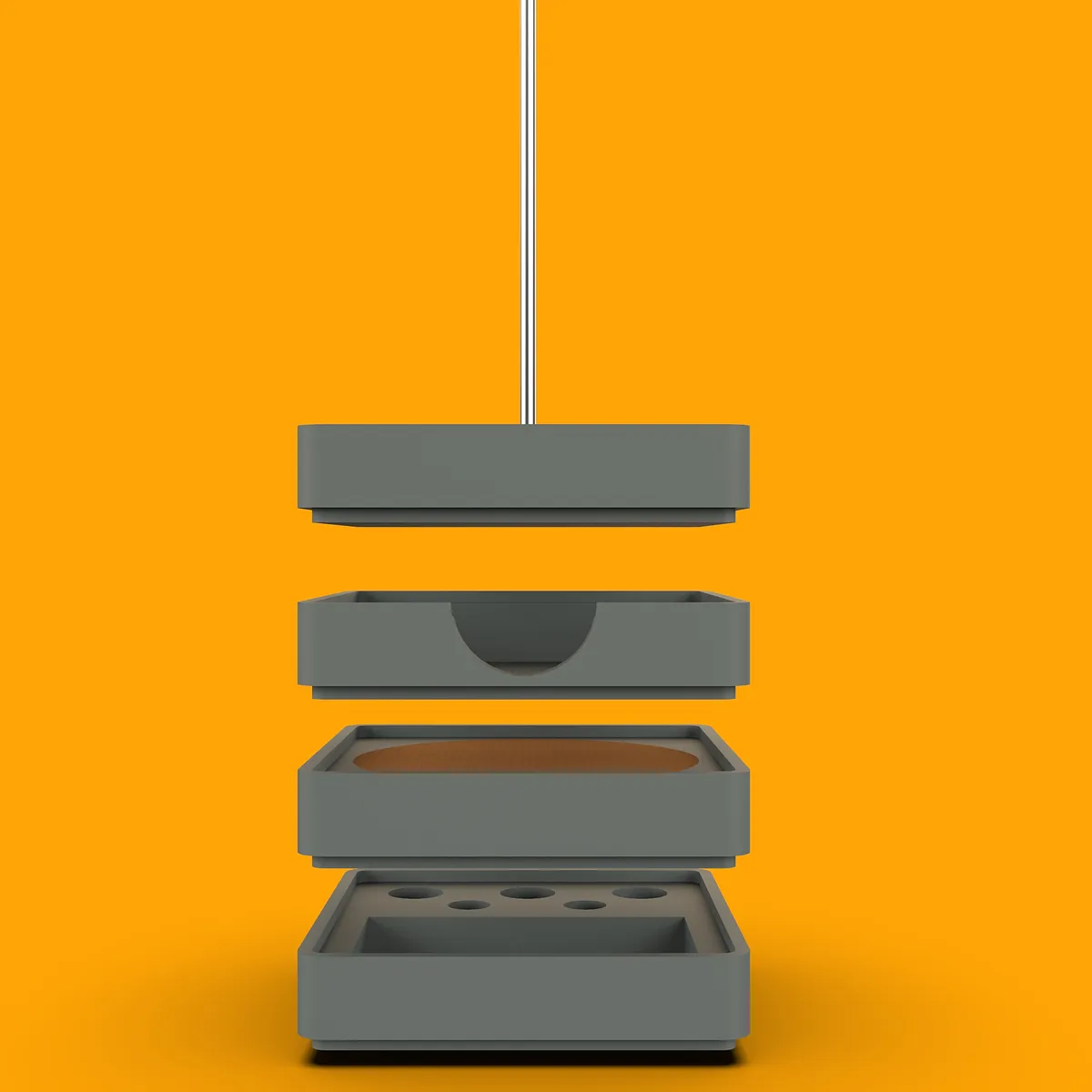

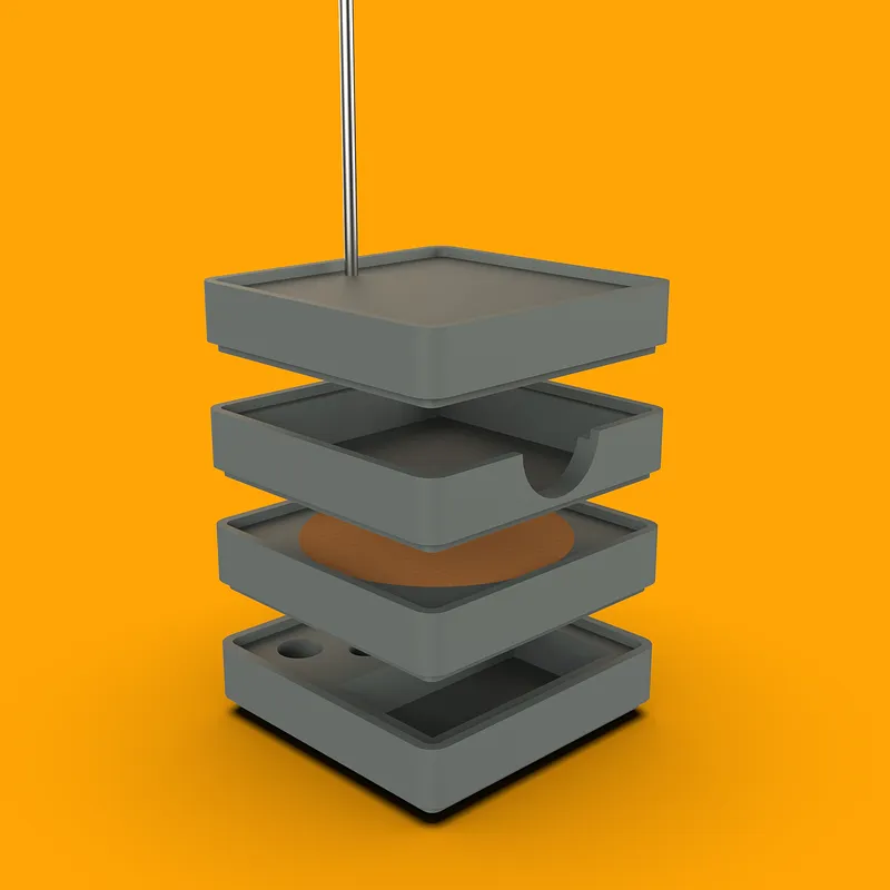

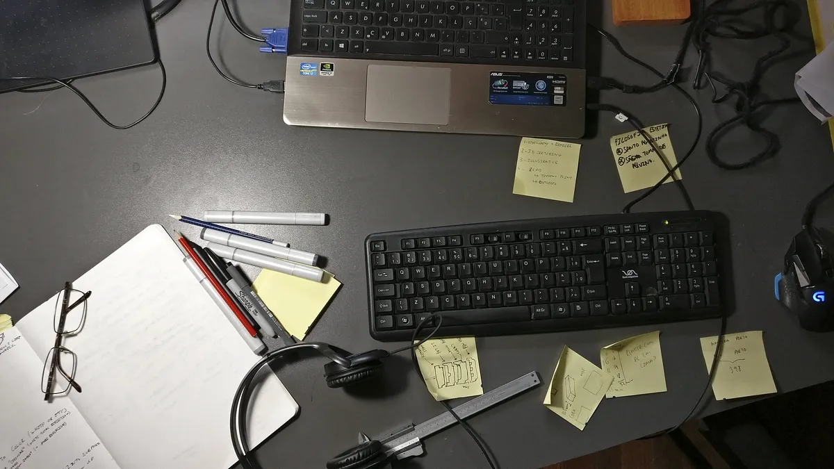

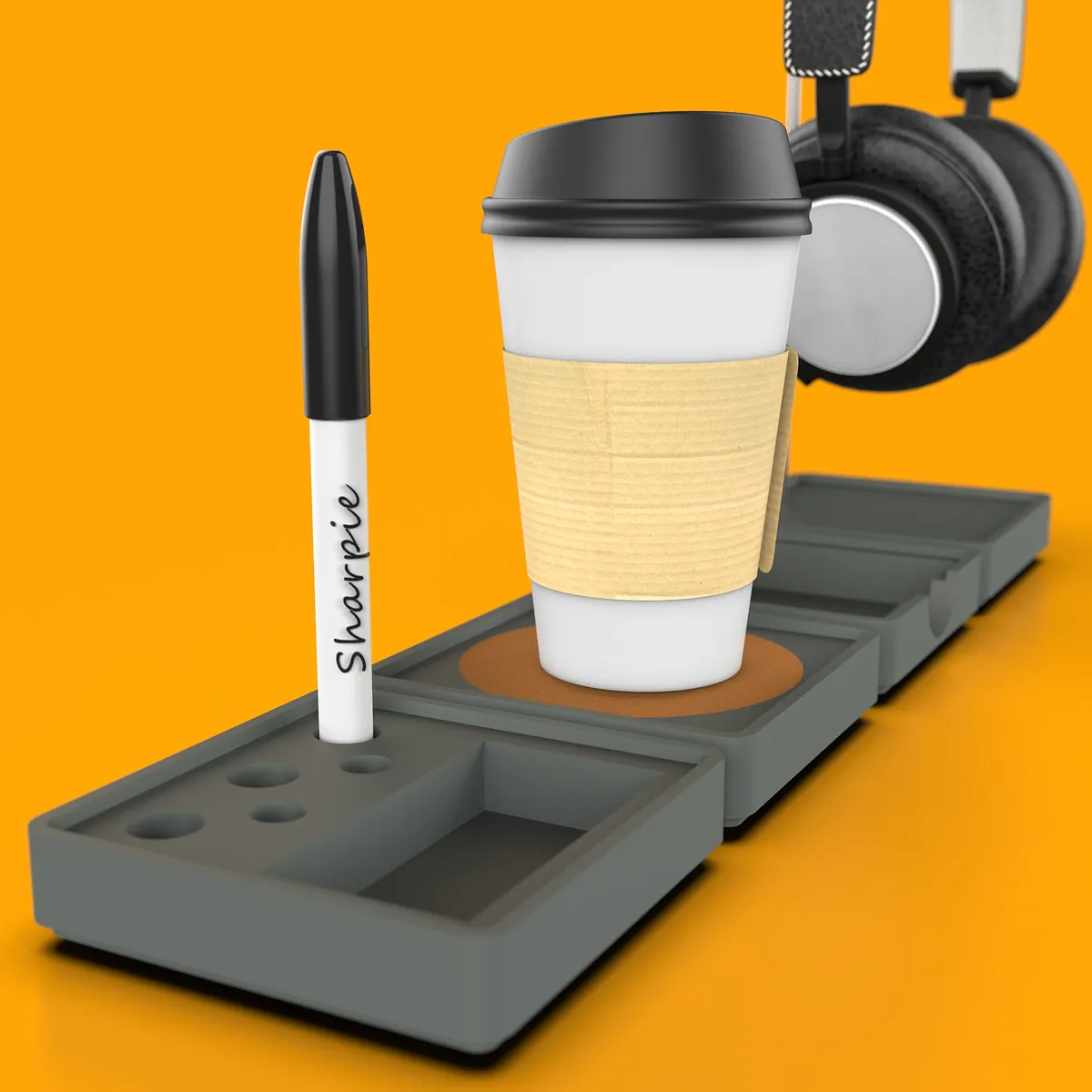

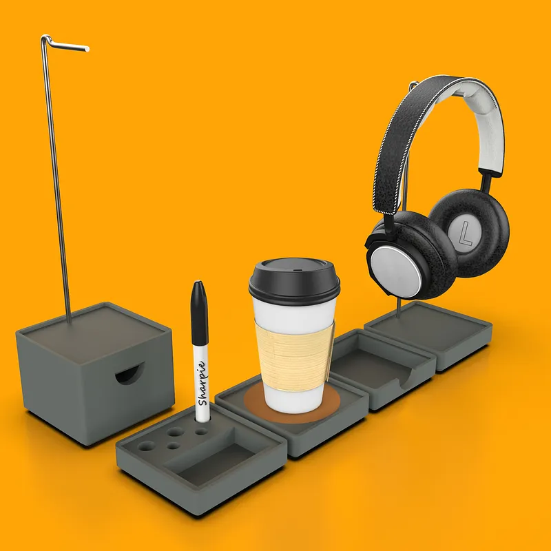

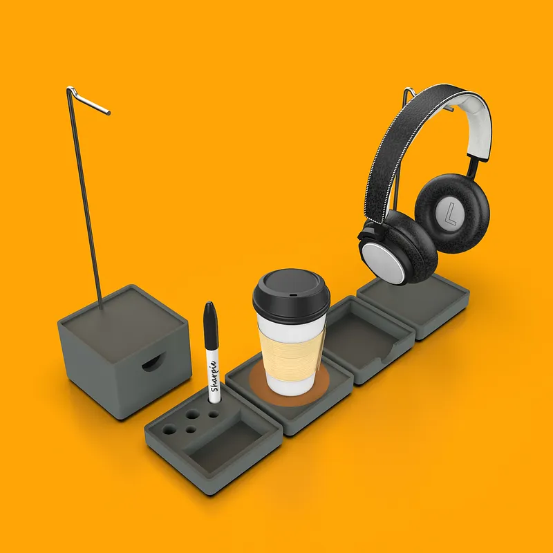

As soon as I finished my first project I came across with a problem, my desk was a mess! This gave me an idea, if I have this problem many more have it too, and so my second project was born! A stackable desk organizer to unclutter your desk, that goes along perfectly with your computer stand: "https://www.inventables.com/projects/computer-stand This organizer has a tray four trays, one for markers, Coffe cup, Post It and Headphones. Unfortunately I didnt have the time to prototype this project but as soon as I try it at the local Fablab I'll post some pictures and more details. Feel free to play around with mdf and acrylic colours or using some hardwood for this project, would love to see some of the results.
Extra BOM: - Smooth Rode 4mm diameter x 300mm - 20mm coloured or regular mdf (Only if you don't want to glue boards together) - 10mm Cork board (If you use it for the legs on the Computer Stand you have some scrap that is perfect, otherwise de 12.7mm acrylic sold at the inventables shop works perfectly as a heat insulator and alternative)

Nice design composition which relaxes my mind knowing that important things have an organized place to rest. Where does your phone get placed? -David, Legacy Architecture Studio
