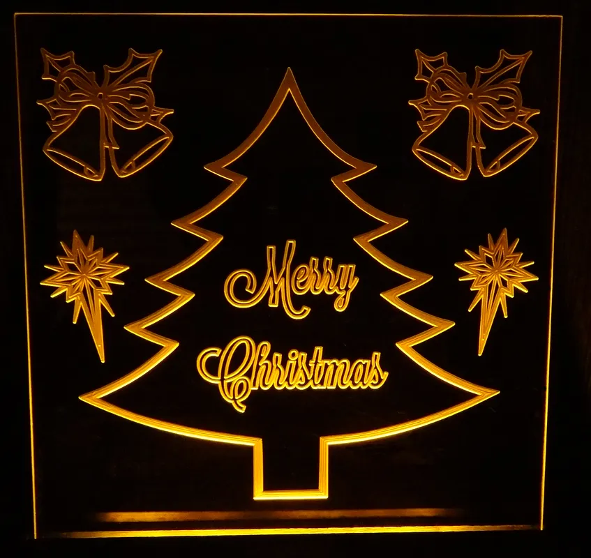

My first edge-lit sign! I'm very pleased with this! It was done entirely in Easel. The text is flipped horizontally as it is engraved on the back side of the acrylic. I probably should have flipped one of the bells to make it more symmetrical but didn't think of that at the time.

Can you give more info on bit size type of bit and feeds and speeds. looks great
Doug, I believe I used a v-bit with a very small point. According to the specs in the project: Bit: 0.5mm; 0.2mm depth; Feed rate: 1500mm/min; Plunge rate: 228.6mm/min; Depth per pass: 0.5mm. Hope this helps!
