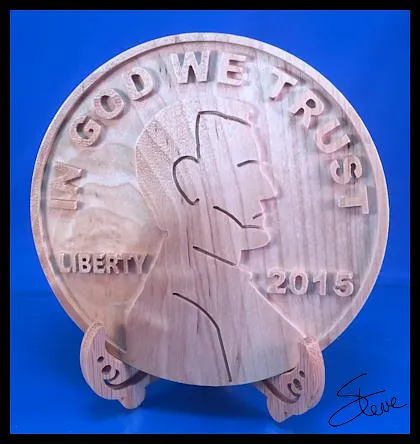

This penny carving is cut in .25" maple. The blank is 7" X 7". It is a two pass carving with a 1/16" end mill rough pass and a 1/32" end mill detail pass. The detail pass will miss a couple very small areas but the final carving looks fine.
