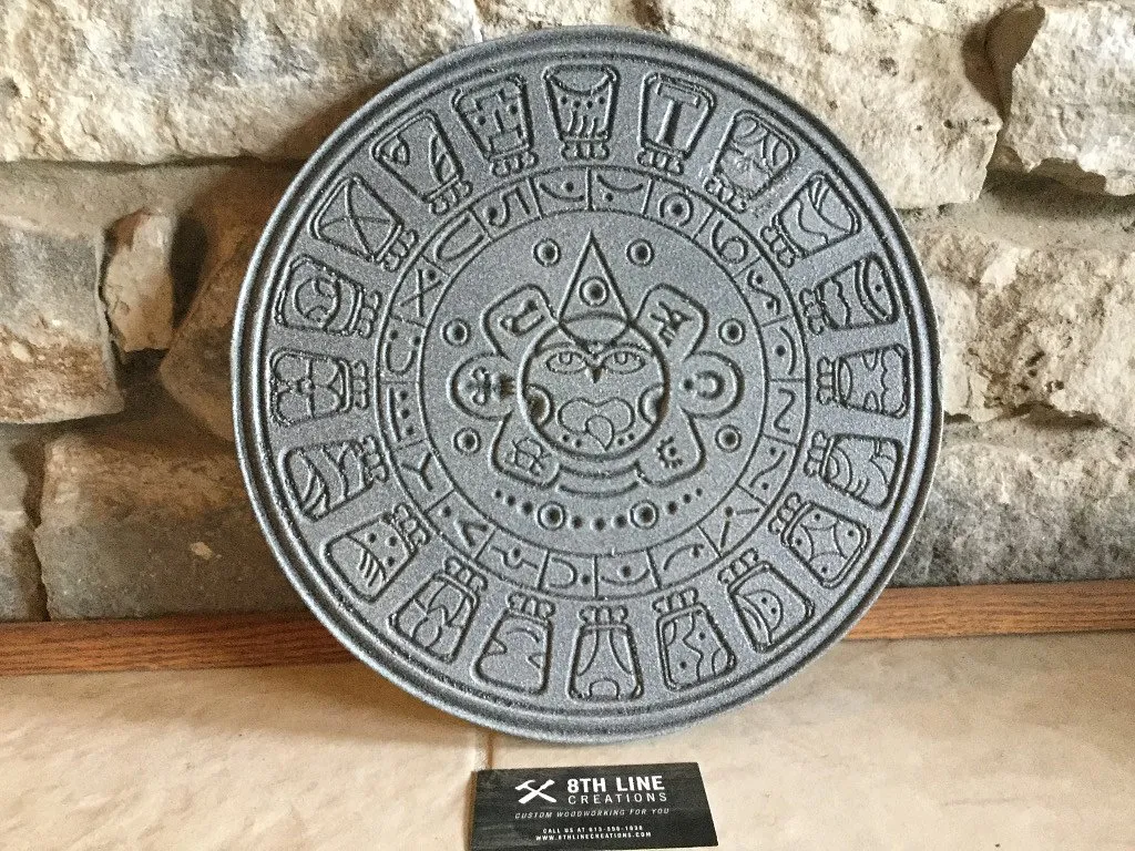

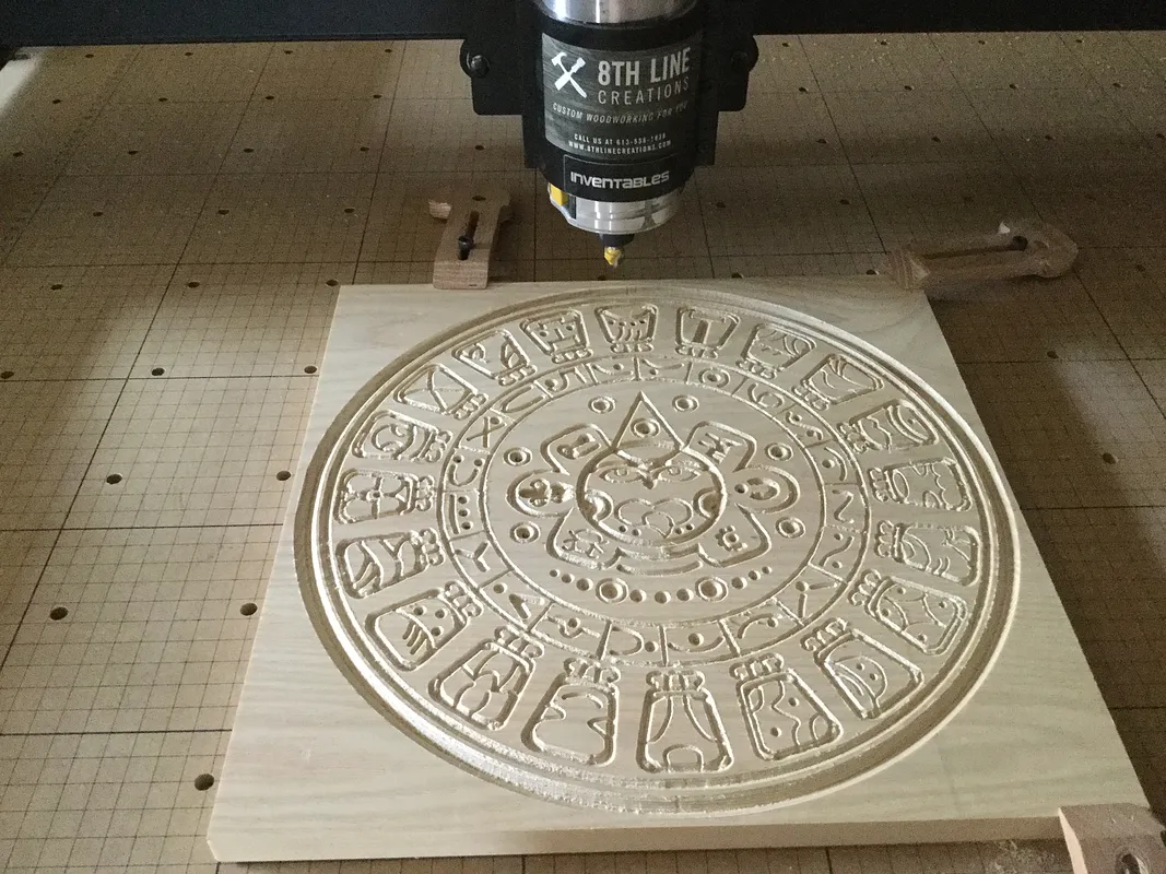

We sell a straight bit version of this on our Etsy shop, so we thought we would give it a shot with a vbit, cut out the circle with a band saw and then painted it with rock paint.
Way faster cutting the sign with a vbit and a much nicer look!
x-carve 2016
MDF

Mine suffers from the vbit not touching the board in all spots. I cant understand why. I am very careful about homing and all but it still seems to miss a lot of the detail while carving. Ideas?
Mark D Tetrault · May 01, 2018
There are many reasons why this might happen (material not the same thickness, z-probe out slightly, waste board not level to the z-axis), maybe ask in the forums or you can send a tech support request through Easel. Good luck!
