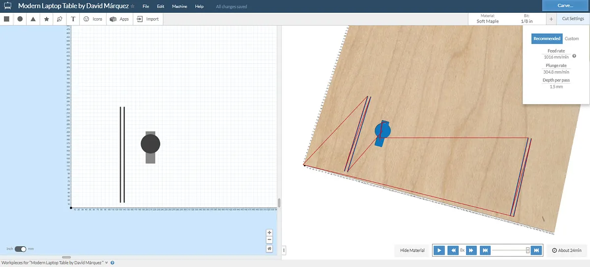

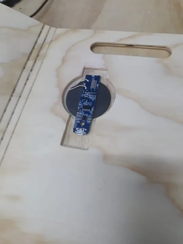

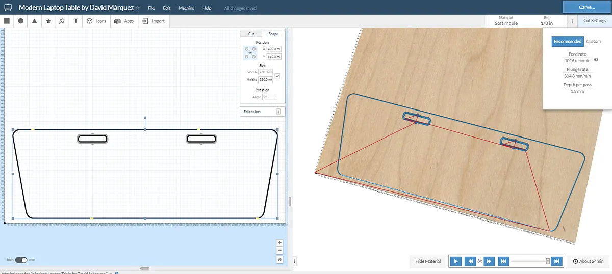

Carve the back part

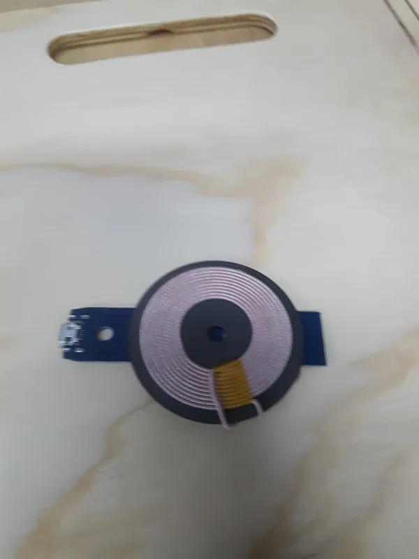

With the first workpiece, you must carve the part where the wireless charger will go and the cuts to bend the wood.
Estimated time: 24 minutes

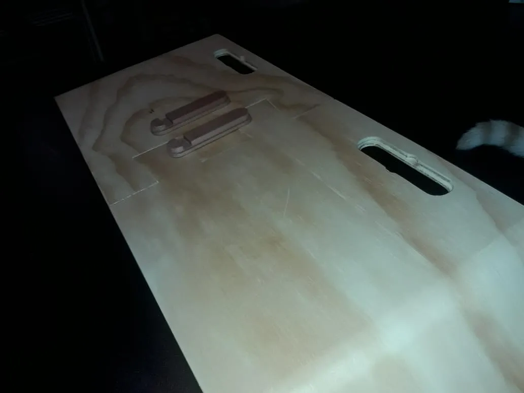

turn the wood and carve
You must turn the wood horizontally and place it in the same position as the previous stage.

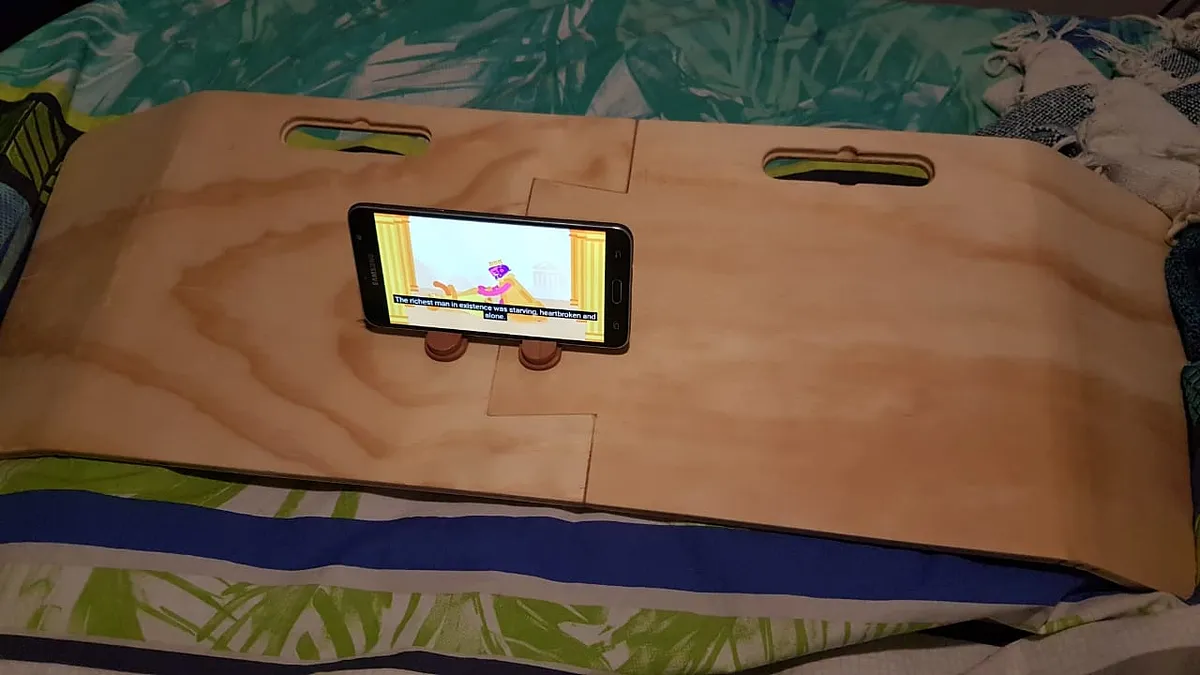

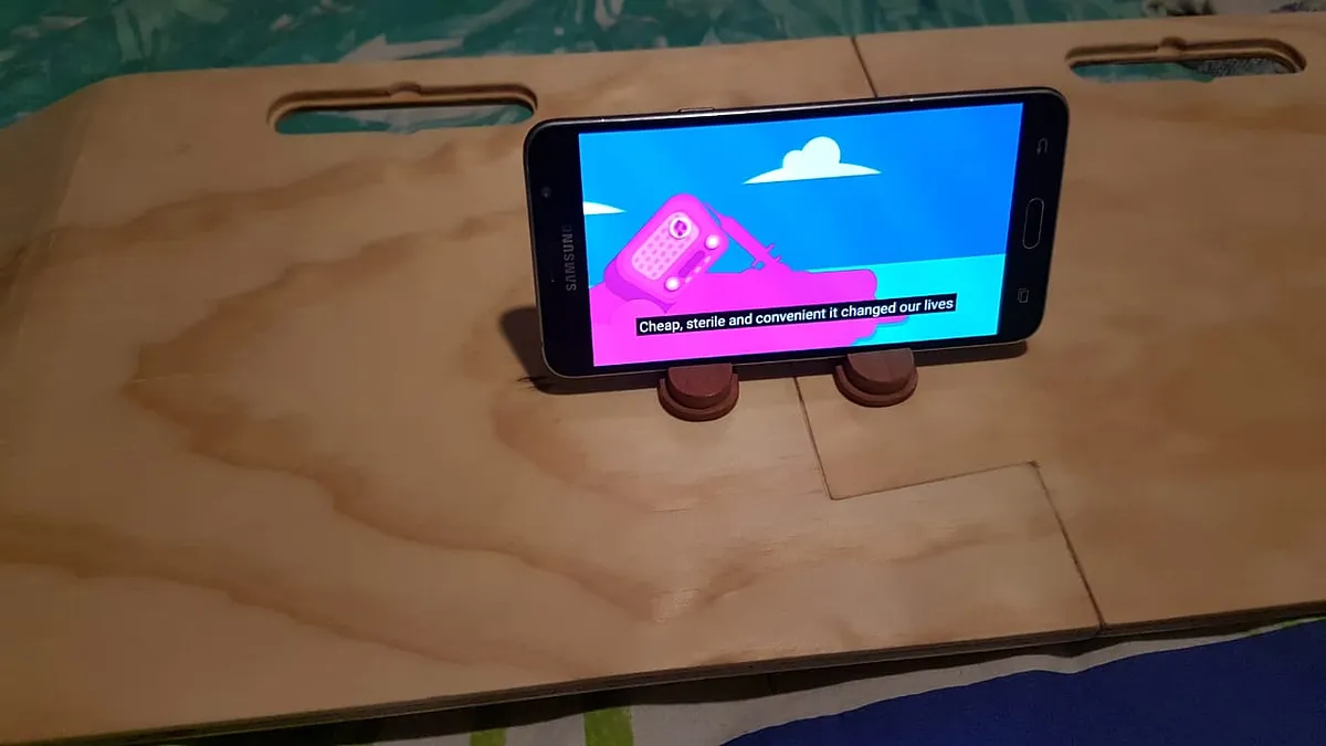

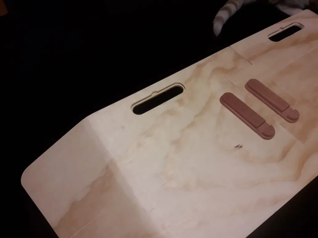

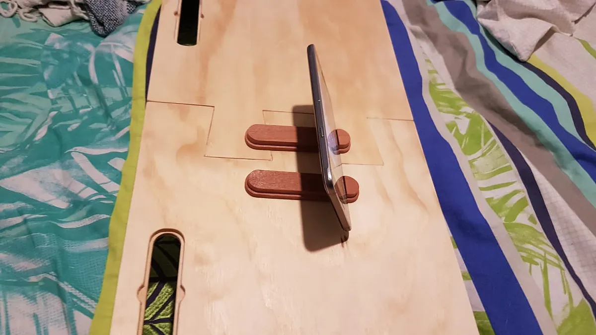

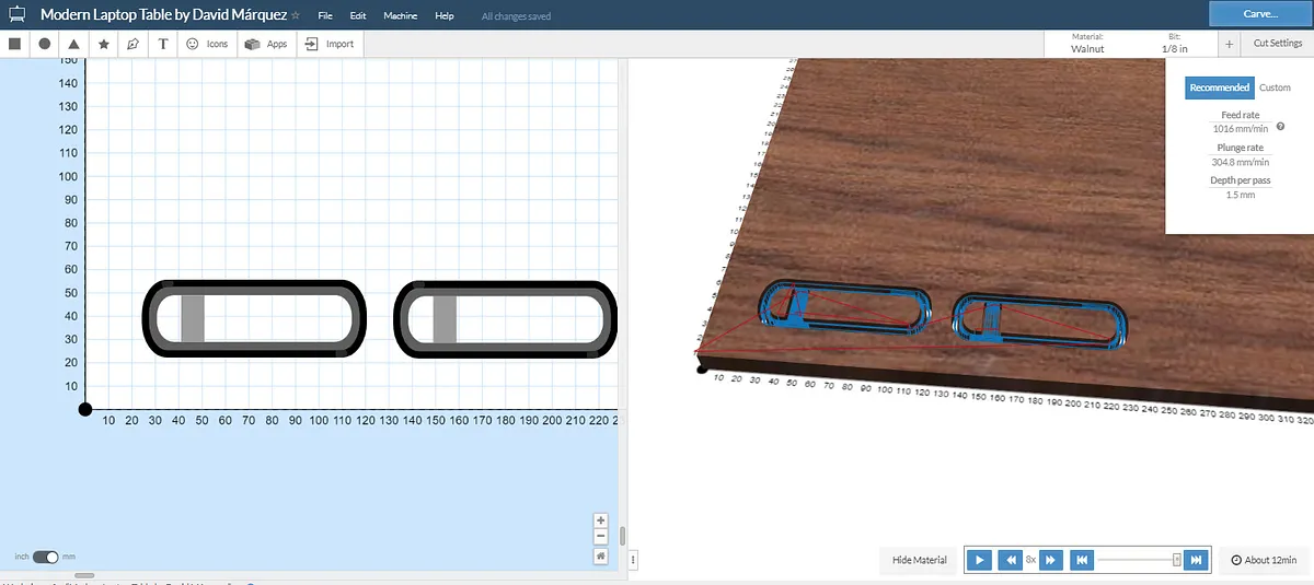

Carve the cellphone holder
Now place the wood you want to use to make the cell holder, ideally it is a different wood than the previous one. And Carve
Estimated time: 12 minutes

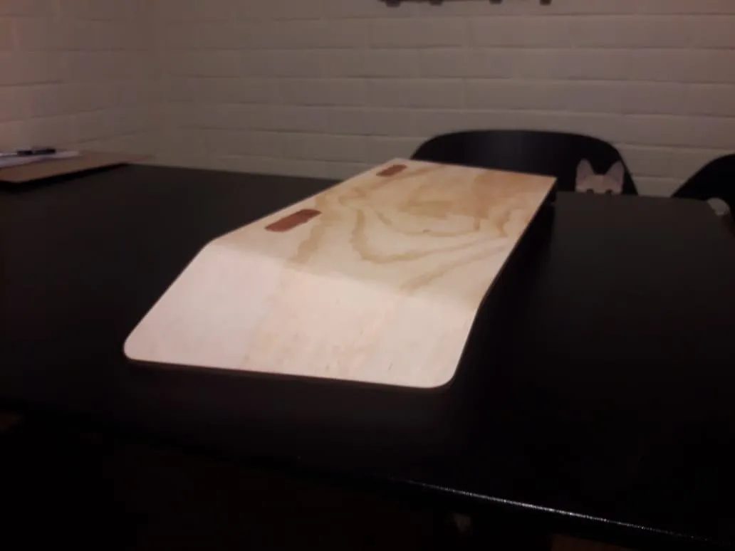

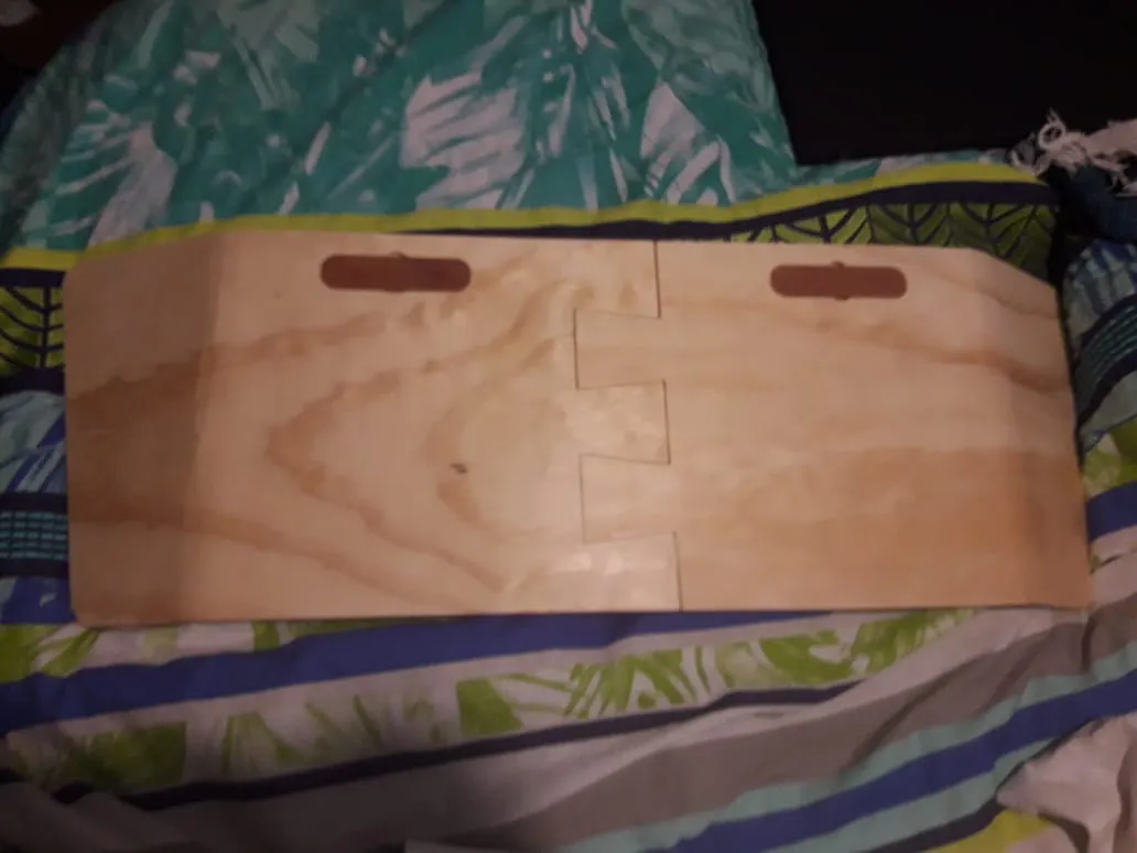

Bend the wood
Now you have to bend the wood, if you can't, add hot water for a few minutes and it will become soft. Then place in the joints glue and hold it for a while so that it is stuck.
Estimated time: 20 minutes
